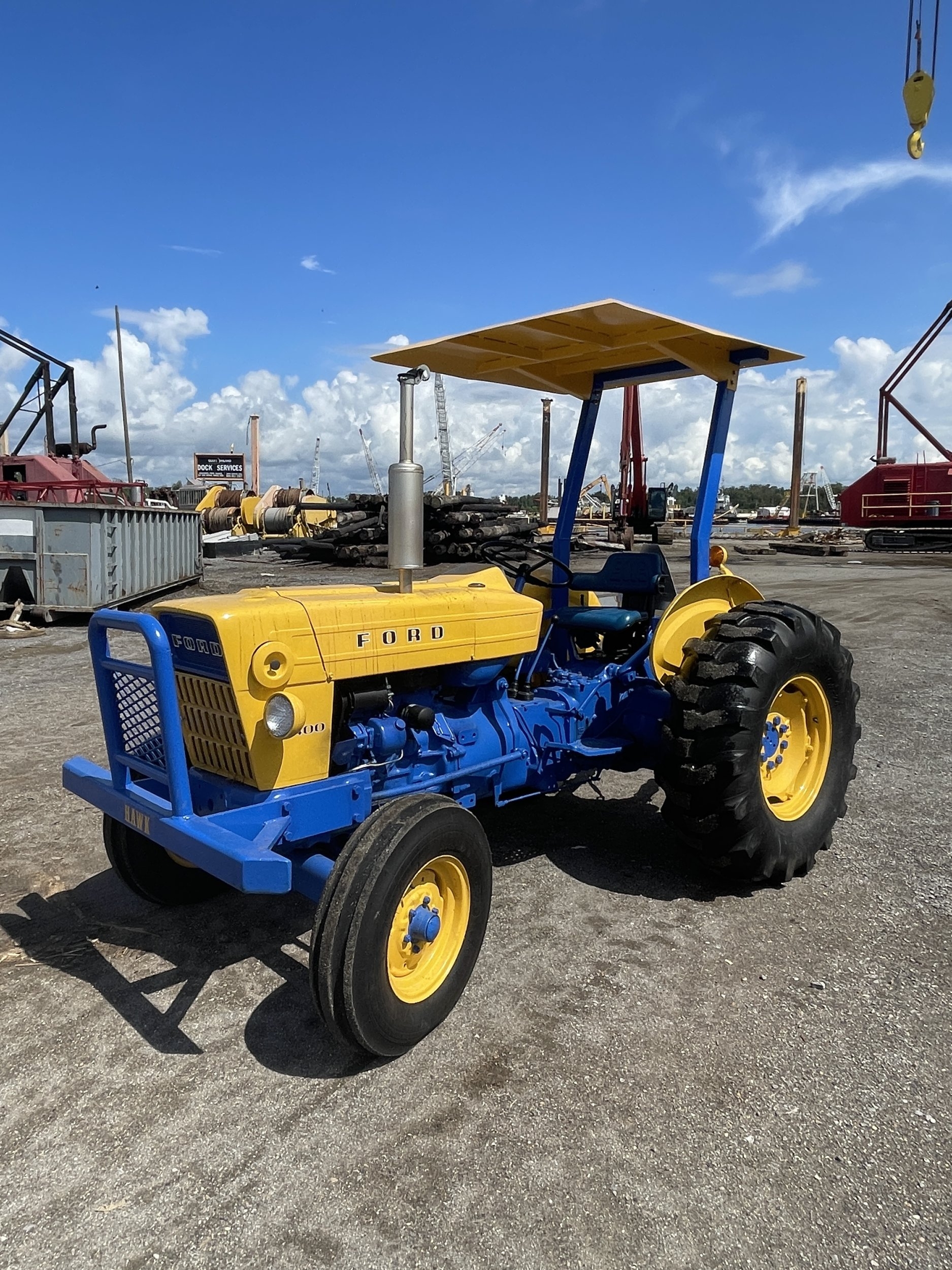

Does anyone know if its posible to install a hydraulic remote on a 4400. Asking cause everything i see is a 4 bolt mounting set up. When the actual lift cover block off plate is a 5 bolt system. Last thing i would like to get done due to having it as a usable Tractor.
D4014C
OH18B
*C281244*
1970 4400

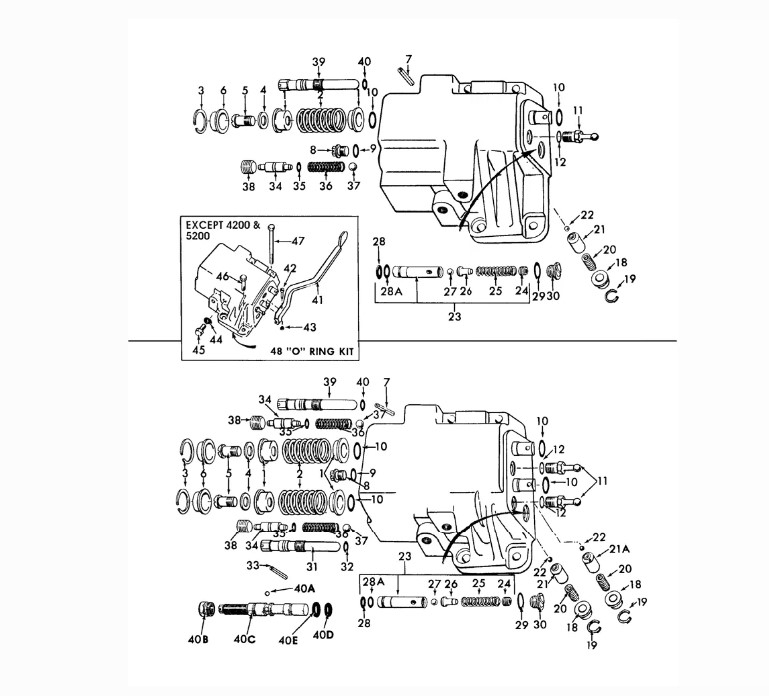

According to the parts catalogs, it takes the same hydraulic valve as all of the thousand series tractors. OEM part numbers: 83944762, D7NNB950B, E2NNB950CA
   / Ford 4400 Double Hydraulic Remote Info Needed #4
Beautiful tractor!!!!
It is a four bolt setup for the original Ford valve(s) and some of the aftermarket ones. One here used:
Gannon/McGee valve used five bolts. One here with four valves, but most were two or three valves:
Myer Ward in California as mentioned, Alexander Tractor in Texas, Abilene Machine in Kansas and many other salvage yards would have used valves to keep it original.
