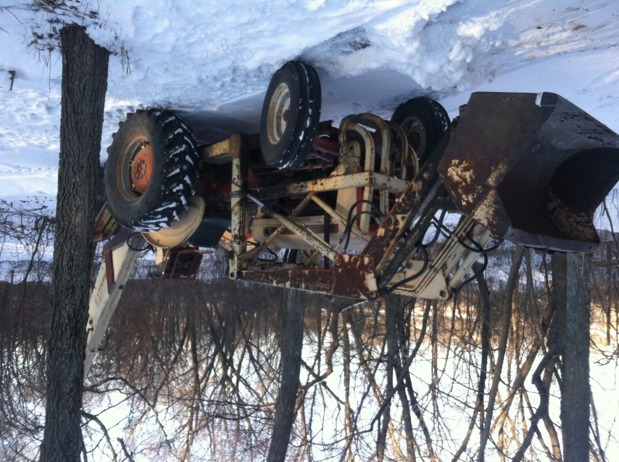

Here is a pic of tractor. Think it's early to mid 60's industrial unit..?
/ Ford 4000 backhoe pin diameter?
Sorry, Don't know how that got upside down...

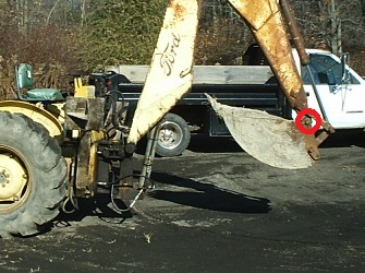

95% sure it's the pin circled in red. I was measuring 11.5" across but need extra for washer and cotter pin...
I think this is a 723 backhoe?

You'll need a line boring set up to fix the boom and bucket holes. If you're fully equipped, you can make one pretty easily, but it's going to take some time in the machine shop.
https://www.youtube.com/watch?v=_J9ak3wKtPQ
Original pin diameter isn't overly important in this case. You can set the pin whatever size you want after either sleeving or welding the worn bores.

Yeah um... I just spent $4200 on the whole machine and it's not going to get enough use to warrant a $400+ trip to the machine shop. I wanted the original pin diameter so that hopefully it would tighten up everything for the amount I will be using it. If I wanted to throw money at it, I would have probably bought a new bucket and sleeved the backhoe arm. I could probably sleeve it myself without line boring it, and that would give me a smooth bore to run a new pin in. But, for it's purposes and the 20hrs of use I may put on the backhoe; it's not worth the machine shop bill to fix correctly.

I looked at Messicks and if it is a Sherman hoe, it is listed as
1-1/4" x 11-5/8", Bucket to Dipstick & Link
199353
