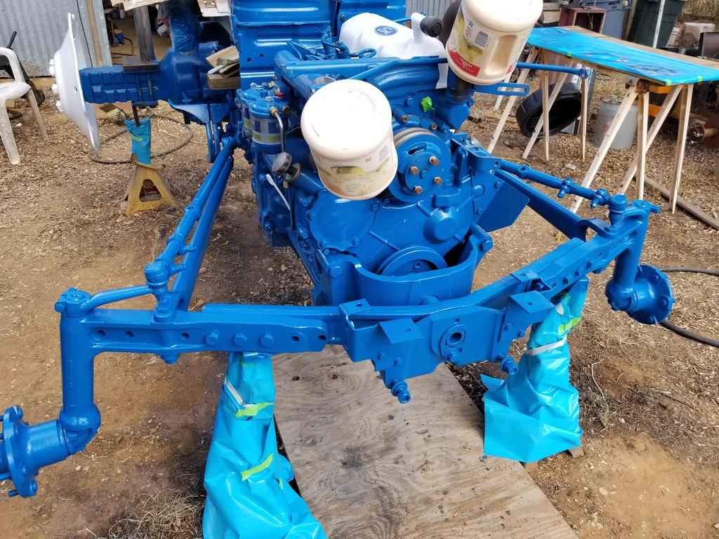

No clue but I can't lift them even with just air fill. I can roll them though. I use my engine hoist to remove/install the rear tires. Mine are leaning against a tree as we speak. I'm in the process of a complete makeover on my 3910. Other projects keep getting in the way but body and paint work is all that's left.
