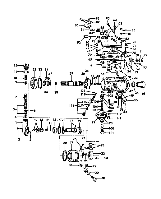

It's that end, but the head is ahead of the primer. The primer is at the very back.
#1 is the cover, 14 the vanes. Also, inlet filter in that cover, but not likely the problem.
   / Ford 3910....no fuel at injectors. Please help! #22
<img src="http://www.tractorbynet.com/forums/attachment.php?attachmentid=376402"/>
There is the pump and the tag with the numbers. Can I try just taking loose the four small bolts there to the left and see what's going on?
That's it.

Can I take the end cap off while the pump is still on the tractor? Will all the guts spill out or will it be fairly manageable?

The more I think about it, the fuel shut off shaft may be rotated. Before I took the cover off, I worked it back and forth with a wrench a few times to make sure it was free. Once I took the top cover off the fuel shutoff valve may of been stuck, I don't know for sure but I worked it back and forth several times to make sure it was free. So if my fuel shutoff valve is now operating correctly, but the shutoff shaft is not exactly where it should be, so once I put the top cover back on, I may be inadvertently turning the fuel back off by the shaft not being in the full forward position. That might make sense. I have a hard time believing my injection pump went completely out all of a sudden on a machine with relatively low hours, well maintained, and not a single symptom before.
You don't have a lot of room with it on the tractor, but yes, it can be taken off. The 'guts' are just the vanes and oring, so no. Clean the area around and above the pump very well. The vanes are fragile.
   / Ford 3910....no fuel at injectors. Please help! #30
The more I think about it, the fuel shut off shaft may be rotated. Before I took the cover off, I worked it back and forth with a wrench a few times to make sure it was free. Once I took the top cover off the fuel shutoff valve may of been stuck, I don't know for sure but I worked it back and forth several times to make sure it was free. So if my fuel shutoff valve is now operating correctly, but the shutoff shaft is not exactly where it should be, so once I put the top cover back on, I may be inadvertently turning the fuel back off by the shaft not being in the full forward position. That might make since. I have a hard time believing my injection pump went completely out all of a sudden on a machine with relatively low hours, well maintained, and not a single symptom before.
Brutixx, What is your source for pumps?
The fuel valve scenario makes the most sense for a sudden problem. Did you take the lever off of the shaft on top of the pump at any point to see whether it is aligned?
Once you took the cover off, then yes, there is a chance that you didn't get the shaft nib lined up with shutoff link, but unlikely that was the original problem.
The one thing that can cause sudden pump failure, at which point it needs to be replaced, is a shocking of a warm/hot pump with cold water while washing the tractor. Then there is nothing you can do but replace or rebuild.
