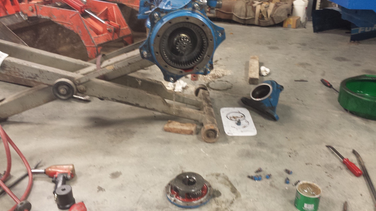

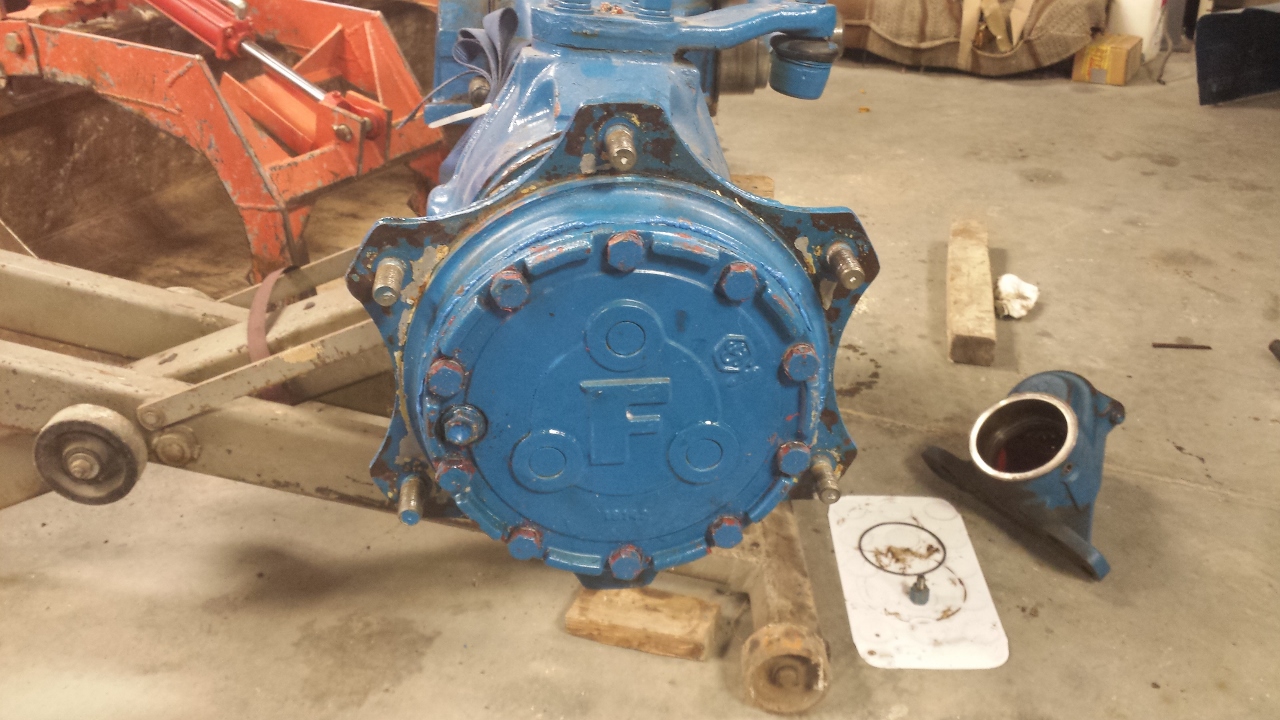

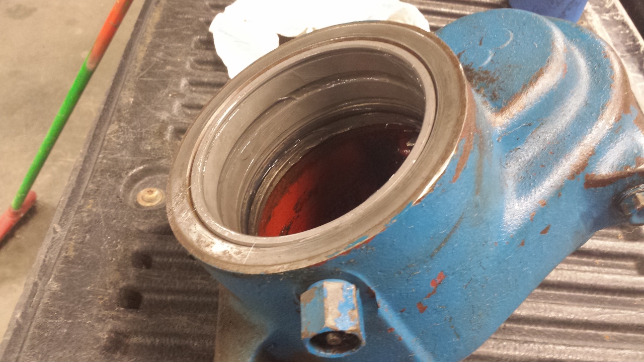

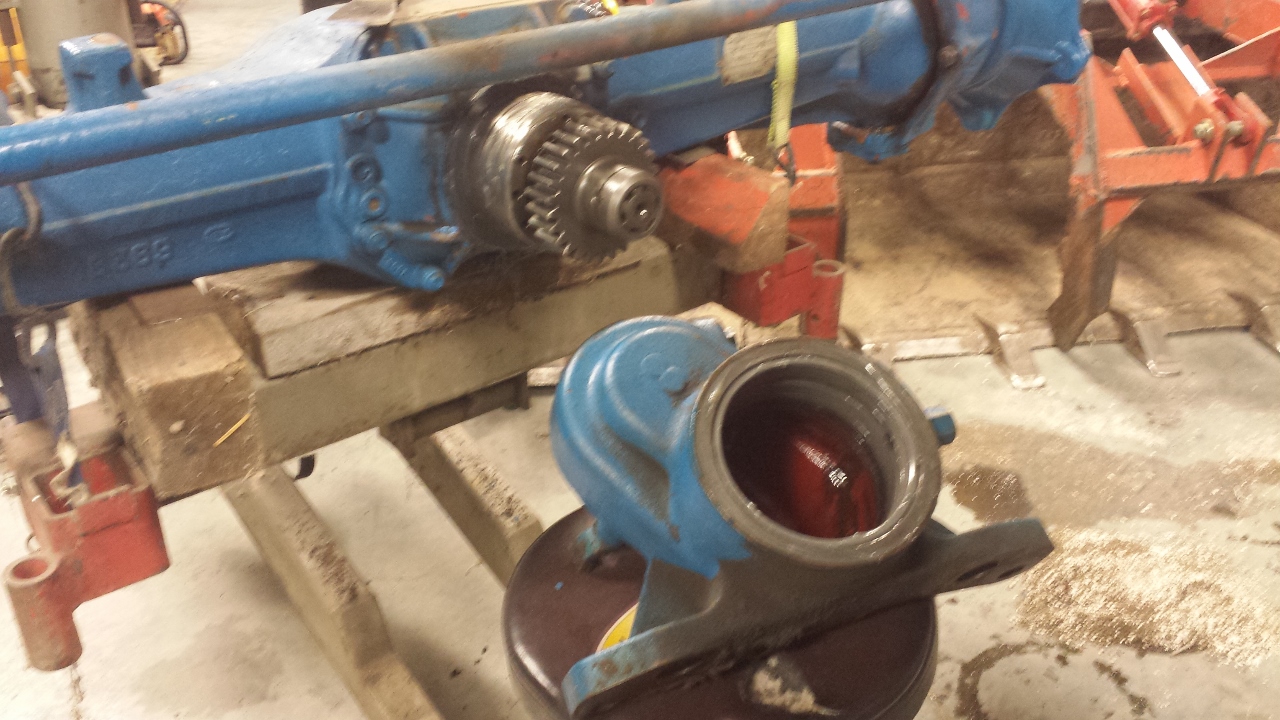

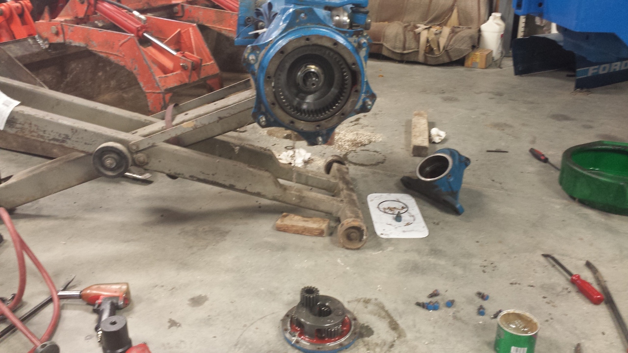

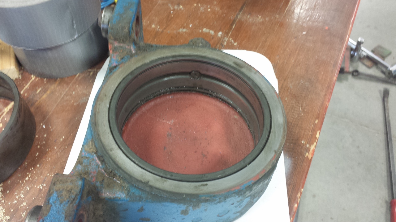

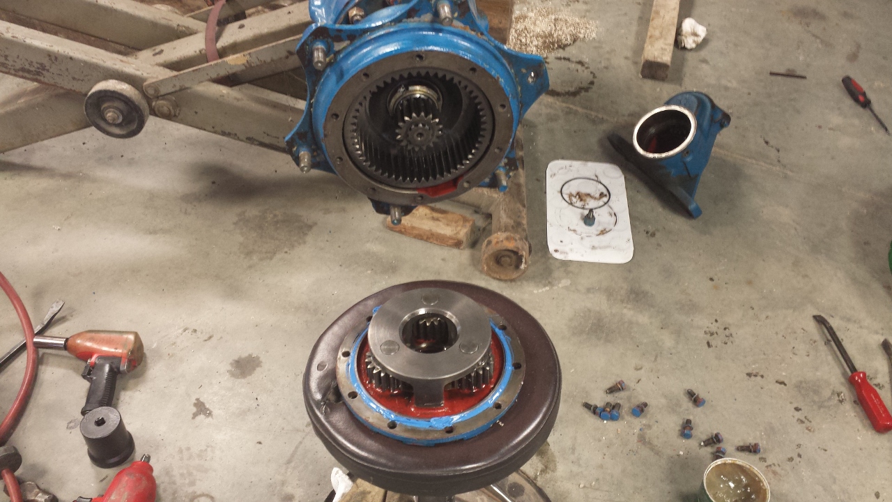

In chasing the oil leaks at the knuckles. I thought it was probably the oil seals in the end of the housing which would seal around the axle shaft as it enters the housing. After some inspection I discovered the leaks are actually the seal in the outer hub assembly that seals the outer axle shaft as it enters the hub. Glad I caught that before I removed the hub assembly and axle shafts.....
The seals are a double seal affair. According to online pricing they are $12 a piece which ain't bad. At least compared to all the other part comparisons.

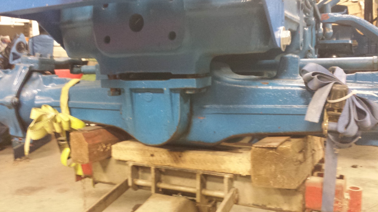

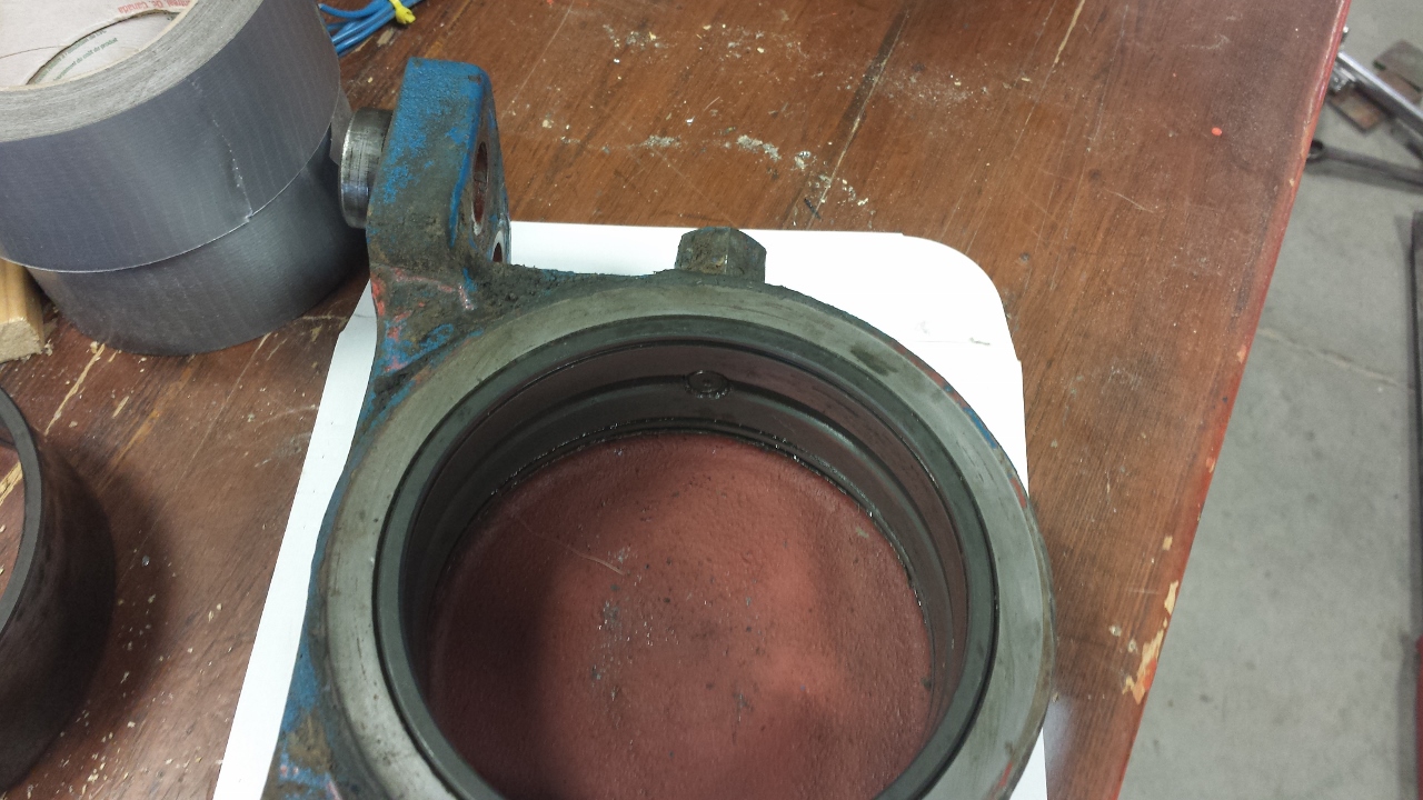

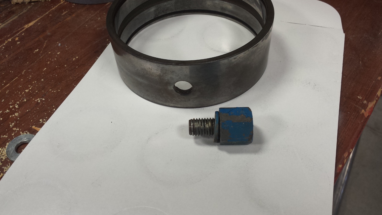

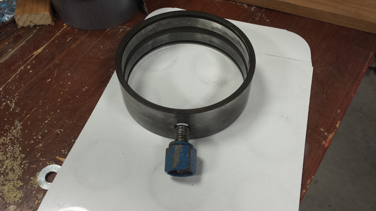

Update. Got the front axle rebuilt and reinstalled. I'll try to post some of the steps.

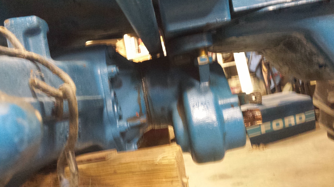

First, here's the axle oscillator. These pics are of the front one. Note the bushing has a hole in it. The grease zerk adapter threads into the cast bracket and inserts into the hole in the bushing. This is what holds it from spinning in the casting. I inserted the zerk adapter to hold the bushing in place until the axle was installed. Then had to remove the adapter to access one of the bolts. Same with the rear casting.
20150125_110019_1 (1280x720) (1280x720).jpg20150125_110132 (1280x720) (1280x720).jpg
Here's the rear oscillation casting. If you look closely you can see the O-ring that seals the entire front axle assembly. Kinda cheesy.

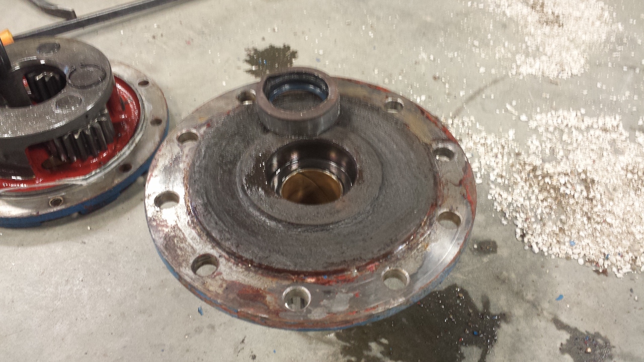

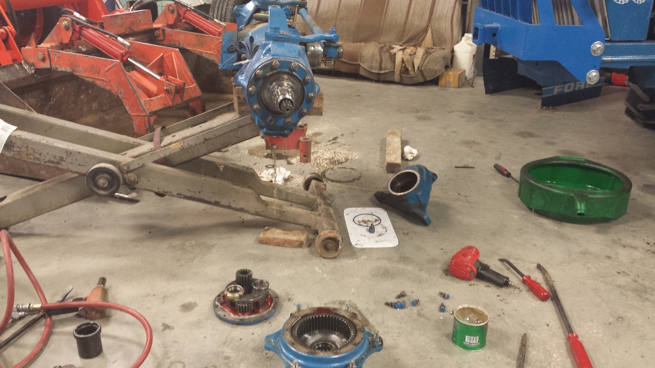

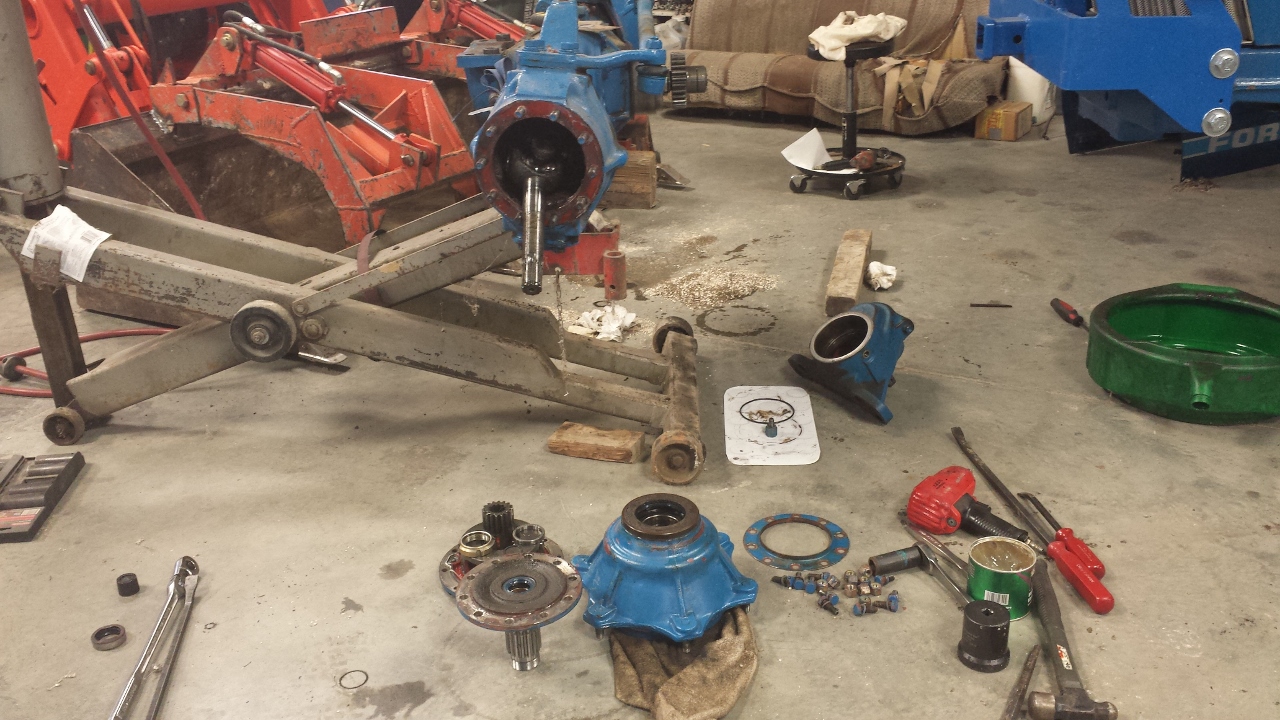

Now we'll assemble the outer hubs. This is where my axle oil leaks were. Remember I said I thought it was the inner axle seals and it turned out to be the axle seal within the hub assembly. I think I posted a picture of that before.
Anyway, install the new seal in the spindle and install it. Don't forget to add the debris shield before adding the nuts and tightening. If you do you'll hafta go back and repeat several steps to put in the shield that you forgot. Don't ask.

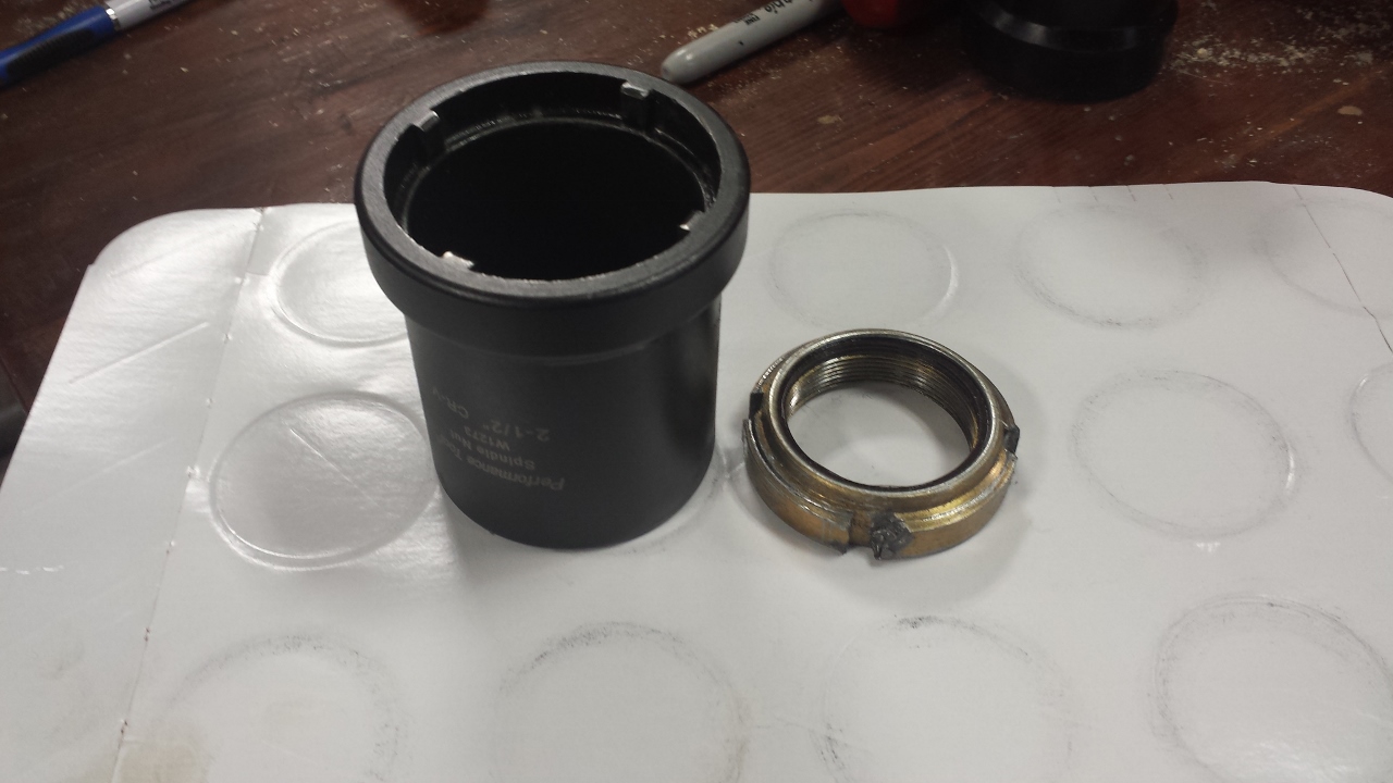

Once you've installed the spindle you can install the main hub assembly. It has the main bearings and the "Sun Gear" hub in it. You hafta gently drive it on because of the bearings fitting tightly on the spindle. What holds it in place is a spindle nut. You MUST have a spindle nut socket to handle this task. I tried to remove the nut with a punch and hammer. The results are obvious. $20 for a socket and problem solved. For this application it's a 2.5" outer socket.

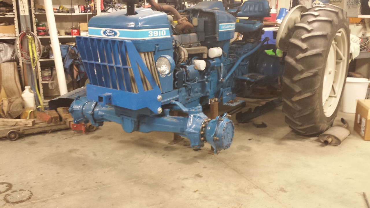

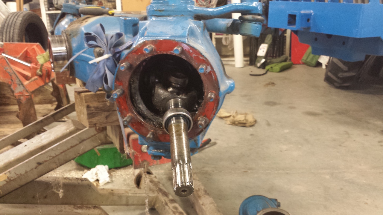

Reinstalling the axle assembly was a piece of cake. I suggest hand starting all 8 bolts that hold the axle in place before tightening any. This will allow some wiggle room if needed. Don't forget to fill all gear boxes with fluid and grease the snot outta the oscillators.
