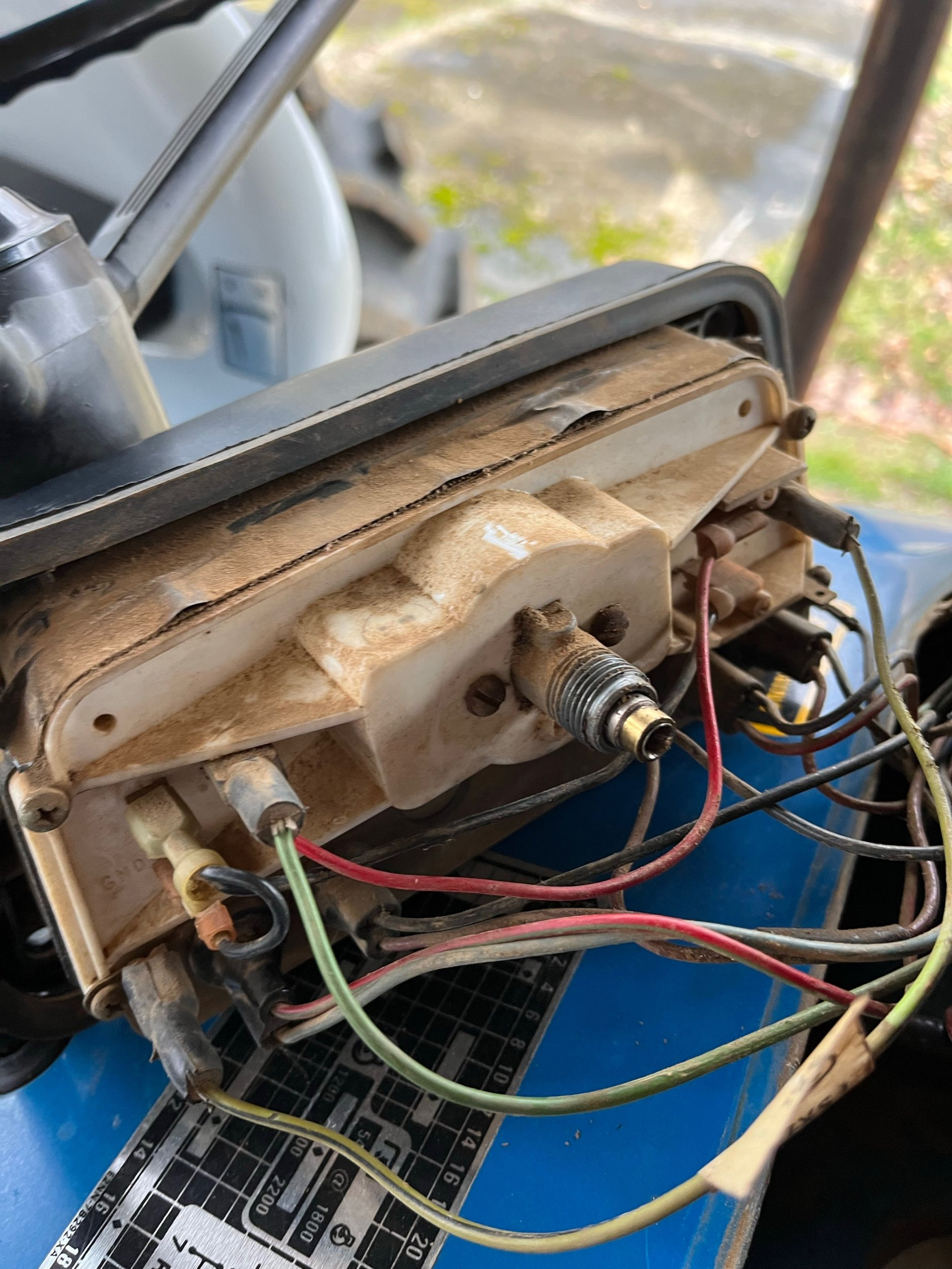

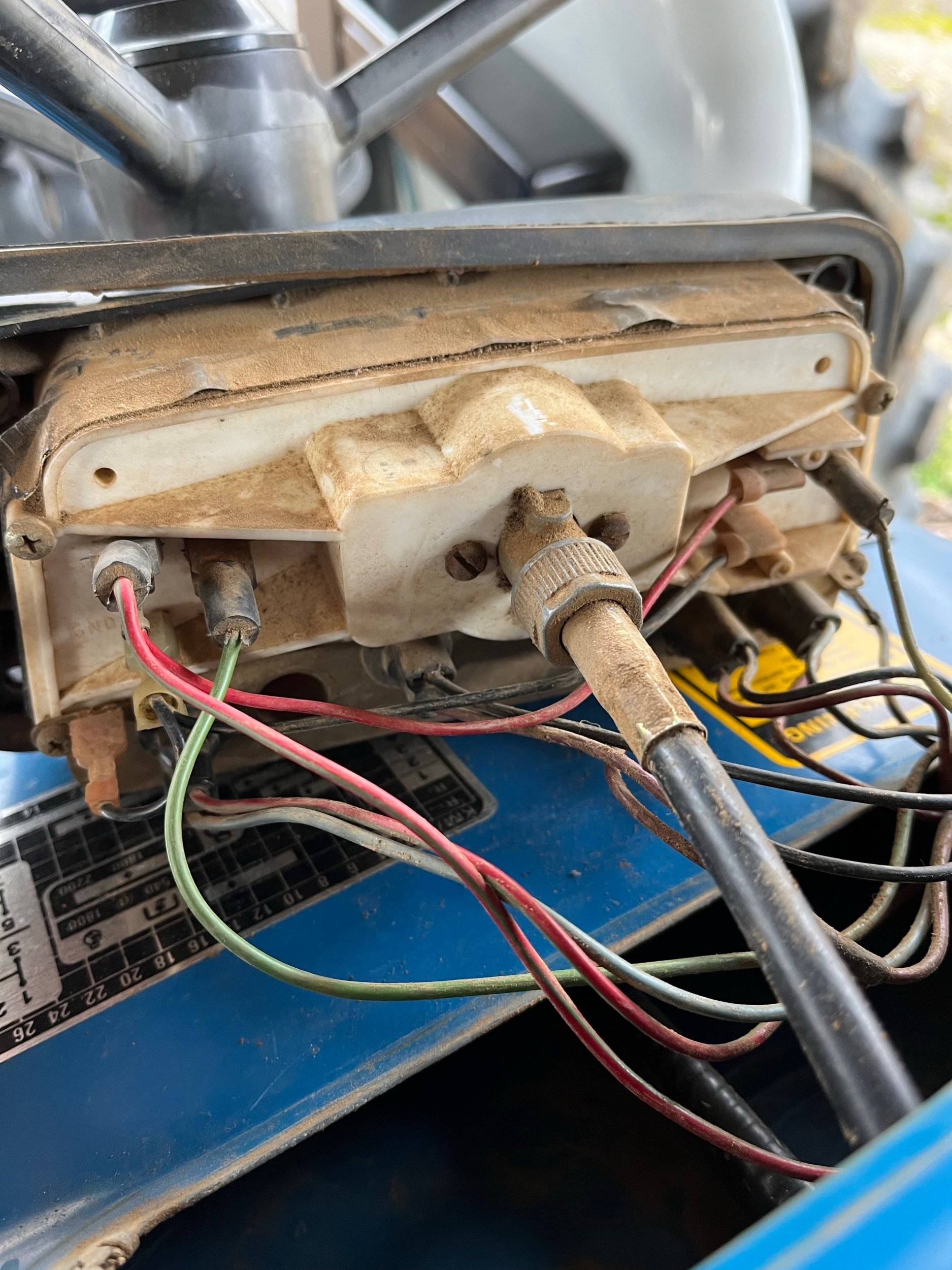

This is the back of my cluster
/ Ford 3910 engine temp reading #15
The black wire is ground. Take a jumper to the battery - and see if anything changes. With that jumper on, ground out the temp sender wire and see if anything happens.
#16
Well finally figured it out. So I had a friend of mine clean out the fuel tank last month. It has developed all kinds of Rust and crap from the fuel becoming too old in the tank. I didn’t realize he had removed the tank and when he did he disconnected the tach cluster but unfortunately wired it back up incorrectly. The second picture shows how it should be and the second picture shows how he had it. Basically the ground and the positive were backwards. And the coolant temp was connected to fuel sending unit.
Now everything works except the fuel gauge which goes all the way to empty. I think I need to pull it and clean it up good and then will probably work fine.
