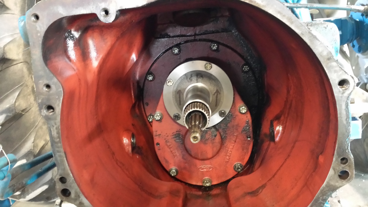

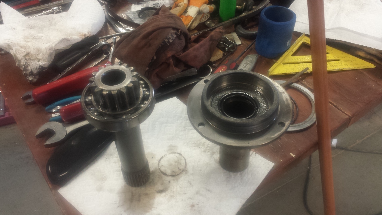

UPDATE.....
I finally got to use the tractor for a couple hours the other day. Parked it in the shop, satisfied with how everything was working. Came out the next morning to find the same type of oil puddle under the clutch housing as before....... :(
So I disassembled again. Good part is I'm a lot faster at it now and had it apart in an hour.
What I found was that the two seals in the front of the transmission were also leaking. Actually, now I'm thinking my rear main seal wasn't leaking at all. The mess was coming from the trans seals. Problem is that leak is spilled into the center of the clutch assembly and gets tossed everywhere. So, as in my case, when the leak has been going on for awhile there's oil on everything inside the clutch housing and you can't pinpoint where it originates from.
When looking at the transmission shafts you see the inner, solid, splined shaft which is the transmission input shaft. You also see the larger, hollow, splined shaft which is the Independent PTO shaft which the trans shaft extends thru. This larger shaft extends thru the throwout bearing horn. The throwout bearing horn is bolted to the front of the transmission with 4 bolts and sealed with a gasket.
I think the smallest seal which seals the trans input shaft was the culprit. But, not wanting to do this again, I removed the throwout bearing horn and disassembled it to replace both seals. To get the horn off you must unhook the clutch pedal shaft from the throwout bearing assembly. This is done by removing a bolt/nut that clamps the throwout bearing "finger assembly" to the shaft. Once that bolt is out you can rotate the fingers on the shaft which allows you to pull the bearing assembly off the horn. Now you can slide the pedal shaft out of the clutch housing and set all that aside. Then remove the 4 bolts and the horn easily comes off. Be careful to not destroy the gasket. It's not glued on either side so it's easy to remove. Once you have the horn assembly removed a couple taps with a small hammer and the two parts come apart. If you look at the flange end of the horn you can see the seal which seals the PTO shaft. If you look into the splined end of that assembly you can see the smaller seal that seals the transmission input shaft. Both are easy to remove and replace.

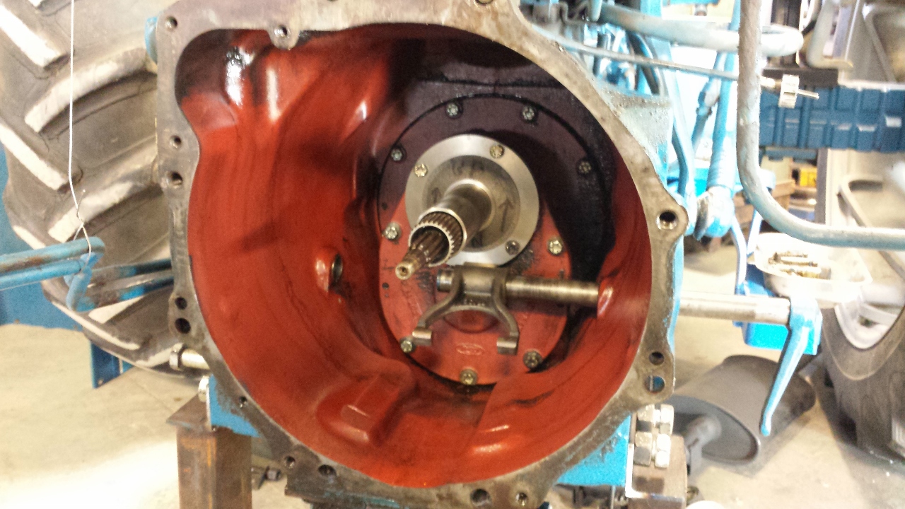

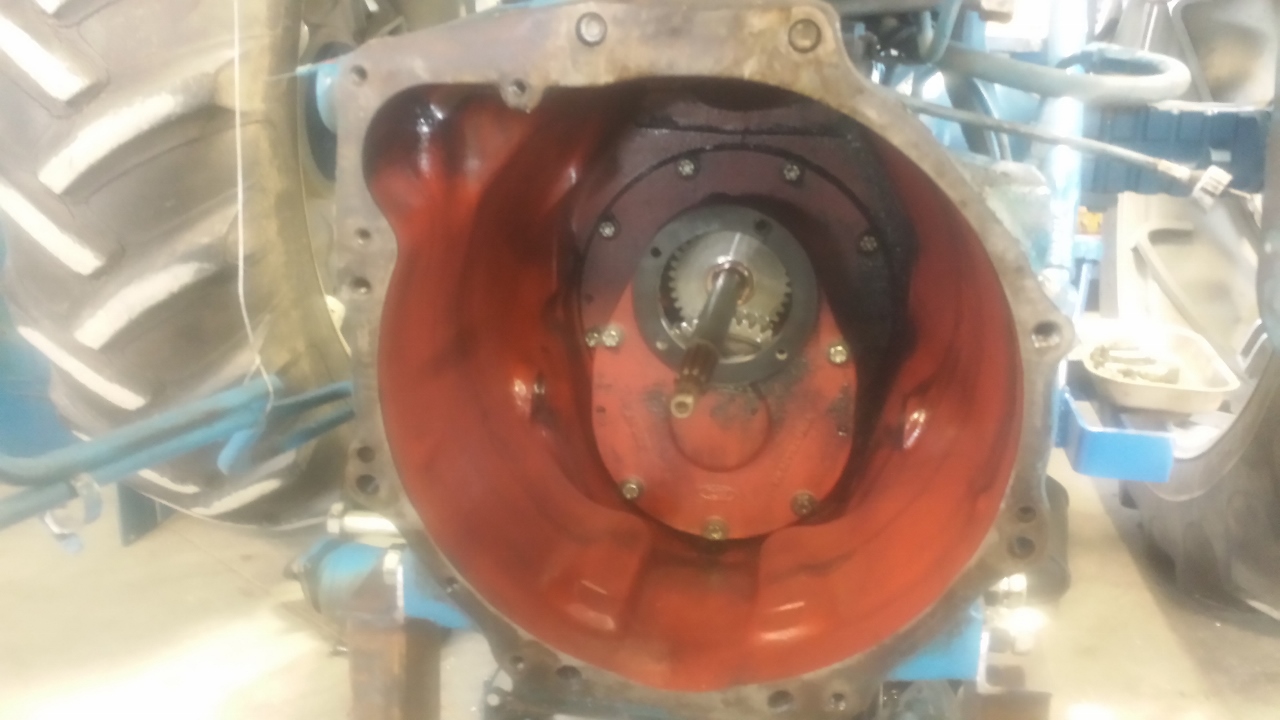

The horn assembly has a weep hole in it to allow any oil the gets into the cavity between the two shaft to escape back into the transmission. I was very concerned about reattaching the horn with that hole down!!! So I marked the horn with arrows and the words "up" and "down" with a marker. When I reassembled I realized Ford had dummied this down for me. The bolt holes are unevenly spaced and it will only bolt on with that hole down!!! Cool!!! :)

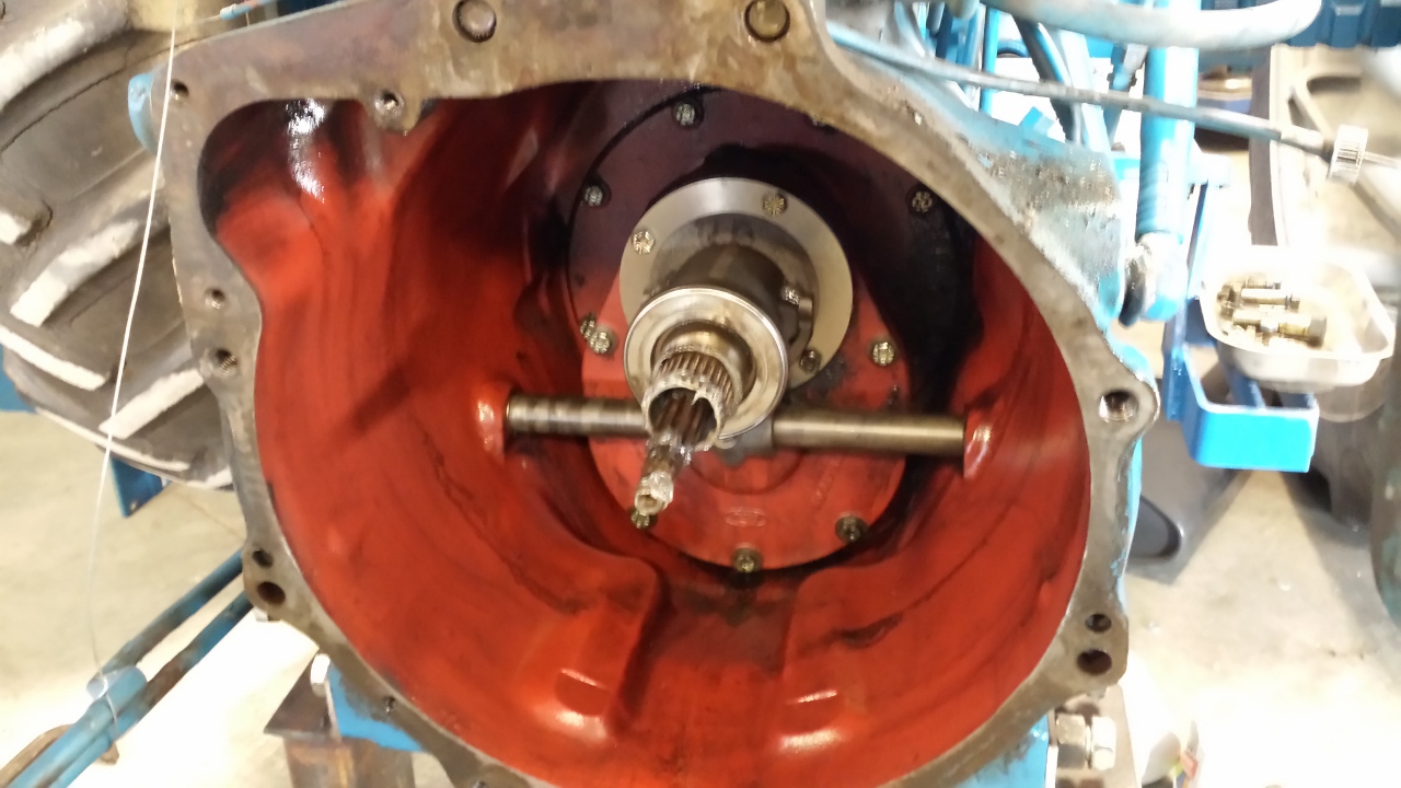

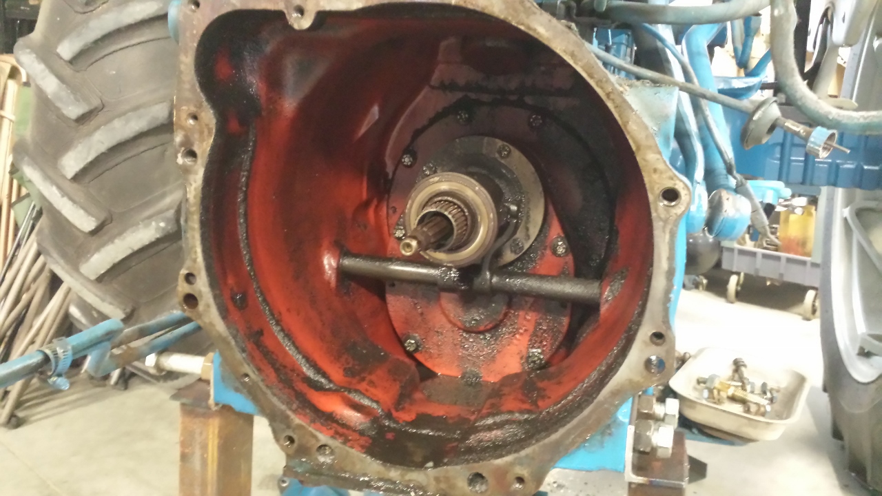

Once you've reattached the horn with the four bolts you can reassemble the throwout bearing and clutch pedal shaft.
Replacing these two seals takes about 30 minutes. Cost is $18.50 for both seals.
When you do your clutch, do the seals, even if they aren't leaking. I was SO stupid to not do that the first time. I let the tractor run at full throttle for 90 minutes yesterday with no leaks. FINALLY...... When I do something stupid like this I wonder how I even know enough to dress myself in the mornings. :(
