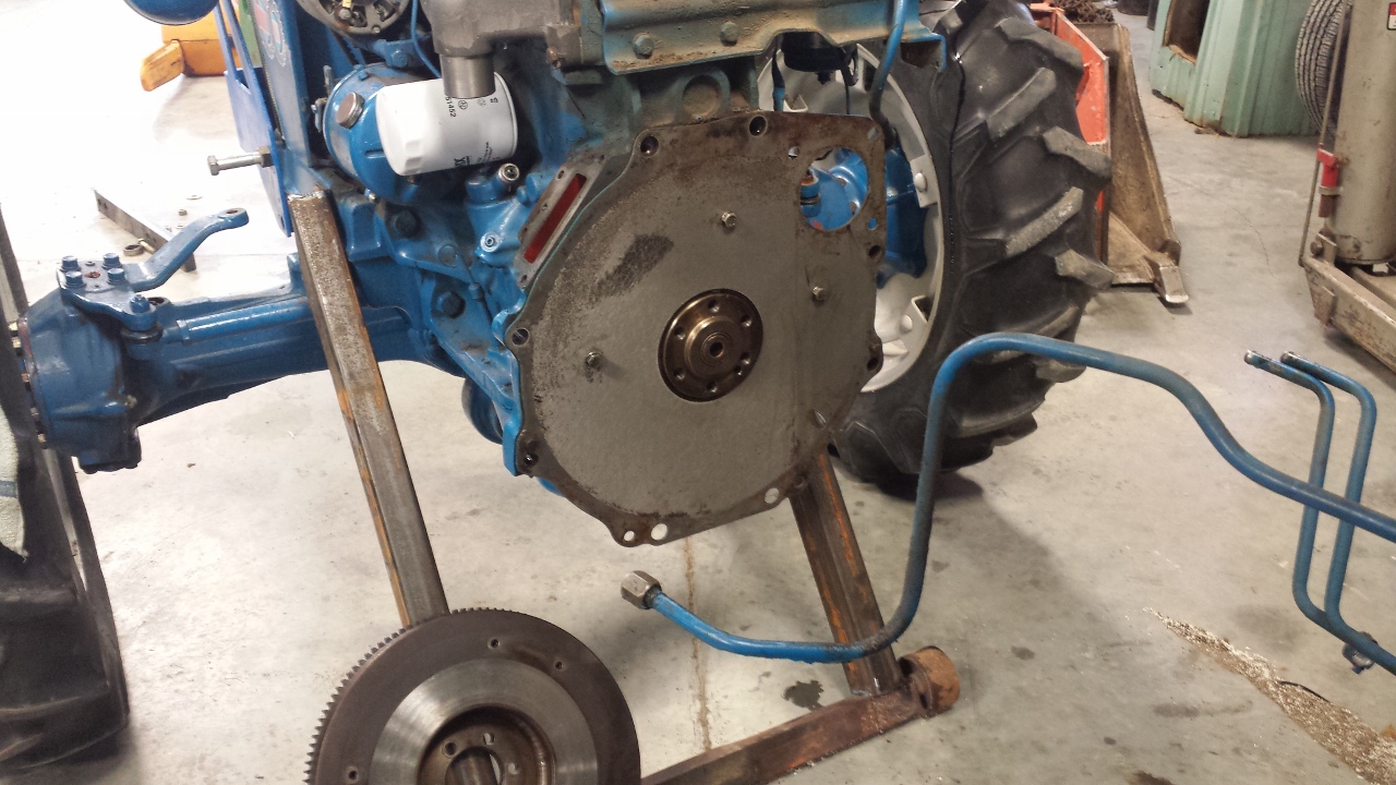

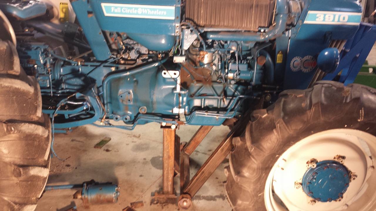

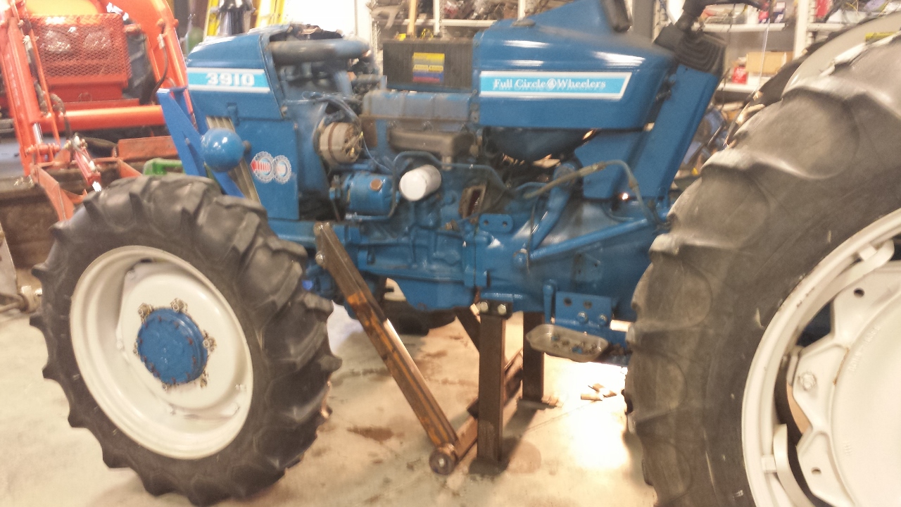

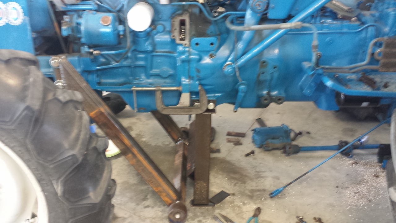

Bought this tractor a couple months ago. Noticed it had a rear main seal leak, along with several others. After I got the front axle rebuilt and back under it I decided I'd tackle the rear main seal. I built a stand on wheels to fasten to the front half of the tractor. Already had the rear half on a fixed stand. After 4 hours of unhooking everything I got it apart. I hung 2 weights on the front to take some weight off the stand. Now realize that was unnecessary.

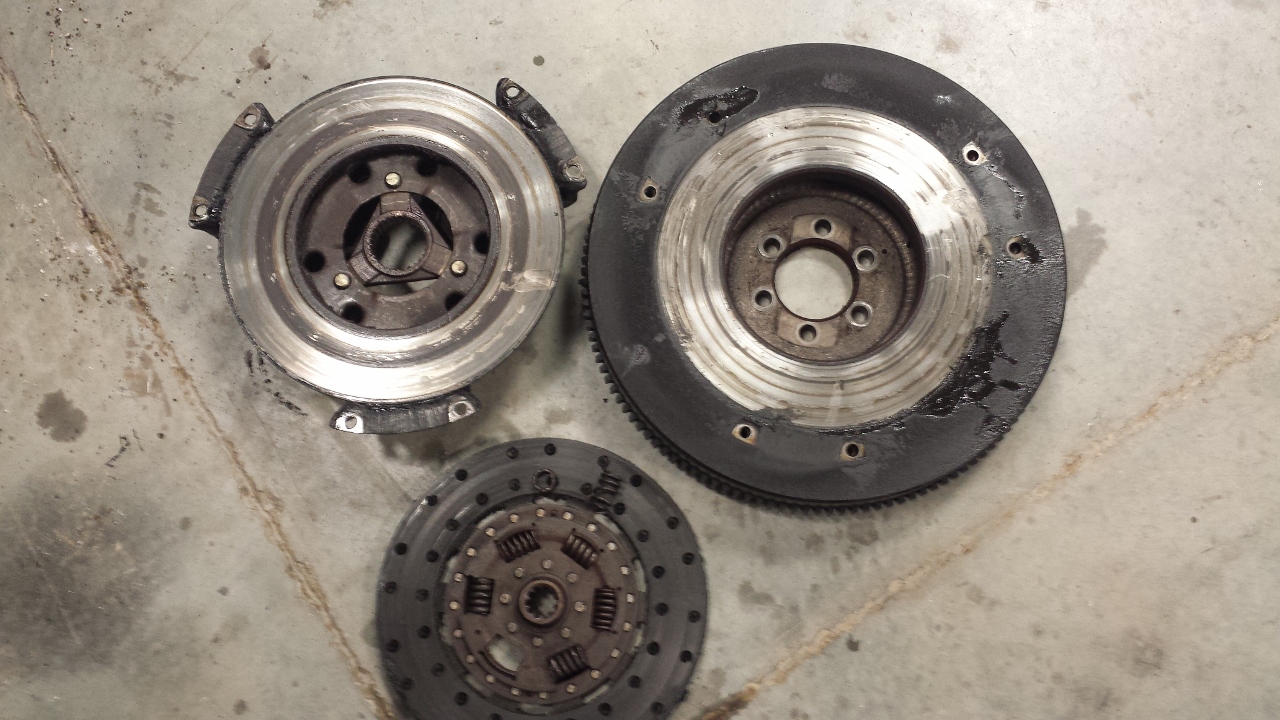

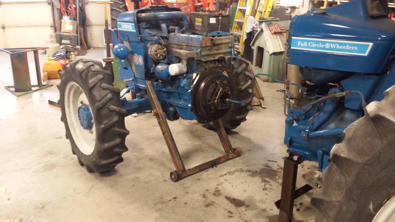

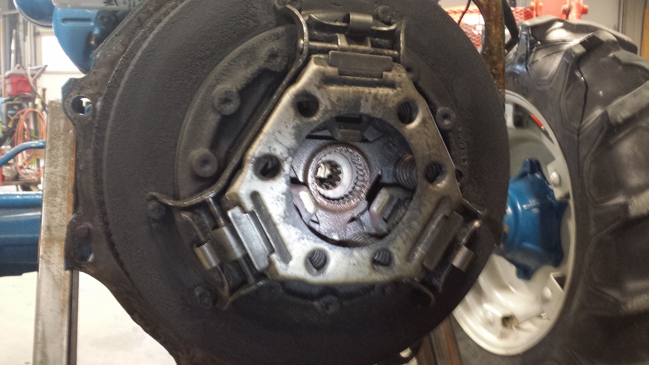

The rear main seal had obviously been leaking a long time. The clutch was totally oil soaked and one spring in the clutch disc was broken. So project changed from seal replacement to clutch replacement.
Getting the tractor apart wasn't really difficult. As I said, it took me about 4 hours. My 43 yr old mechanic Son would have done it in an hour. These tractors are designed and intended to be used for a very long time. They are built to take apart. Also being a 30 year old tractor it's not limited by cosmetics and current technology. Wiring is pretty straight forward as is the fuel system. All oil systems affected were easy to separate. And only had to remove one piece of sheetmetal, the hood.
As you can see my clutch was toast.

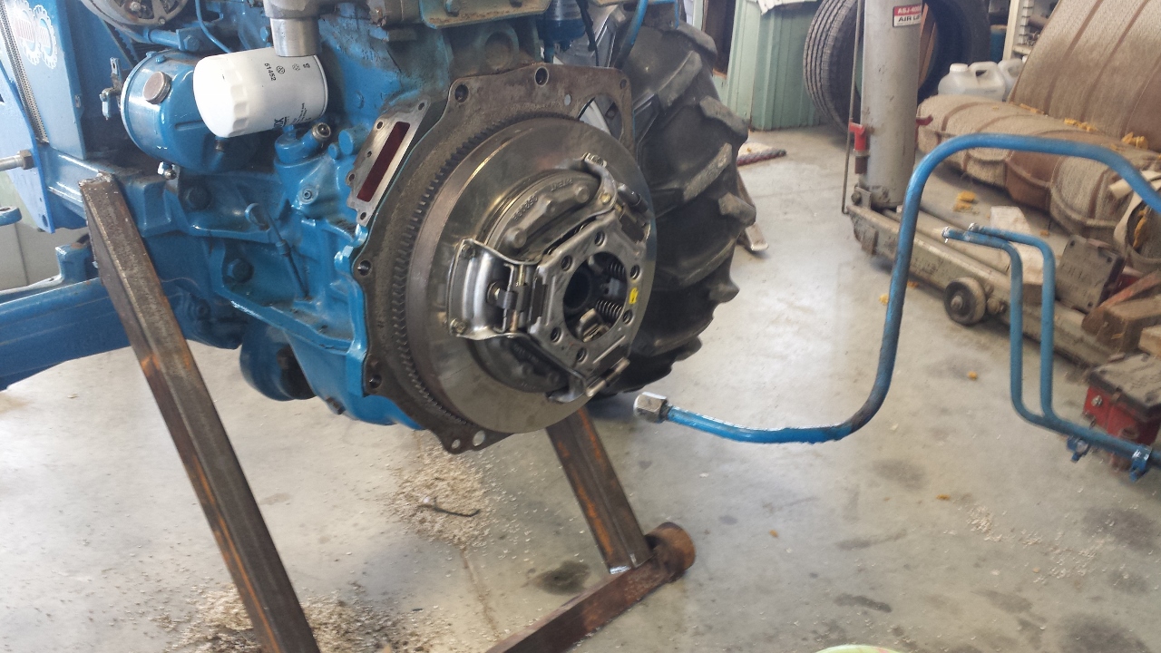

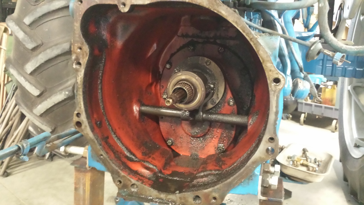

If you've never saw a Ford clutch system on a tractor with "independent" PTO, look closely at the closeup lighted picture of the clutch assembly before I removed it. You can see the disc splines, back in the center hole. Then if you look closely you can see another larger splined hole that is part of the pressure plate. When the engine is started the pressure plate turns with the flywheel, regardless of what position you have the clutch pedal in. This provides constant and unbroken rotation of that larger splined hole. The smaller splined hole in the clutch disc only turns when the clutch is engaged. Push the clutch pedal and the disc stops turning. This provides the ability to stop/start the tractor's motion.
If you look at the picture showing the transmission housing you can see the PTO gear box on the front of the transmission. You can also see a splined, hollow shaft that fits the larger splined hole in the pressure plate. Coming out of that hollow shaft is the smaller splined shaft that is the transmission main shaft. So, engine running, clutch engaged, both splined shafts will be turned at engine speed. Disengage the clutch and the smaller, transmission shaft stops turning which stops tractor movement. Meanwhile the larger hollow shaft continues to turn which provides uninterrupted service to the PTO oil clutch located in the rear end housing. Thus "Independent PTO". Confused yet.

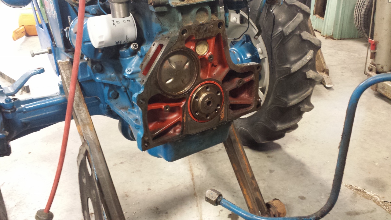

After removing the pressure plate/clutch disc from the flywheel I removed the flywheel and the shield that covers the rear main seal. Removed old seal, installed new seal. Both very easy tasks. Then took the flywheel to a machine shop and had it "turned". This resurfaced the flywheel getting rid of the oil saturated surface as well as removing any distortion. Makes for a very smooth new clutch operation.
While apart I also replaced the pilot bearing. sorry I didn't get a picture of that. It's a small bearing that goes into the end of the crankshaft. The pilot shaft on the end of the transmission shaft goes into the center of the bearing. It's purpose is to hold the transmission shaft in line with the engine crankshaft so there's no shaft wobble and/or clutch disc wobble under load.
Then I installed the new clutch assembly and was ready to put the tractor back together.

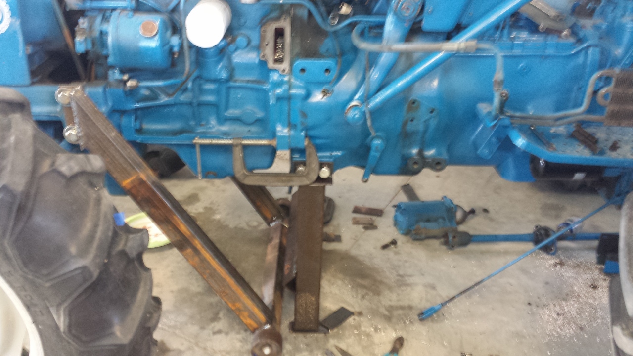

Sorry I didn't get many pics of putting the tractor back together. But it was very uneventful. My wheeled stand on the front half worked great. When I had the two pieces close enough together I put a C clamp on each side and gently used them to help me pull it all together.
Understand you have a lot going on when putting it back together. The pilot shaft end of the transmission shaft has to go into the pilot bearing. The splines on the transmission shaft have to mesh with the splines in the clutch disc. The splines on the pressure plate for the PTO have to mesh with the splines on the PTO shaft coming out of the transmission. The dowels, one on each side of the transmission housing have to hit the dowel holes in the engine block.
With that said, DO NOT use excessive force pulling it all together. Damage can be done to the clutch assembly or transmission shafts, or pilot bearing. I snugged up the C clamps and then wiggled the front half of the tractor as well as turning the flywheel with a screwdriver. Tightening a lit at a time as it slid together. Piece of cake.....
