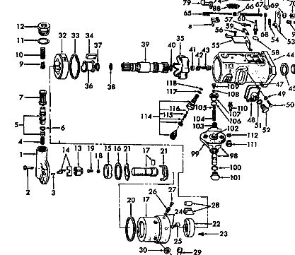

Have you checked filter(parts key #7) in inj pump? Is the fitting in inj pump that return line attaches UNPLUGGED?

Filter was plugged. Cleaned and reinstalled. Too late now (dark here), but will try tomorrow to start. Thank you.
