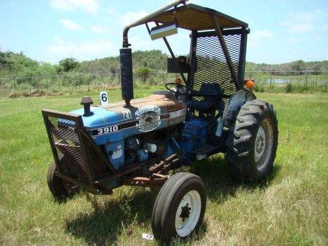

Diesel is an acquired taste. :D One is not born with it. I noticed your exhaust is below your "operator station cover". That could be causing a lot of the smell. Try adding an extension to get the exhaust above that top.
My 3910 is getting a makeover as we speak so don't mind the "Junker Look". This was an old auction picture when I bought it. Look at the exhaust pipe.
