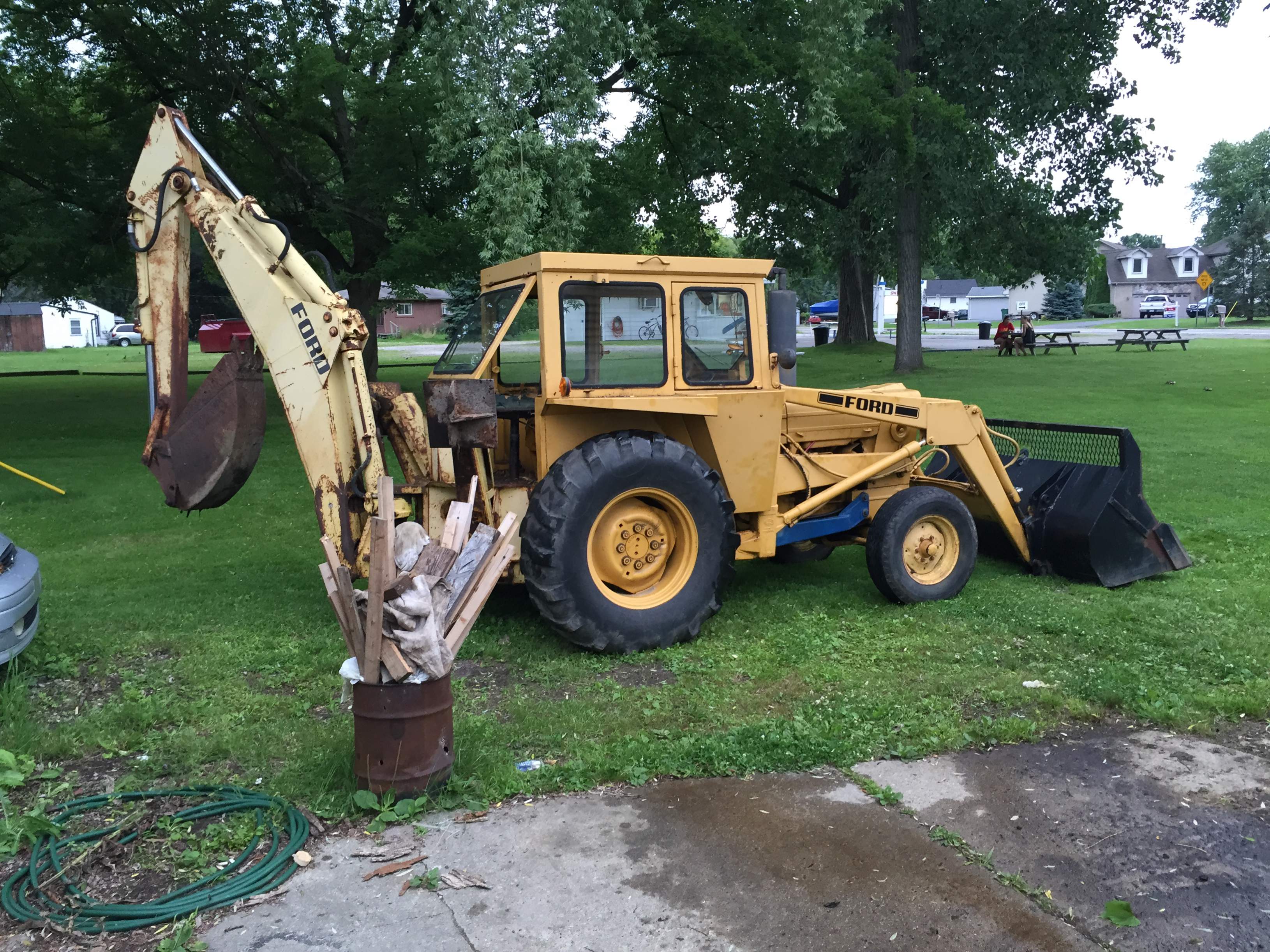

I have a Ford 3400 TLB, and would like to know the weight of the hoe itself.
From Tractordata.com I get a weight for the bare tractor of 3723 lbs.
They also give a weight of 1431 lbs. for the loader, but I cannot find a weight ANYWHERE for the hoe with subframe, and stabilizers.
The hoe is a model 750, which is a 10' Ford hoe with bucket, subframe, and stabilizers.
The hoe is a VERY heavy/solid/sturdy attachment. The 3400 tractor is a 1970 model, and the hoe is 1973. The entire machine has 1840 hours, and is in excellent condition. I have had it for 25 years, and LOVE it!
I guess the hoe weight to be almost 3000 lbs., but I really do not know!

I would guess you're pretty close on weight. I was thinking around 8500 lb. for the whole rig or 2500 for the hoe. I will look at an old sales book tomorrow and see if it shows the 10' backhoe 'option' weight.
/ Ford 3400 TLB total weight ??? #3
I looked in my archives, but did not have the 750 literature. I did have the Dearborn F9 literature which is pretty much the predecessor to the 750-10' and the weight on that as an attachment was 3,000 lb.

Found a Ford factory manual:
750 (10') hoe = 2200#
753 (13') hoe = 2400#
755 (15') hoe = 2600#

I am curious if that weight includes the subframe. The Ford backhoe mounted to hooks on the subframe so that may be the backhoe only as you can detach it and mount an implement on the tractor. Therefore the weight would be the attachment. The subframe system probably adds another 600 lb. Don't know though.

#13
INTERESTING ???
I do NOT know if those weights in the service manual include the subframe.
The picture in the hoe service manual, does NOT show the subframe.
Thus, I would assume that the weights listed probably DO NOT include the weight of the subframe (and that subframe is a heavy bugger).
I will be stopping off at a local Ford tractor dealer in a few days for some stuff, and will see if their lead parts guy can give me an answer.
Jeff is very knowledgeable. If ANYONE can find that answer, he can.

I'd say the sub frame is 400lbs tops. My brother and I were able to carry each side by hand. I installed them on the 4400 by myself.

Thanks City Farmer:
My Ford parts guy thinks that the sub frame weight IS included in the Ford hoe manual published weight, which in the case of my 750 hoe (10') the total weight would be 2200 lbs.
I am not so sure, because that hoe, with bucket, and stabilizers is one beefy hunk of steel.
Even so, if the total is 400 lbs. more (2200 lbs + 400 lb. sub frame) I am still OK with that.
