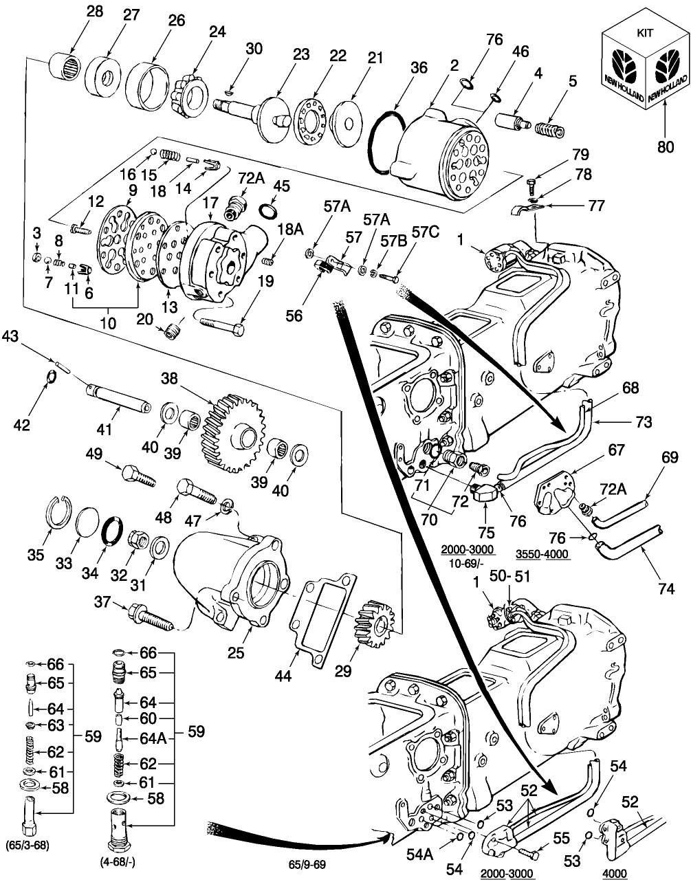

Seals leaking at the rear of pressure and return hydraulic tubes by the brake arms, already have hydraulic pump off and replacing the pressure nut but noticed bad leak at end of tubes. I can't seem to find directions to remove these...any help would be helpful, Thank You for your time---ncmike

Exact connection will depend on tranny type.. here's an exploded diagram pic showing a couple different tubes/trans types and how they mount.

thanks so much Soundguy...I think the tranny is the one on the bottom right in the pic but am away from home and am not 100% sure, will check in a few days...appreciate your expert advise and trying to help a rookie like me, might have to take a photo as JC-jetro

Hi
Do you have the hydraulic schemactics for a 1965 model? It simply wont work and the pump has got pressure, it just seems to circulate as an open circut with no pressure build up.

if it is circulating open circuit then I would say the pump has no pressure, but has flow!
Pressure is the resistance to flow.
Ina nay case, you can pull up all of the exploded parts diagrams for that machine at the NH parts site. I'm at work pulling a 14hr double and my 3000 shop manual is no where near me.
That said.
If you know it is open circuit flowing.. I'd look at the unloader valve and backpressure valve. if the unloader sticks in the 'unload' position.. oil circulates.
if the backpressure dies and does not provide some low psi (40ish ) to the unloader.. the unloader won't operate.

Thank you Ultradog M N , Soundguy & all at Tracktorbynet for the assistance & info.
the problem was (1) unloader valve- "O" ring found to be swollen, Causing seizer of valve
in unload position- hence, open circuit. (2) Previous people working on this tractor damaged
the pressure supply tube to lift cover- this was an obvious fault .
