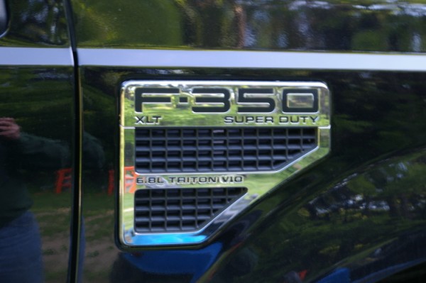

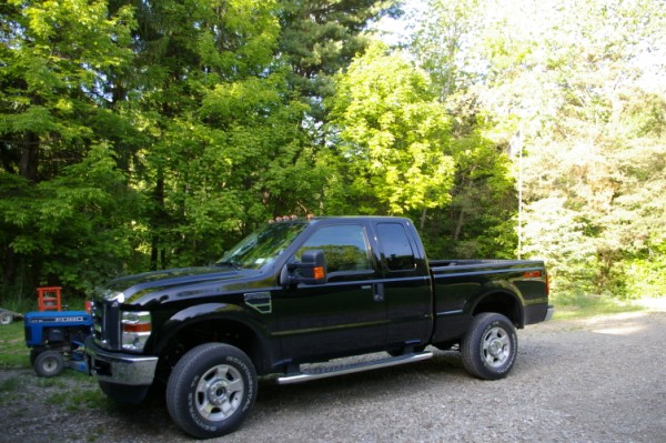

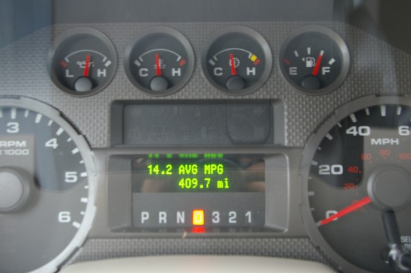

Does anyone on here own a Ford V-10? I just traded my 2005 5.4 in for a new Ford 350 v-10 because I couldn't stand the lack of power in my 250 when I was pulling my trailerand all around driving. I couldn't justify buying a diesel because I only had 25K on my 2005. I have been averaging between 13.2 and 14.4 all around driving unloaded with 4:10 gears with the V-10 and it is brand new and not broken in yet. My 5.4 in my 250 got between 10 and 12.5 unloaded doing the same routes. Maybe the F150's get better mileage due to the aerodynamics but I couldn't take the lack of performance in the F250. I also heard they are having problems with the twin turbo diesels blowing O-Rings and radiators..

The V10 is certainly the best option Ford has for their trucks, the V8 5.4l should be left for the Ranger/Explorer and the Diesel is far from a proven engine.
That fuel mileage with a 6.8l and 4.10 gears is great! Are you calculating it by hand too or just going by the on-board computer? I have never driven a V10 but anything with 450+ lb.ft. of torque and the smoothness of 10 cylinders must be nice.
/ Ford 2009 V-10 #4
Don't get too excited. By the looks of your photo, you are looking at the Lie-O-Meter on the dash. Do some had calculation and I think you'll be pleasantly surprised if you can break 11 around town and 13 on the highway. I spend way too much time on the Superduty boards as I am a diesel fanatic, but with my most recent 6.4L purchase I scrutinized the V-10 closely. To date, I have yet to see anyone get an average of 14 15 with a V-10... unless it is in a late year Excursion... highway driving only. After not being able to find a V-10 available on the lot a few months ago, I opted to go diesel again. I watched tire size and rear-end options to get the best mileage I could. I average 15-16 with my 6.4L, but I am the exception... still. The V-10 is still no match for the diesel if you get a good 6.4L and haul heavy trailers, but if you drive the few miles you do, then I agree you made the right choice. I have had my 2008 F-350 now for about 2-1/2 months,a nd I have 10,000 miles on the ticker, and haven't really had a chance to drive it yet.
