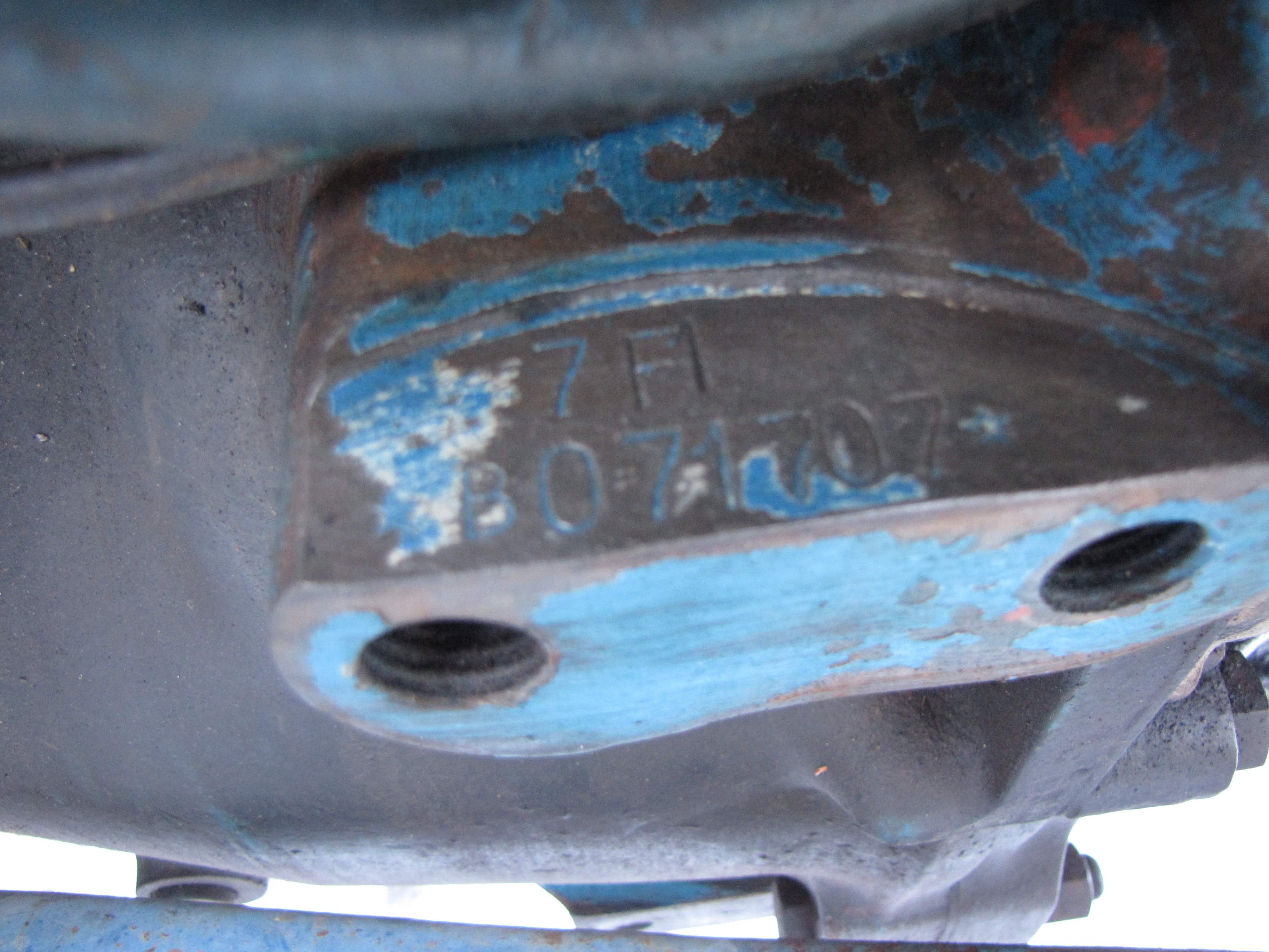

O.K. this is what I know so far, it's a ford 2000 3cyl diesel. Not much eh!

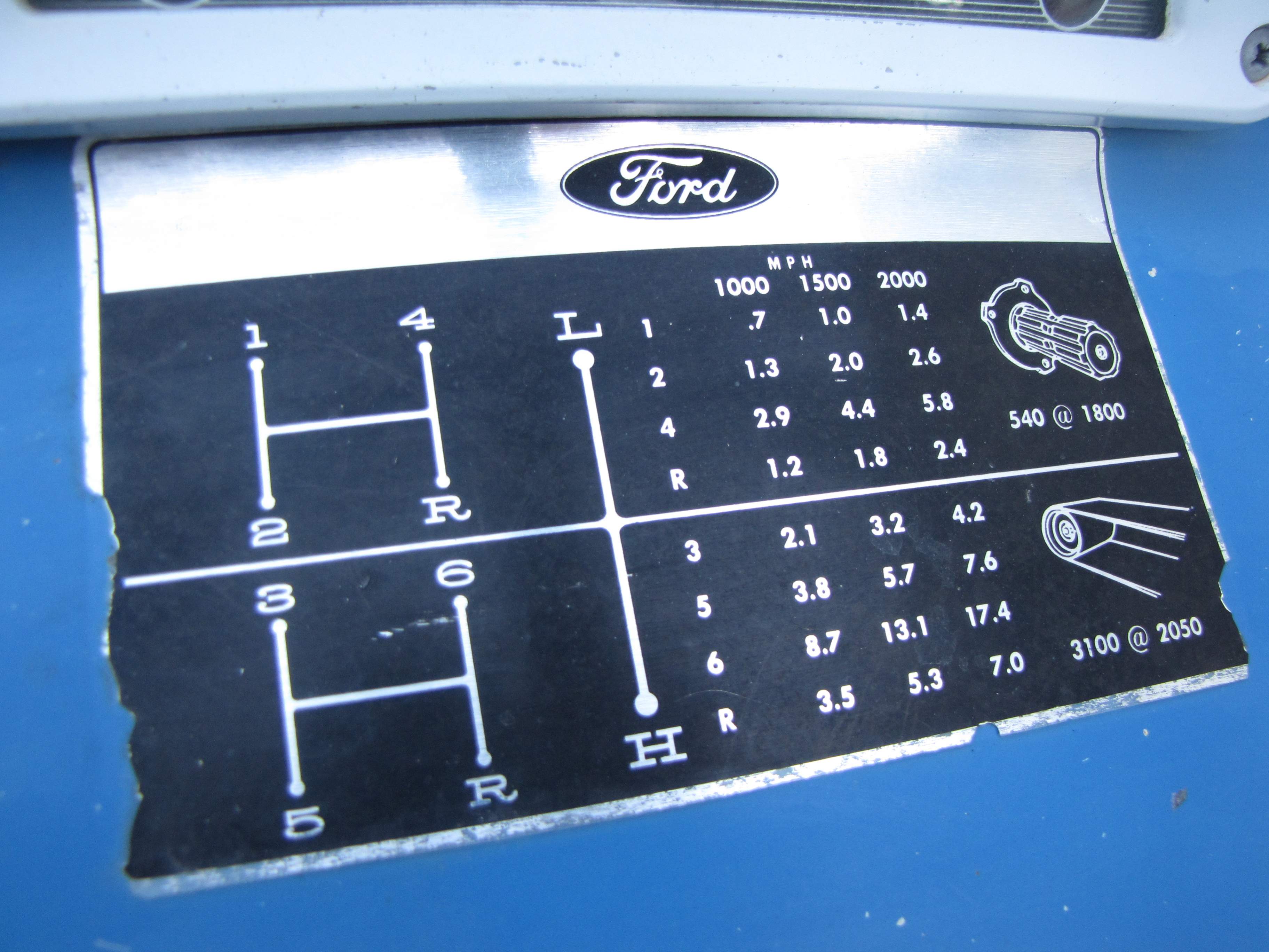

I think it's a 6 spd tran, it has 3 forward 1 reverse plus high and low range.
I've read that there should be 3 #'s on the bell housing behind the starter but there's only 2 (7F1 & *B071707*). I think 7F1 is the productuon code but what about the other.
The pto will keep running when i shove the clutch in even all the way so is this live. I did notice the clutch is a little harder to push at about 3/4 the way in but the pto still turns. the only way to stop it is by disengaging it using the lever under left side of seat.
Are there any other #'s to look for?

/ ford 2000 identification #2
