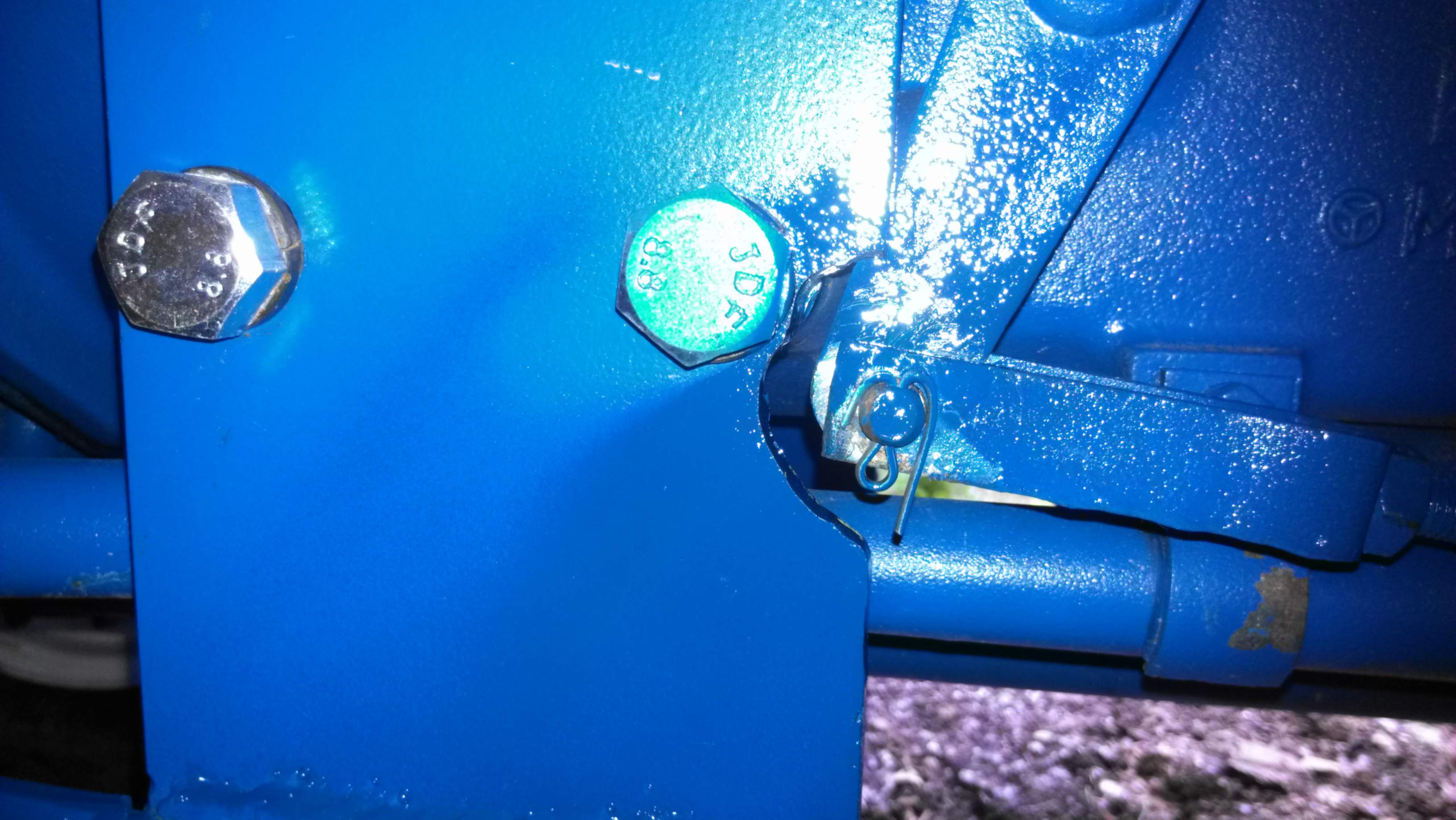

Problem solved. Dealer picked up the tractor and told me that when i installed my coldwater fel the clutch lever was hitting the loader support. This caused the clutch to not be fully released and thus it was constantly on. His fix was to grind out a section of the loader support so that the clutch pedal was free. He told me that the clutch finally wore to the point where it wouldnt grab anymore so thats why it wouldnt shift. He stated that i probably wore off 5 years worth of the clutch.

/ Ford 1710 wont move #12
Huh. So there was no adjustment in the loader mount. So now you have a weakened loader mount. Who mounted the FEL? You or a dealer?
#13
The loader is an aftermarket coldwater loader installed by me. I don't know how much the mount was weakened but i dont think it was much.

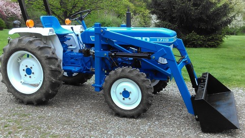

/ Ford 1710 wont move #14
muzzy you should be fine,could you post a pic of the tractor w the coldwater ldr ? Looks like a nice set up......
#15
Here is a pic, very happy so far.
