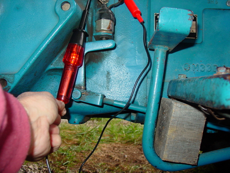

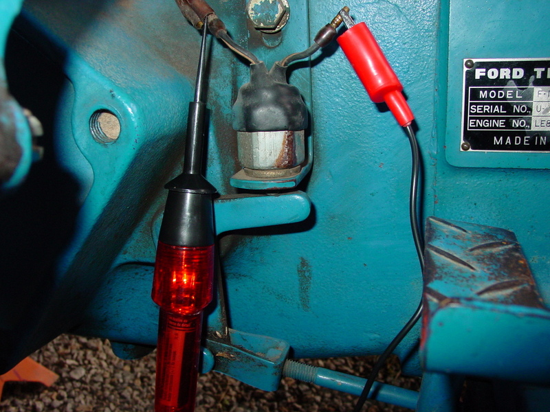

Neutral Safety Switch is a normally open switch to keep starter from coming on. It is wired in series with the staring circuit. It is normally activated with stepping on the clutch. Need to clutch to turn the starter and it keeps the tractor from unintended longing forward when the tractor is in gear. As the name implies it is a safety feature. Attached pics show how neutral switch is situated for Ford 1700. A simple test light should verify if it is working or not. clutch up and it should be open , clutch compressed and the switch is made. Obviously you can adjust it up or down for proper engagement.

I looked at the link and could not see any pic there. Bottom line , pressing the clutch thru some linkage, direct or indirectly should close a normally open switch . I have it the same on any vehicle that I have that is gear. My Honda civic has the switch just next to the clutch disk. I recommend you to go and press the clutch and follow the pedal and all linkages to see the switch. switch can be internally located but that makes not a lot of sense as far as repair ability a and diagnostic. I will go to NH website to check it out.

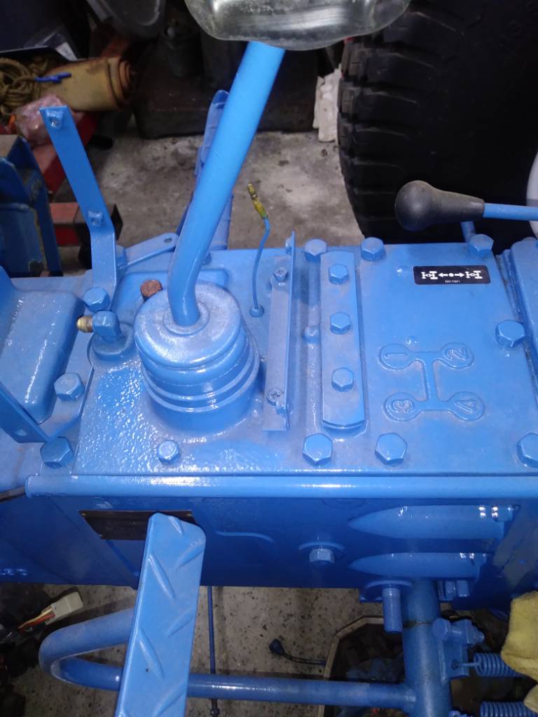

On the 1710 the switch is in the transmission, it uses a magnetic reed switch. There is a single wire coming out of the trans next to the shifter. You may have to remove the plastic cover to get at it.
If you disconnect that plug and check for resistance to ground when in neutral you should have zero if it is good. It uses this path to ground to complete the circuit.

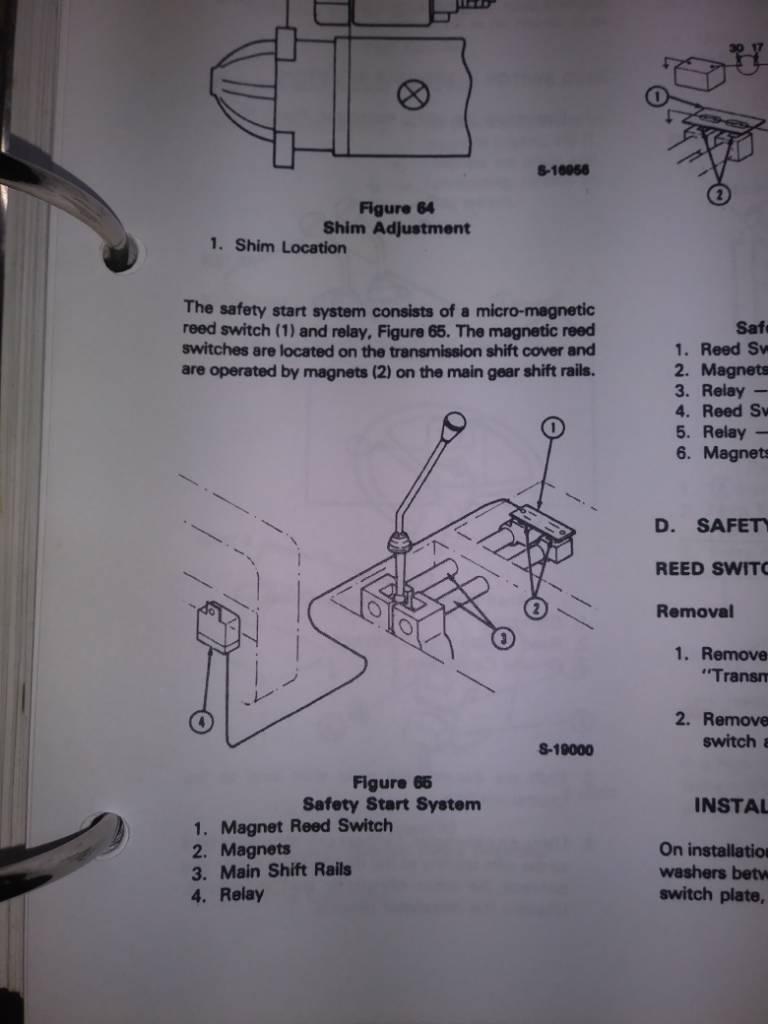

On the 13,15 and 1710 the switch is internally mounted. These models do not have any switches on the clutch pedal. These models you have to put the gear selector in the neutral position to start.
This switch provides a path to ground to enable the starter relay. The relay is usually the problem, but is easy to troubleshoot.0726202032.jpg0726202031.jpg

Instructions and diagram from Ford repair manual

Thanks for the pic. I personally think it is a bad design. The stick shift cover cover can be removed to have access to the switch but that's a bunch of unnecessary work. Saying that and if switch is a magnetically operated reed switch then they are very robust . what happens when you ground the wire ? does it completes the starting circuit?
Yes, when you ground the wire it pulls in the starter relay. The ones I have been around are very reliable. The only time I came across a switch that was a problem with is that metal shavings accumulated between the contacts. It created a higher resistance and would intermittently not close the relay. I had to remove the cover and clean the contacts of the metal shavings.
