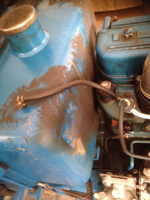

I have a mechanical oil pressure gauge on my 1700 as the sender went bad. Do you have a source for an original so I can get the 'idiot' light to work again? I'd actually probably 'y' that oil pressure port and put a sensor AND mechanical gauge on (I like numbers when it comes to important things like oil pressure). Speaking of oil pressure, what is 'good' oil pressure for a 1700? At operating temperature, mine is around 35psi at a 800rpm idle and around 50psi at 2500. Seems plenty for only 2500rpm, but wonder if there is a range for 'normal.'

Actually, I got that sender unit about this time last year direct from NH. Pricey, but they can get them. I was tilling about a 1/2 acre and the oil light started blinking. That's a scary feeling since the tiller puts more strain on my machine than anything including the backhoe. The service manual is at the shop, but those pressure numbers sound low to me. I'll look it up.

Well, darn it. I guess Ford (or I&T) didn't think oil pressure data was too important. No specs given for any model. They do say that all models have an oil pressure relief valve that can be adjusted. I would warm the engine good, pull the valve cover and observe oil flow to the top-end at idle. Should be a nice steady dribble (not spurting) out of each push rod.

That is the NH website I was perusing indeed, but I obviously don't know how to search as I still can't locate the number! Ha! The oil pressure sender you listed from eBay certainly is reasonable, but the connector doesn't look right to me (understand I don't have the original unit, only the wire that goes to it). It looks to me that the connector end on my tractor (a 'c clip' where you tighten a screw around it to secure) wouldn't work on this unit. Obviously snipping the wire off a bit and putting on a new connector is no issue, just wanted to make sure that my original wiring harness hadn't been tampered with in the past (doesn't appear to have been). If this eBay unit is the cross referenced part for the 1700, it sounds like I don't have much of a choice but to change the wire connector. Given my obvious inability to search the NH parts website correctly ( ;) ), which of the three part numbers listed on the eBay ad is the correct one for the 1700? Given the price of a new one at $18.95 vs. $10 for an old one from Wengers that will undoubtedly fail in the (near) future, the choice seems clear.

ZR WON, I have the part number for the original equipment.
Part #SBA185246011 sender unit. Original unit has a screw terminal on the end to use a wire with a round connector(or C clip).
