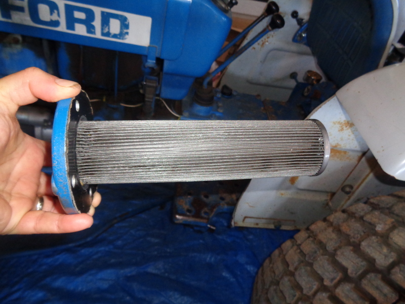

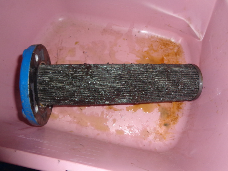

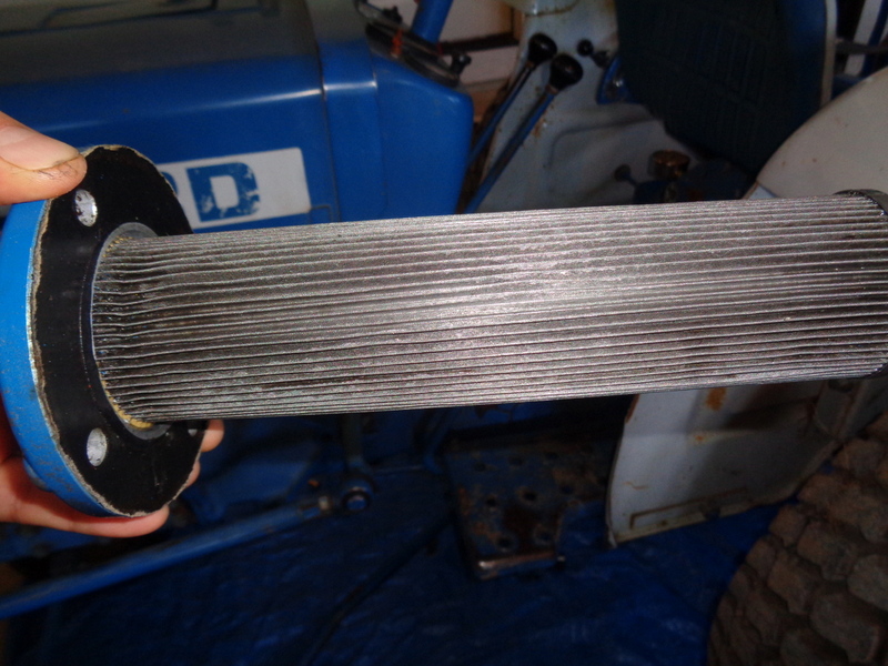

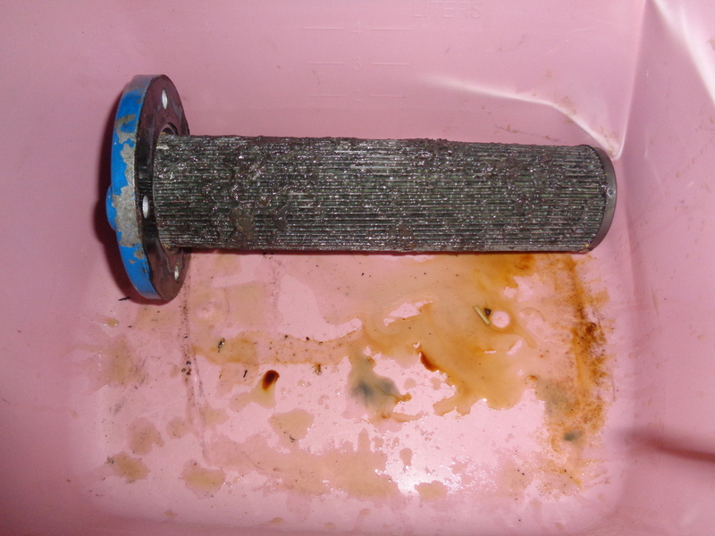

Last time I went to borrow it, we couldn't get the hydraulics to work. Searching on here gave me the idea to check the filter screen and sure enough, it was clogged. We cleaned it and changed the oil and it seemed to work fine around the house. When I got it to the property, it worked fine when cool, but once it got hot, it didn't work right. When I set it where I wanted it, it would leak down and be scalping. When i tried to pick it up, it wouldn't come up immediately, but it would eventually come up until it wouldn't. I put it on the trIler by jacking the mower up with a come-along.
That was a couple months ago. We changed the oil and checked the screen again (not clogged) and now we cant get it to do anything. Hot or cold, it won't even try. I can pick up the lift arms by hand with no resistance at all.

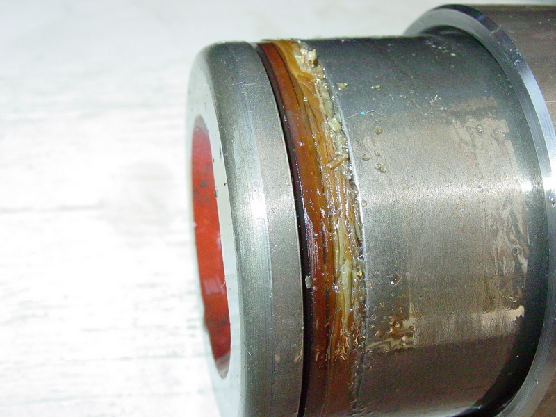

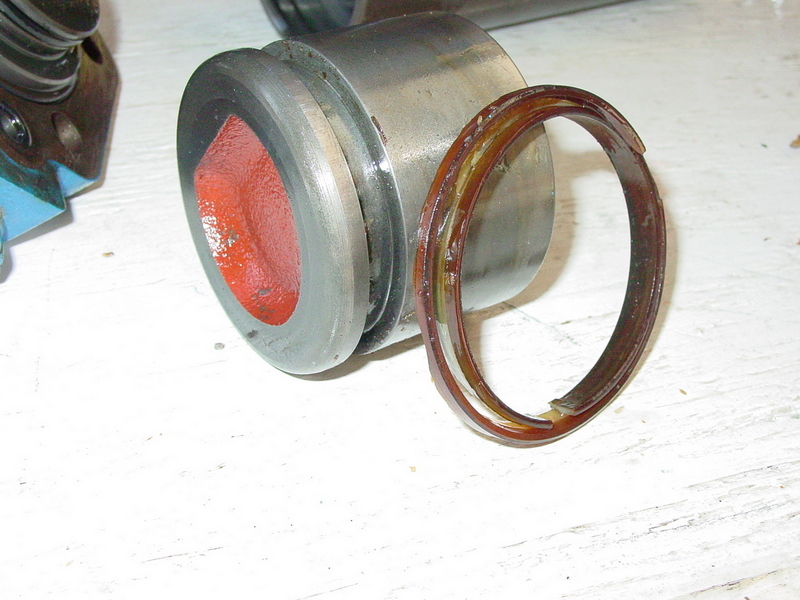

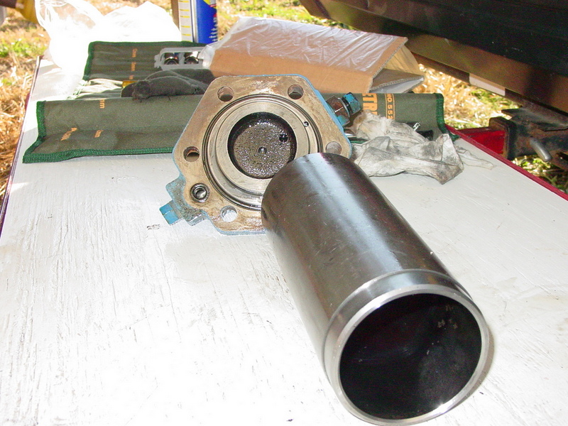

Put the new seal in a pan if hot! (not quite boiling) water to get it on the plunger/ piston. Let it cool before putting the cylinder back on.
/ ford 1700 hydraulics #5

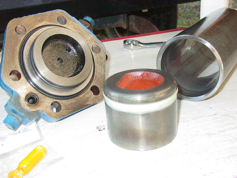

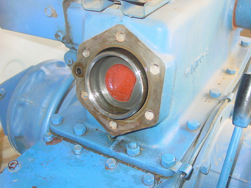

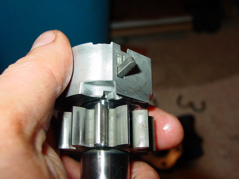

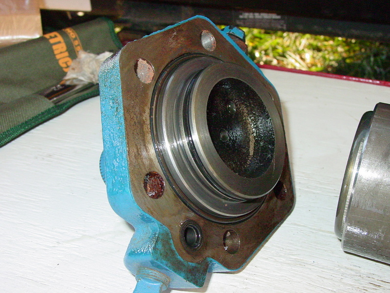

it is the seal more than likely. I had a complete tutorial with pics on how to do it. unfortunately the picture hosting company started removing my pics as they wanted monthly maintenance fee. Messick's does have the seal but now it is more expensive many years ago when I bought from New Holland dealer that I used to have near by. Boiling water is one way, but I elected to put teh seal in the plastic bag,leave it in the sun while I removed the lift cylinder head. Do oil it liberally and it is a one time shot to put it right. once is in in reverse you cannot take it out without damage. It is a double lipped seal and the lips need to be toward hyd pressure. Let me see if I can dig up some pics,

Well, it doesn't seem to be the seal. Took all that apart and the seal looked good and the piston is tight in the cylinder. Looked in the hole while I had the cylinder out and the linkage seemed to work as it should. Before i took it all apart, i removed the plug where yall are installing a gauge. When i cranked the tractor, fluid seem to flow fine. Not loads of pressure, but it is a big hole.
Going to see if i can find a gauge locally tomorrow. If not I'll order one. Have a pretty good parts house in town, also a Napa and a Rural King. Also going to re read the links and figure out what else to try.

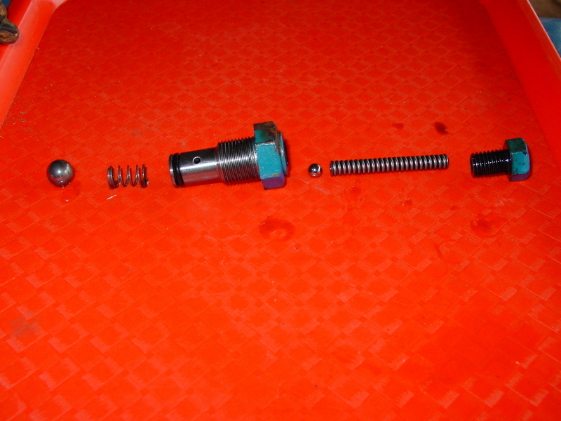

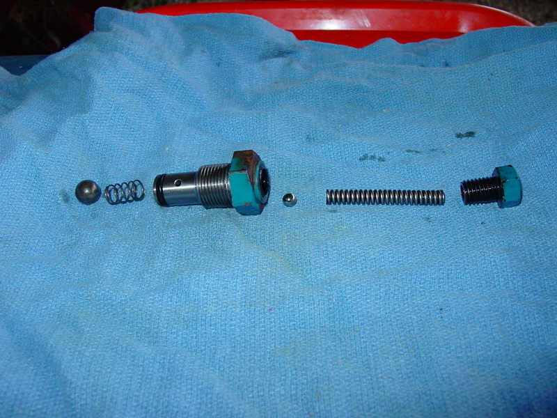

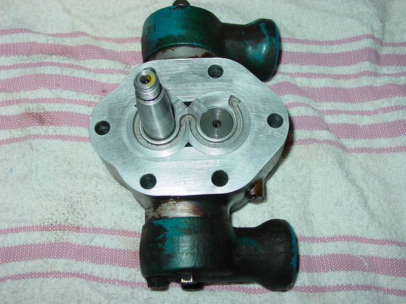

Ok , check the check ball, and spring. If it is stuck open by debries it will bypass the fluid back to the diffy just passed the lift cyllinder. The purpose of it is to dump, bleed off the pressure when you have a heaving implement on the 3 point and you are driving in a rough terrain. As you hit a bump the lift piston pressure elevates due to kinematic energy caused by the wight hanging in he back.

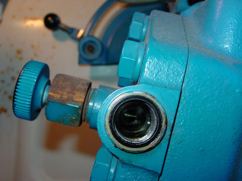

Pulled the check ball and spring all looked good and clean. Cranked the tractor with it out and worked the lever while it was running. No fluid came out at all. Went back to the relief valve by where the hydrolic line comes in. Pulled it to make sure I had put it back together right. While I had it out, I cranked the tractor. Fluid gushed out. Prolly spit out a quart to a half gallon before I could get it shut off. Pump seems to be pumping good, granted there was no head pressure.
If I unscrew the plug where you're putting the gauge, crank the tractor and move the lever, shouldn't the rate of flow change if the valve it working correctly? I cranked it before and oil came out, but I didnt work the lever. It seems that should test the valve and eliminate everything but the pump?

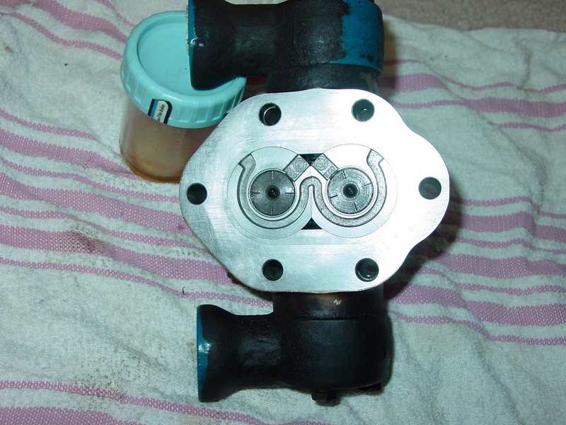

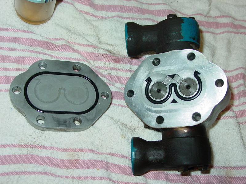

I pulled the plug where you have a gauge. I cranked the tractor and had it running around 1500 rpm. No fluid coming out no matter how I moved the lever. Ran the rpms all the way up (about 2550) and have flow coming out the hole. It increases when I lift the lever and decreases when I lower it, so the valve is doing something. I expected it to stop when I lowered the lever all the way, but it didn't. I reinstalled the plug and cranked it again. At about 1500 rpms the lift still wouldn't do anything. When i ran it on up and worked the lever, the lift came up pretty quick. Then I lowered it and it went down. Then nothing, same as before. It did go up and down 1 time. Dont know if that's getting somewhere or not.
Going to head to town and try to find a gauge. Not sure if its needed now for diagnostic purposes or not, but would be nice to have if I can ever get this thing fixed.
In my simple mind, it seems to be pointing to the pump. Hope I'm wrong.

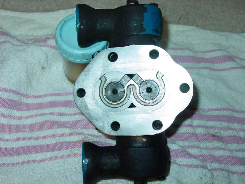

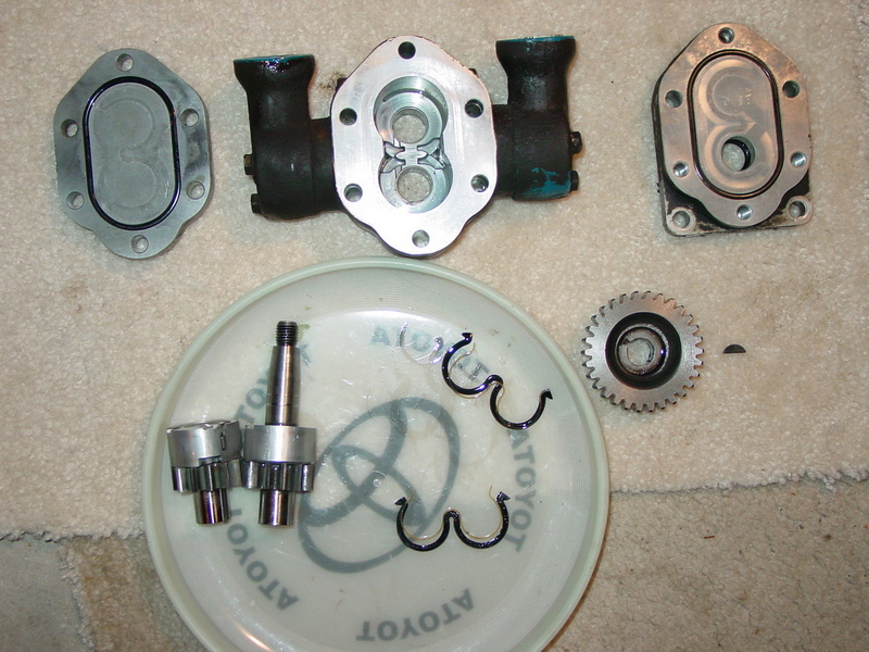

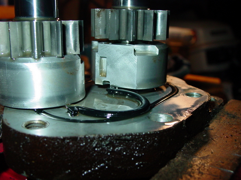

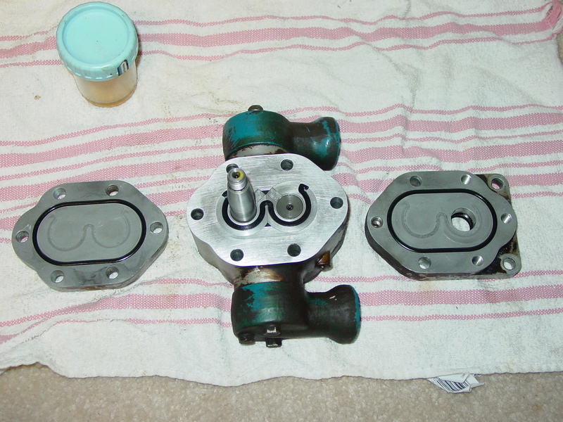

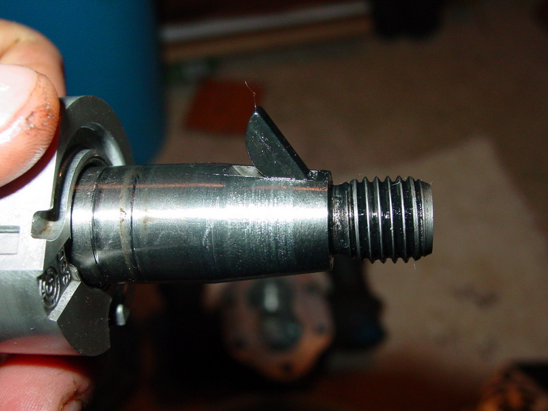

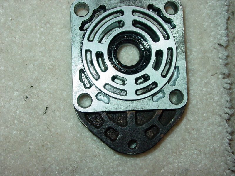

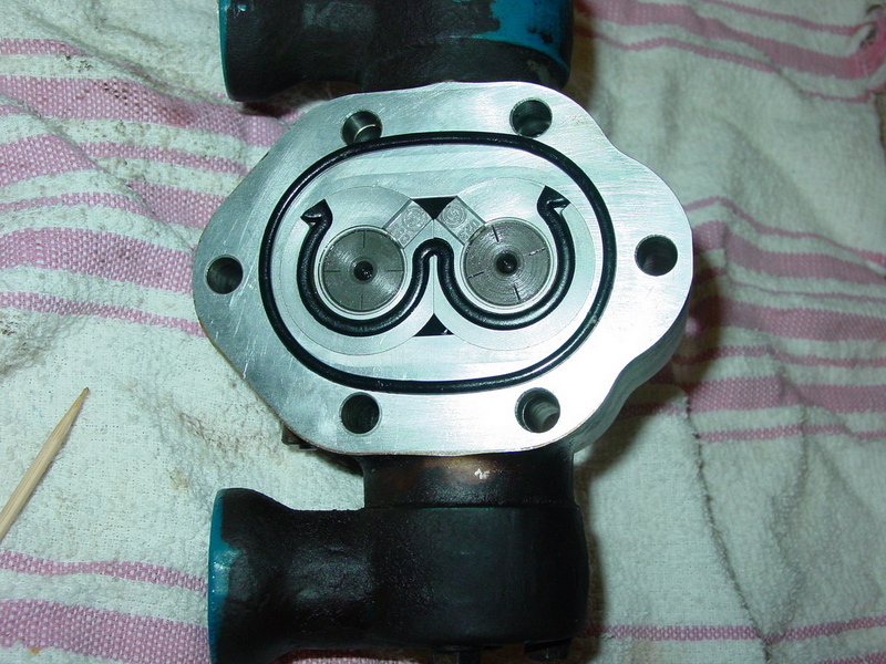

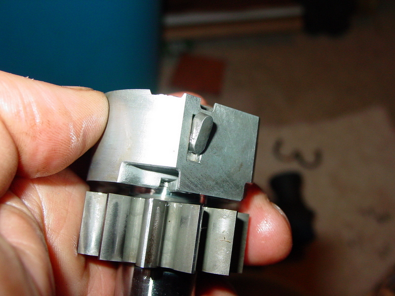

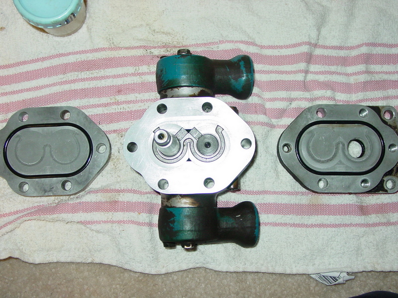

all very good observation, nothing stupid here. two things the pump might have lost it's pumping capacity some, pump has an internal relif. it is very little. But majorly I think your spring on the relief is set too stiff since you actually have flow at higher rpm. Guge is good to have to see at max rpm what you get at the guage. That basicallt tell you stiffness and presssure associated by that. Go ahead and back out the adjustment to reduce spring stiffness and see where you are and report back. I will go ahead and post some pump's innards pics FYSA.

I was in the process of pulling the filter again just to make sure it isn't clogged. I doubt it is. The tractor has only run a total of probably 15 min since we cleaned it, and we washed the housing out with diesel fuel before we reinstalled the filter and put in new oil. I'll go ahead and back off on the relief valve tension, then go look for a gauge.

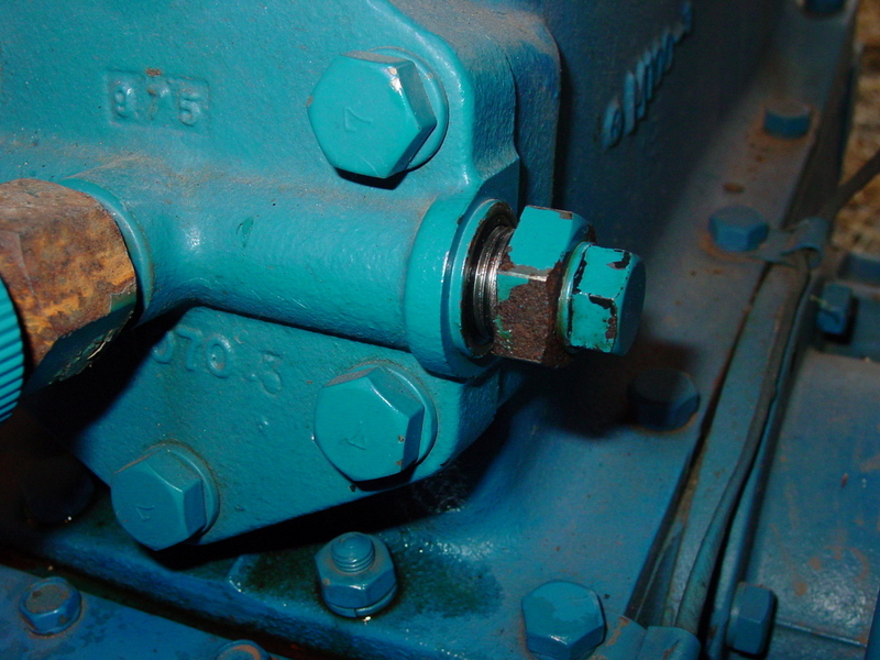

I backed off the adjustment screw on the relief valve, first one full turn then another half a turn. At a turn and a half the tension quit. Still no movement of the arms at any rpm.

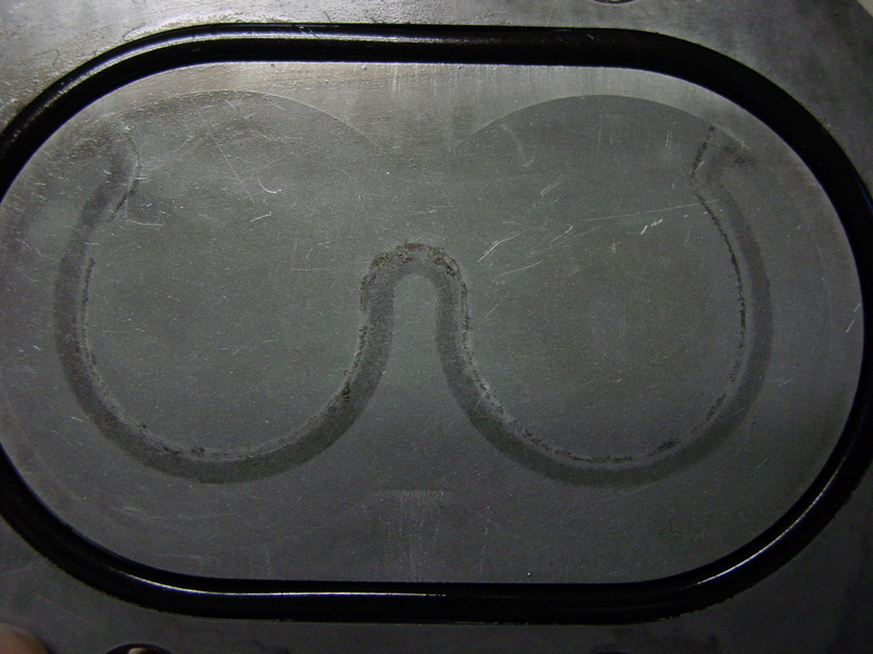

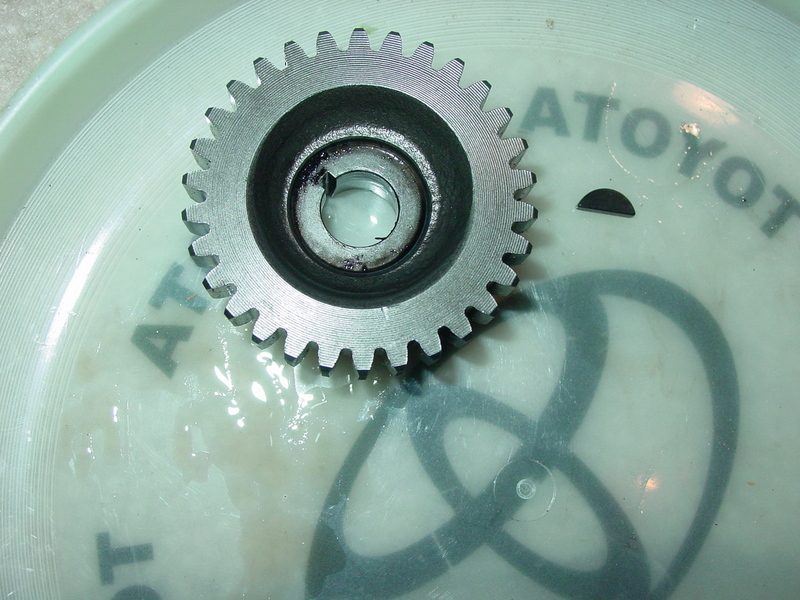

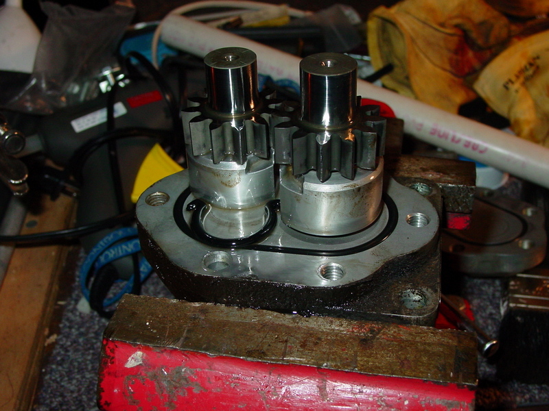

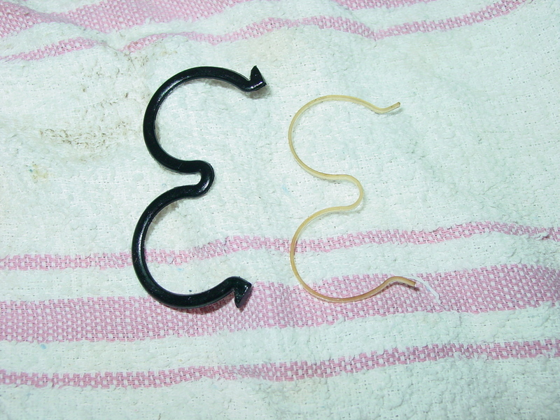

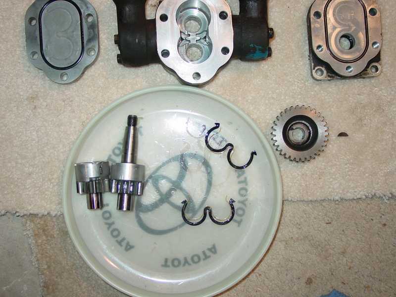

ok. if you tightening the spring stiffness all the way then the pump will be deadheading and it then should lift the poppet valve to relief the pressures so the pump will not be destroyed. If deadheading does not lift the poppet than I think pump seal are having problem. in mine , the seals were but input shaft seal was sucking air in. Just read your post #8. I own my 1700 for about 15 years. the very first time I cleaned the screen, I opened up the drain at the bottom of diffy and nothing came out, then I made a hook thingy with a stiff wire, shoved it in the whole and there it cam a rat looking glob. further when I opened the screen I made a collection jar and shop vacuumed the bottom of the diffy and sucked out about a gallon of thick pudding like crap. You might have a situation like that too. Pump overhaul is pretty easy , My overhaul kit then about $50 and I hope still available out in the aftermarket. actually I wished I bought a spare pump seal kit and lift cylinder . I wished there was a spot you could have checked the pressure on the discharge side of the before it hit the relief. I also suggest you inspect the suction pipe from banjo at the screen to inlet banjo of the pump. few pic , below on vacuum system. The hole on the handle is to keep the bucket from collapsing. plug the hole by your finger and it suck and let go it releases.

after your post # 8, I responded and did not get to see your post #9. That's great, You are gaining on it. I did suggest checking the banjo, it was sucking air. Now if it lift anything, your son is heavy enough.Even if with the tractor off and weight hanging on the back it causes static pressure in the line and the gauge must, I mean must register something. why don't you take the gauge off and run the tractor with the bucket next to the hole to catch the oil. You must have oil coming out since it 3 point is working. Put some air pressure in the gauge to see if if it working. you might have a bad gauge.

Great, that's why it is always best to break down the problem to smaller bits to not miss the lil details. Glad it was not the pump. Gear pump can take some abuse but not much. Overhaul kit might be difficult to get now but pump replacement as best will be a used one perhaps worse shape than yours and they sure do want a pretty penny for it too. Tractor without 3 point lift is kind of useless too. The screen is of a good quality and mine is 40 years old and till looks good after I clean it. My memory recollect that it was made out of stainless steel. Report back with the gauge, the bourdon tube might have locked up, give it some air pressure and tap the side gently with a rubber mallet to see if comes back to life.
