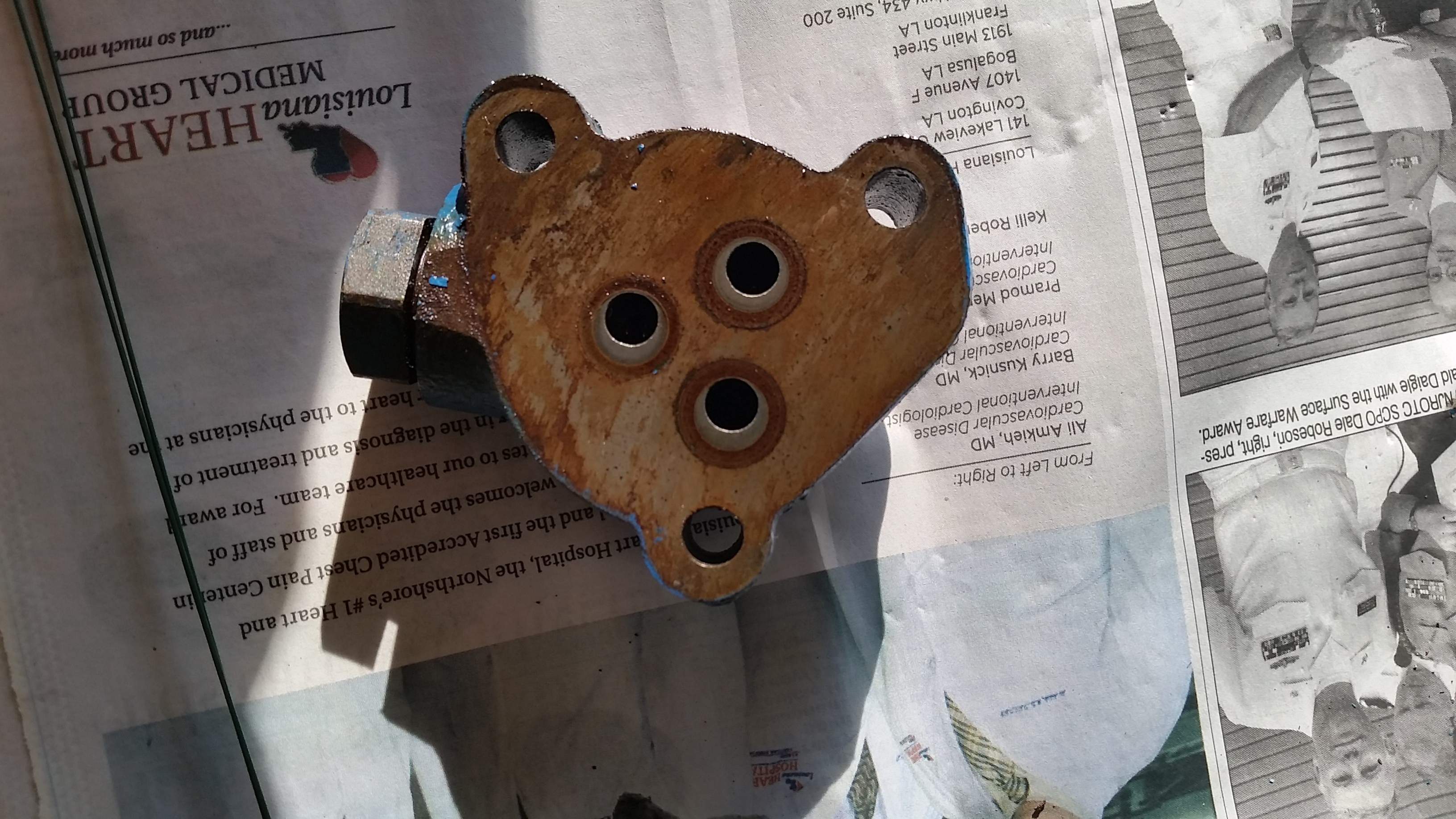

Yes it was connected until I pulled the entire side cover. Not sure if this is my problem but here is a pic of the relief valve on my tractor. Everything I read in the manual as well as your picture says I should have a relief valve pictured as you've shown however, mine looks like the one attached with a large bolt on the end instead of a cap and screw.
That is a type the pressure is adjusted by adding or subtracting shim to change spring stiffness causing new hyd pressure setting. Try to answer question I asked on feed back arm.

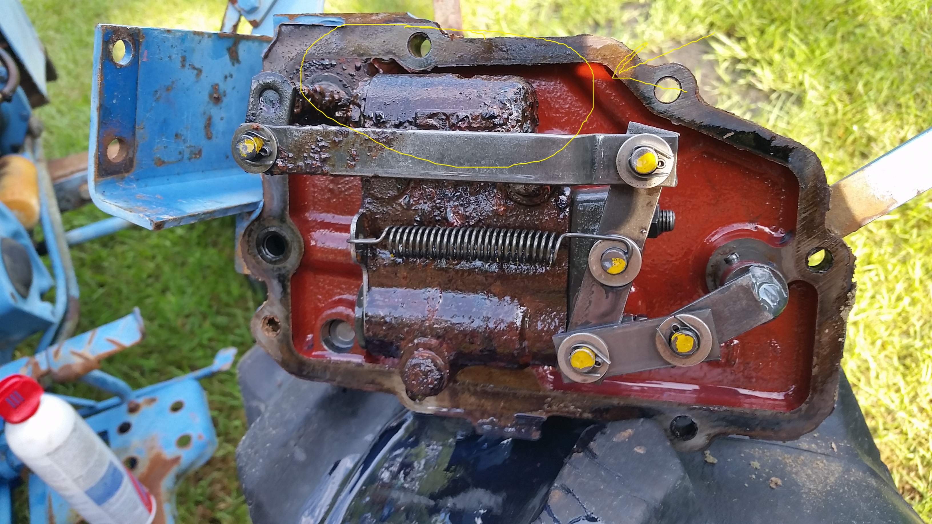

Would this be the spool valve that you're referring to? If so out of curiosity looking in the small hole on the top of it should I see movement when moving the position lever?

Yes , that is the spool valve. the hole on the top might be relief port when the spool is pushed to normal position by action of feed back arm. I have not opened mine, did not need to bu there are I belive two spools, two highly polished shaft with some oring that direct the flow to three point cylinder head/piston and unused portion of the hyd oil back to diffy. Your hyd is constantly pumping hence live hydraulics.
Do what I suggested earlier before you get in to the spool, you do not want to damage the innards if it still good. Eliminate one item at a time from small to big.
