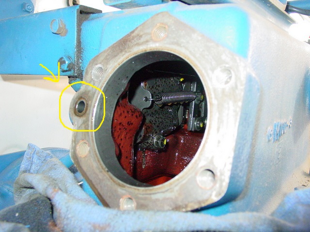

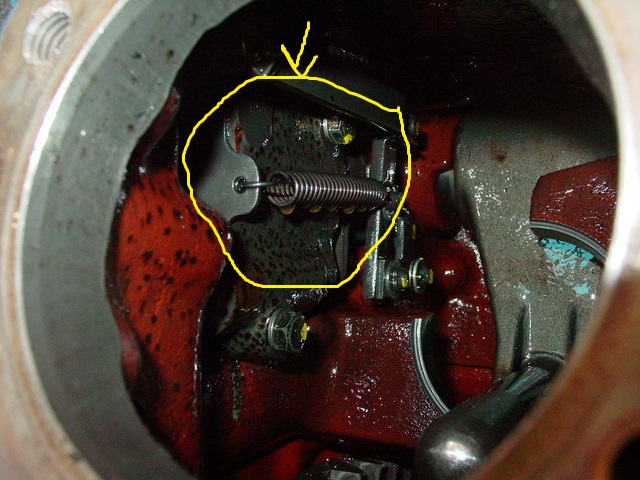

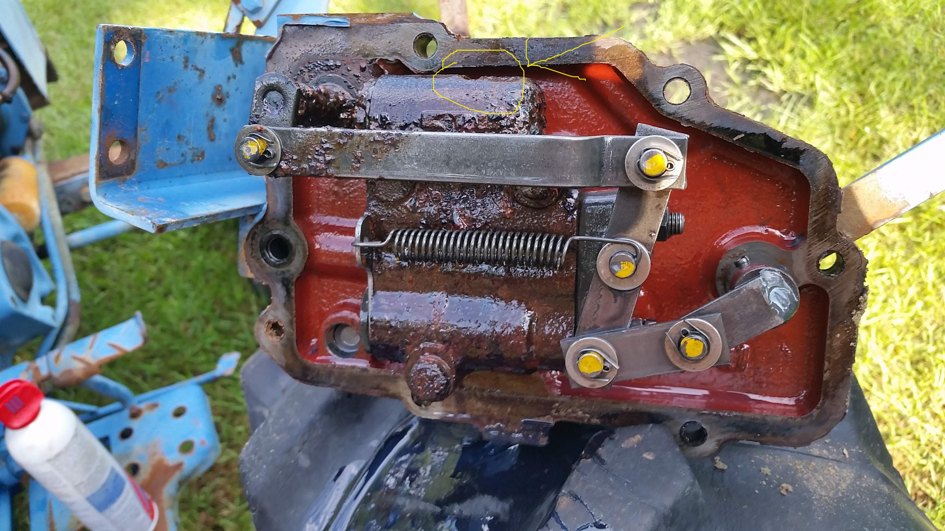

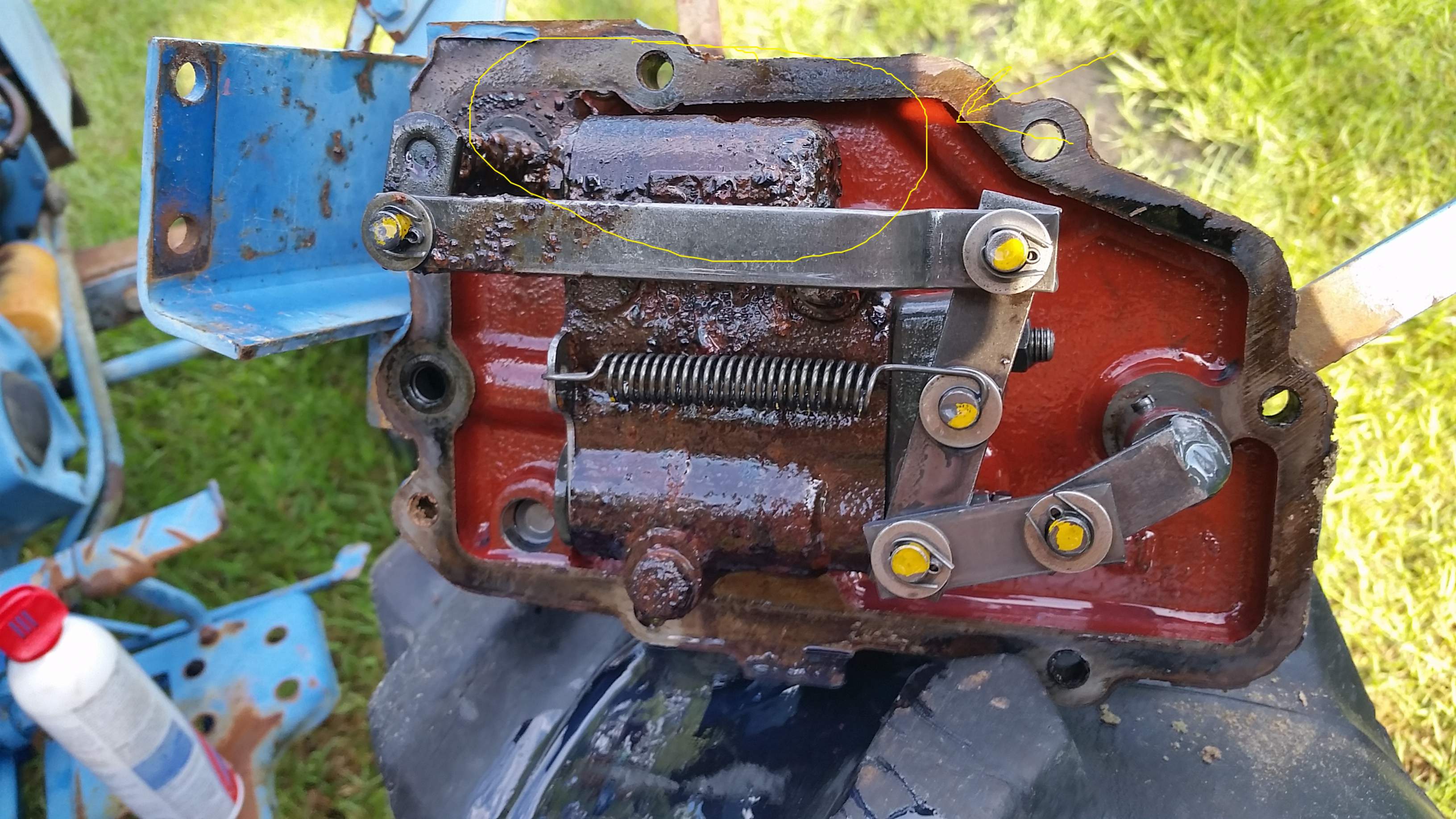

I did learn a little from that post thanks square1. I borrowed some pictures to illustrate where I am confused. The first shows where no fluid is coming. The second shows where the fluid is flowing from the top and over what is circled. I'm trying to figure where it is being diverted or blocked. Ok so pulled the whole side cover off and the bottom pic shows where the oil is coming out. Hope this helps someone help me.

I just saw this thread. if you have flow diverted to diffy it means two things. it is either diverted from pressure relief device to diffy and in that case the valve should chatter against seat and spring. You will for sure hear that. Secondly, if the spool valve is in neutral position at any height the flow is diveterd to diffy thru spool valve.
Are you sure if your pump inlet is flooded, pump not cavitating and actually pumping? if you take the relif pressure cap off and a bucket to collect oil then you can verify pump flow to relief device.
On the lift cylinder head if you take the nut off on the left hand (from driver sea) then you can verify flow to the cylinder head.
with the rate of drop knob fully closed (turtle position to the max) then you can raise the 3 point but once reaches max it can no longer accept fluid and all have to by pass thru spool valve on neutral position.
My wild guess is that your are not pumping oil. what do you mean when you say flow is diverting to diffy, are you running the tractor with lift cylinder head removed and then you observed flow?

Yes I have good flow from pump to the relief device but no flow from the relief device to cylinder head aka the nut on either side of the cylinder head. I pulled the cylinder head and turned the ignition over a few times watching fluid flood the diffy from the place marked in the last pic. I suspect the relief device as being my culprit but not positive as I am not very well versed in hydraulics. As of now I have no movement from the 3pt at all. I hope that clears up your questions and thanks for answering as you seem to be the go to guy and I am quite confused. Background on the tractor is it was a $500 find that worked prior to be parked for 3 years. The hydraulics worked fine for previous owner until he changed an axle then they stopped and he never bothered to fix since he just pulled a finish mower.

On 3 point arm there is a rod that connects the right arm to spool valve. That is a feed back arm that causes the flow be diverted to diffy at any give height of 3 point. is it connected? it is not missing I suppose ? right? if that is disconnected the arm will rise to it max position and the relief would chatter. At that point raising the lift arm handle up and down would have have no effect and 3 point arm will stay at it highest point. Did you take the cap off the relief device and observe tractor running? there is a poppet and spring that sets the hyd pressure setting for the tractor about 2300 psi.
PS. Just noticed that you had the side cover off, no way you could have done it without removing the feed back arm.

Feedback arm is there and hooked up. I have tried moving it with it unpinned from the arms and pinned to the arms with no effect to flow. it always seems to flow right back into diffy no matter what I do instead of the cylinder head.

Ok. when you removed the head then there is a passage way and an o-ring that transfers oil to the head and thru a needle valve to lift piston. are you saying that nothing came out of that hole and all was transferred to diffy internally? right?
Two things can prevent that from happening,
1- less likely issue with spool vlave with blow out seal that or somehow stuck in neutral position (transferring un-used oil back to diffy)
2-Your relif device is stock open . More likely.
I suggest to you to remove the nut from relief device and inspect shims, and spring, run the tractor to see if oil come out of that hole. take a bucket to avoid mess on the floor. I hope you have some dirt that stuck in there and keeping the valve open. (same as kidney stone). Clean the seat of the poppet valve for the relief and put back together. start tractor and see raise and lower the arm to see if any oil come s out of the hole on the lift cover hole lining up with the hole on cylinder head.
Try it and report back.

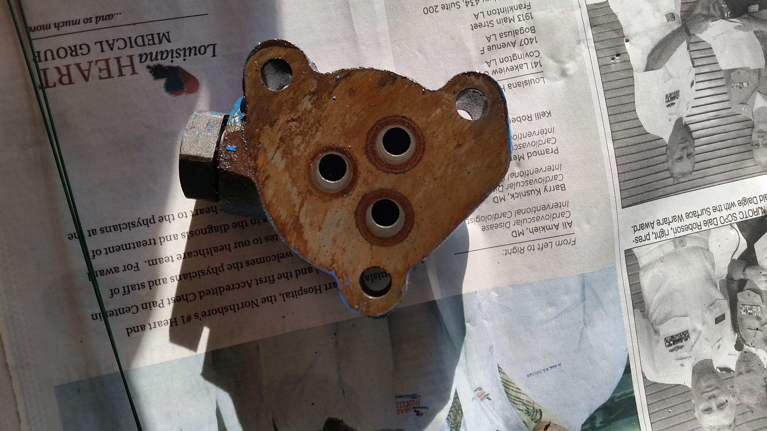

Would this be the spool valve that you're referring to? If so out of curiosity looking in the small hole on the top of it should I see movement when moving the position lever?

Yes , that is the spool valve. the hole on the top might be relief port when the spool is pushed to normal position by action of feed back arm. I have not opened mine, did not need to bu there are I belive two spools, two highly polished shaft with some oring that direct the flow to three point cylinder head/piston and unused portion of the hyd oil back to diffy. Your hyd is constantly pumping hence live hydraulics.
Do what I suggested earlier before you get in to the spool, you do not want to damage the innards if it still good. Eliminate one item at a time from small to big.
