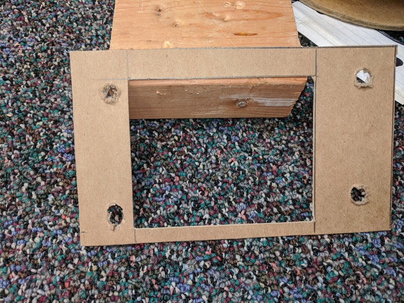

Ray, below is one source I found for the gasket. The Part # for it is SBA 145996040. You can always buy gasket material, make a template of your damaged gasket, transfer it to gasket material sheet, trace and then cut out with exacto knife, blade , scissors or however you can. You might be able to salvage old gasket by carefully removing the housing and then cover the gasket with some high temp RTV blue , let it skin and put all back together. You can also just use a bead of RTV gasket on the one side of the mating part, let it skin a bit and put it back together.
I had to overhaul my 1700's steering column and could not source a gasket quickly. I cut out one out of corn flex card board, Covered both side in RTV, let it dry out and then used with no issue. Disclaimer, this part was not under any air or liquid pressure and it was just to seal between steering column and the top of bell housing.

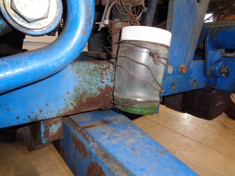

I have a Ford 1700 diesel 4wd that lets water out of the radiator cap overflow when it gets warmed up. I have removed the thermostat and installed a new 13 psi cap and it still leaks coolant past the radiator cap. Little bubbles can be seen coming up through the radiator by looking down through the radiator hole when the cap is removed. I have been told that these symptoms mean a leaky head gasket. It has dripped water out of the overflow tube for years when it's warmed up, but recently has gotten worse. I am considering removing the head and replacing the head gasket, but could not find a new gasket at any of the usual places--Amazon, eBay, or Steiner. I haven't tried Ford/NH yet since I live quite far from the dealership, and they seem unwilling to ship me parts.
Any thoughts on the diagnosis or where to get a head gasket?

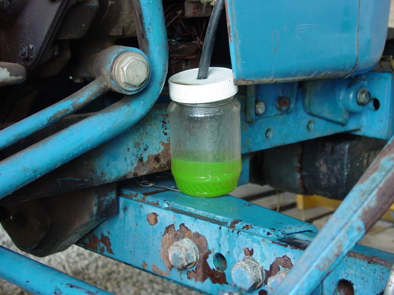

Do the following and make yourself an overflow collection recovery vessel :cool: using a jar of an old Peanut butter. Make sure to consume PB first. Drill the cap just slightly smaller than OD of the rubber overflow hose to have a tight fitting. Put enough of antifreeze in the jar , about 1/2 inch and do make sure the end of the tube is in the liquid. Over flow when engine is hot is normal. it does not appear you have busted head gasket.This marvel of engineering will collect the overflow when engine is hot and gets sucked back in when the engine slowly cools off. I have had that for more than 10 years. You do need some high quality bailing wire to mount the jar in place securely.
That should cost you a nickle!
