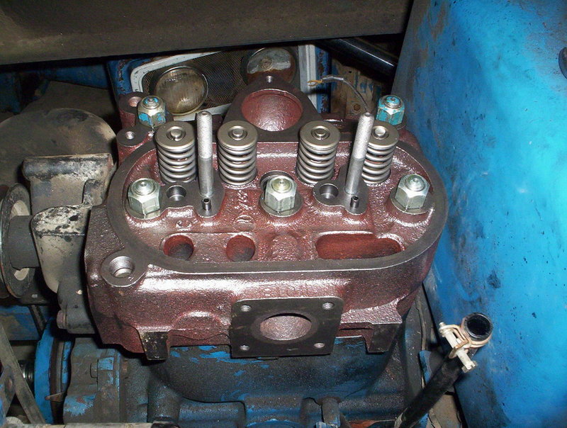

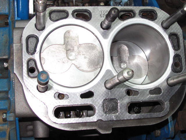

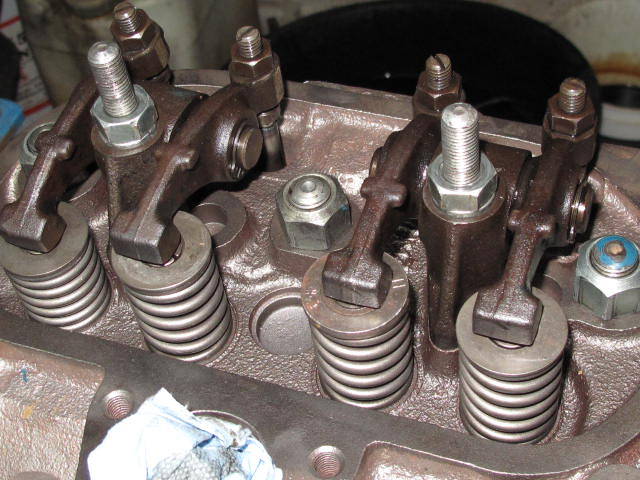

Ray,
Look at the pics below after you take the head cover that's what you will find. The camshaft is inside the block and it is geared to crankshaft gear. it is timed together and that's why guys commented on " timing is unaffected". You do have one push rod per valve , two valves per cylinder (exhaust and intake). Once the rocker arm assembly is removed and push rods pulled out then the head is ready to be removed. You do not need to remove the valves, although some guys might on take the opportunity to do a valve job while all is open. That work you can easily farm out and should not be too expensive. Between top of each valve and rocker arm there is gap requirement that need to be adjusted and the adjustment nut torqued to spec. I can copy that instruction for you and post.
Just make sure you find the root cause first.
Ps. Out of curiosity I checked my valve lash adjustment several years ago without loosening anything. it was right at owner's manual spec after 35years. I have only 1300 hrs on my 1700.
