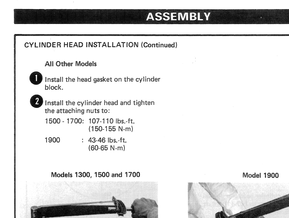

From my service manual it does not mention using new head bolts. From the section on assembly it just says tighten to 107-110 Ft-lbs. Think I'm good to go using the old ones?

Does it mention that you must redo the bolts after a while ? It's very uncommon on old tractors and probably very unlikely on a old Japanese tractor taking the very conservative approach the Japanese have taken new ideas.

I found no mention of redoing the bolts in my servioce manual.
