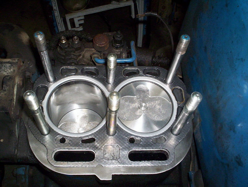

Is there a spec for the head bolt that goes into the block on the 1700. I know the nuts get torqued to 107 lbs but what about the bolts into the head.

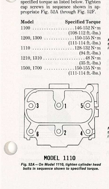

Thanks JC , is that the bolt torque that screws into the block or the nut torque
/ Ford 1700 head bolt torque #4
My manual does not say it very clearly,but I think it must be for the 6 nuts @ 111-115 ft-lbs. The studs are screwed in tight, does not say what torque for them but once you cinch down on the nuts it keeps the studs in tension even if they are not very tight. it is difficult to grab the studs without scuffing up to high torque of 115 ft lbs . It is the nuts that you would torque in the criss cross pattern as they showed. Then the head cover is installed and that really just need to be tight. I have taken the cover off to check the valve last adjustment and doubt if I even had 35 ft lbs ion the two nuts that hold head cover down.

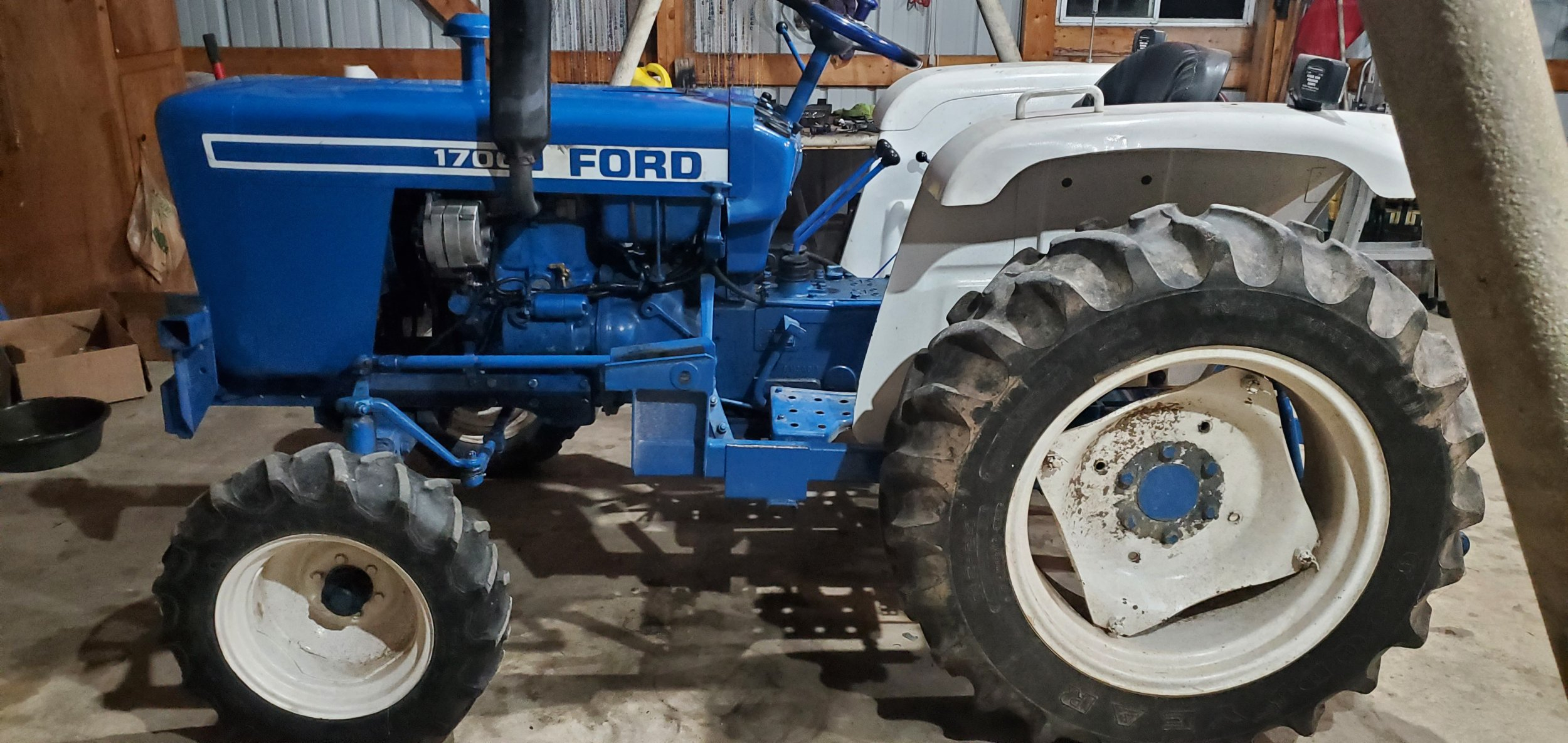

Hey JC, all went well today after a couple of cranks it turned right over, boy it sounds nice thanks for your advice on this post and many previous ones

Awesome Geo, glad to hear that and she does look good. I wondered if that is 1980 or 1981 model. Noticed a bracket next to the steering rod. is that a loader bracket? She'll serve you well, great lil working mule!!:)
Yes it is, getting it back on today

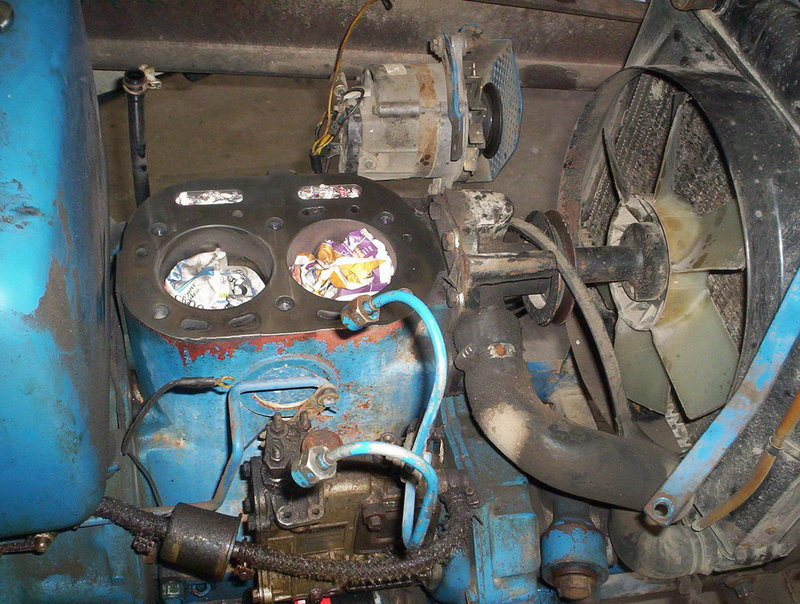

Our 1979 1500 has what looks like a coolant leak from the head gasket. Ordered new head gasket. (Cheapest one I could find was from the Netherlands.)
What all should I do when I have the head off? Take it to a machine shop for resurfacing/valve job?
JC-Retro: thank you for the torque specs.
/ Ford 1700 head bolt torque #12
Now I read that I should replace the head studs as they are torque-to-yield bolts. This true? Having a hard time finding some via Google...
