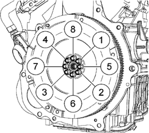

So the tractor is split. The pressure plate levers failed. They must have been out of adjustment. Does anyone know how to get the flywheel off.
/ Ford 1700 Clutch #13
The flywheel should have 6 bolts or so in the center that bolt it onto the crankshaft. If you've removed the 4 to 8 bolts that hold the pressure plate onto the flywheel(and remove it) you should see the bolts I'm talking about. Like this: First picture is the pressure plate, second is the flywheel........these pics are NOT from your machine.
