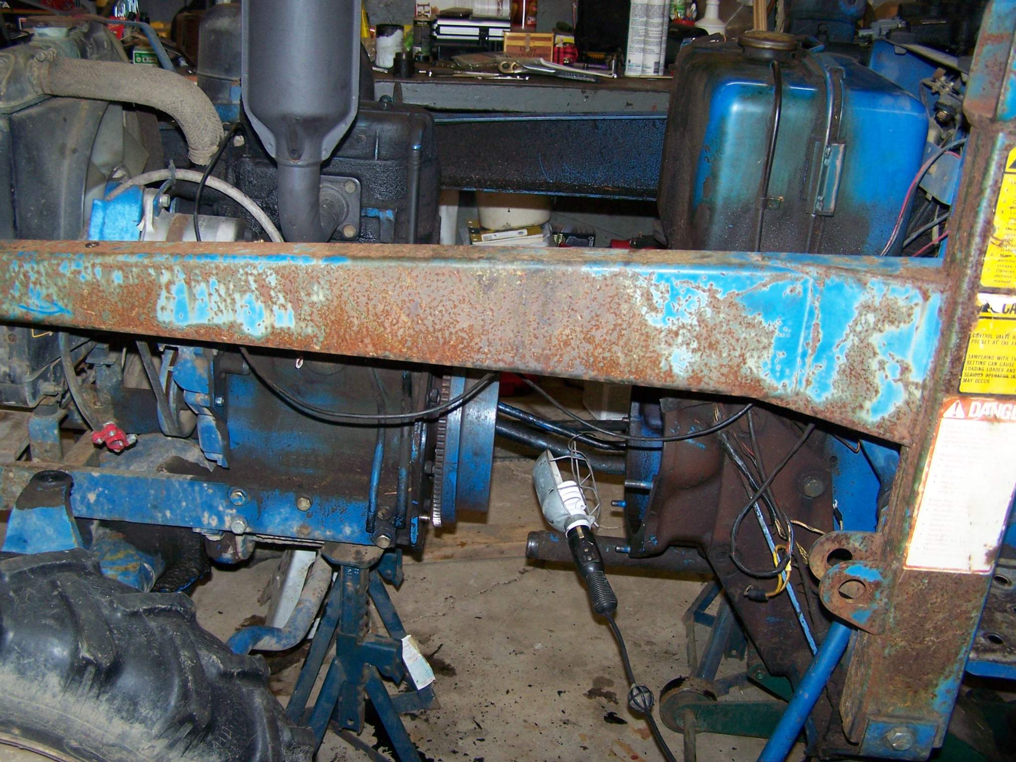

JC- Yup, that plate looks exactly like the one that came out. Not getting the parts until middle of next week, so install won't be until next weekend. I have been doing some other minor stuff while it's apart.
Any suggestions of things I could/should do while I have it split in half??
Thanks-

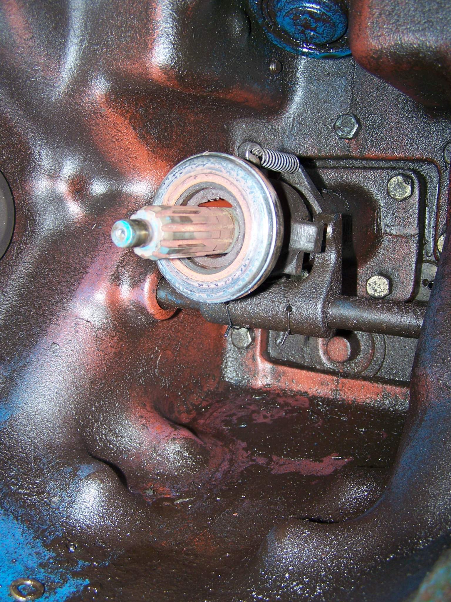

I have not done seal replacement on my 1700 as I never needed to change the clutch yet.
If you go to NH website, under 1700 and transmission clutch diagram you'll find a seal #46 that does the input shaft like Soundguy suggested.
Pics below is the courtesy of Russel. Thanks bud:D
Transmission Input shaft and the retainer.
after you remove it , then you'll see the seal right in front of that bearing you see in the back of the housing.
This pic is not of 1700 but it is TC-35 but with the same design.
Once you remove the Flywheel that's is what you see a big seal that goes around the rear end of crankshaft. Flywheel to crankshaft bolts are torqued pretty tight, not very easy to remove, need breaker bar and may be a cheater pipe for some positive enforcement.:D. On NH website that is seal #19 under crankshaft and flywheel diagram.
Now before I start tearing in to things, I'd examine the oil in the bottom of clutch housing, I start to sniff around and compare and contrast with transmission oil and engine oil to see if I can ascertain where it belongs. Look at tell tale sign of oil seepage behind the flywheel that is slung around or the input shaft.

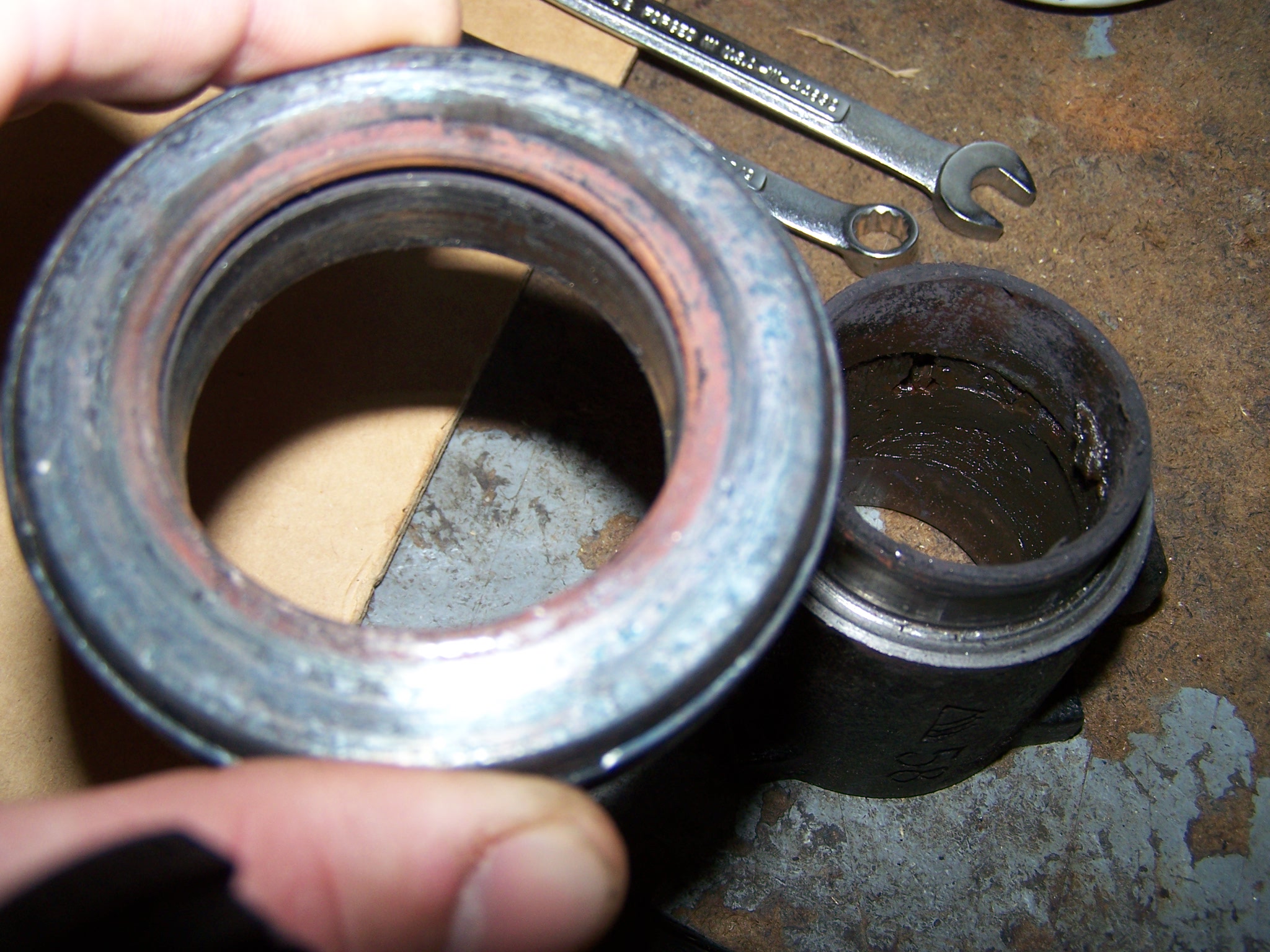

Nice pics JC. My throw bearing is making some noise, its only a matter of time before I pull mine apart. One thing I am real glad to see is the rear main seal is the big lip type that is removable from behind the flywheel. When its that easy to get to, no sense in not replacing it if it has never been replaced before. Good Luck Bickley! TB
