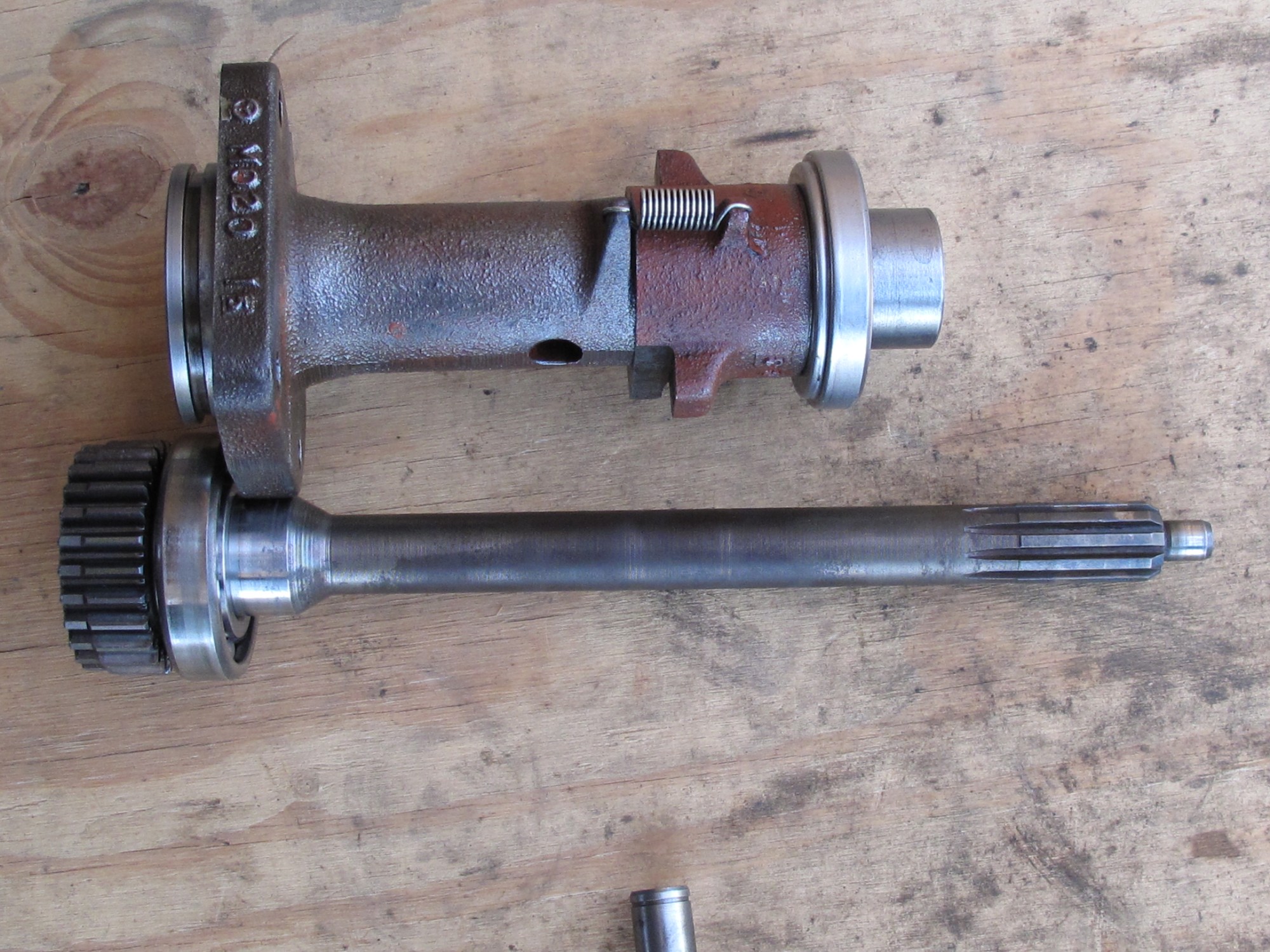

Do you see the retaining spring thru the hole? the sporing helps the bearing carrier to retreat to normal position. is it missing? disconnect the pivot point as it is shown below. get a rubber mallet and hit the arm that turns CW and CCW. That might free up the bearing holder on the shaft. I'm thinking if the bearing holder does not easily slide on the input carrier shaft. visually inspect from the hole. with the pivot removed the arm should be easily move back and forth till you hit the pressure plate spring.

No it should be moving a lot more than that. to the extent of activating Neutral safety switch as pictured previously. I think your bearing carrier is frozen(rusted) to the shaft. Pic below also shows the spring I'm talking about. looking thru the hoe and you should be able to see the top spring and a small mirror can enable you see the spring on the bottom. it is time for you to get the big guns, 4 lb sledge hammer that it:D you need to free it up at the very least.

when the pedal is pushed in the bracket does tow things, one side of it activate the neutral safety switch and the other side rotate a shaft (goes thru bell housing) that pushes the bearing carrier forward. There are couple of pins that keeps it on the shaft from slipping and it has a back up wire to keep the pin from coming out. Although it is quite unlikely, it might have sheared off not allowing correct manipulation of of pedal. you can't fight the pressure plate spring by hand. After all of this, when the fingers not touching the bearing, then do you see less or no gap between pressure plate and friction disk? that's the key discovery.

The holder/bearing can slide forward and return to normal position. If another person pushed the pedal and you watch thru the hole with a flash light you might be able to see where it sticks. I don't know if the springs can sprung out due to breakage hence touching the bearing all the time. if you look at the pic of the pressure plate on one my earlier page you see big spring right under each finger and a pivot point on the opposite side of the finger. if the pivot popped out then I can see the tip of finger touching the bearing at all time.

I'm kind of perplexed with the question. Take a look at the link below. that might make it may be more clear. release /throwout bearing move ofrward just enough to push the fingers toward the flywheel enough to release spring pressure to disengage the clutch.

in normal situation with the clutch out the bearing holder has to be all the way back against the two tab on the holder where the spring is attached. is it resting there or not?

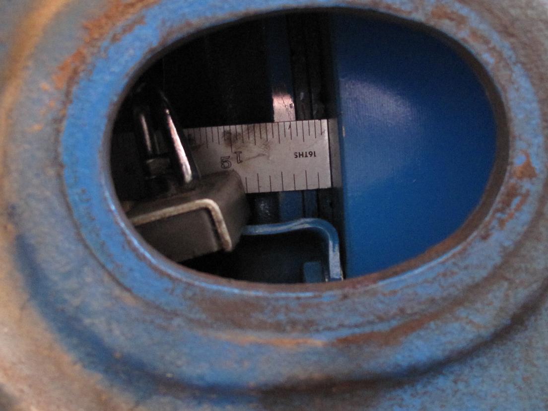

I have taken a photograph of the throwout carrier with the pedal adjusted fully out. It's clearly in contact with the rod.
One of the fingers has clearance between it and the throwout bearing. Not lots, but clearly some: 2-3mm (not quite but almost 1/8"). I apologize for the poor photograph, even on macro I couldn't get the camera to focus properly.

yes, that's what I wanted to see. With clutch out even with one milliliter of gap there is still no interference. if the gap is too small when tractor is cold then I can see as things heat up finger and bearing might actually slightly touch due to expansion and that might cause the slight occasional slippage. I'd try to manipulate adjustment externally however I can to increase that gap and visually inspect it afterward. I'd have the cover off and when the clutch slips I do a visual. I know the tractor has not ran long enough to heat up. The pressure plate spring might not be up to snuff to cause enough friction or you have some glazing on the disk or pressure plate that reduces friction factor. The rest of the stuff look like how it should be and you did not need to split or take the steering column off. I think you eventually will gain on this thing with the addition of a starter.:)

This is with the clutch pedal disconnected and the bellcrank manually moved. You can see there is plenty of room. Even prying on the bearing with a prybar, though, I can't get clearance between the bearing and the fingers.

well, that's not good.:( now, within the few milliliter that you have can you mover the bearing holder for and aft easily?
Now you realize there is 3 fingers that the pressure plate has and you have just verified one. With the starter removed and glow plug loosened you might turn the flywheel some to see if all fingers have the same gap to the bearing. The pressure plate has some total of 6 bolts that attaches it to the flywheel. Although unlikely, is there possibility that a bolt of two is lose or come off causing pressure plate not to be perfectly parallel to flywheel? you can verify the bolts and even tighten them with off set box end wrench. if none of these bear any fruits I then think the pressure plate has spring failure or is warped causing the fingers geometry change. That result will force you to a tractor split. bright side of it that you have on line (Fleabay) sources that you can by the whole assembly less than $200.

Well just my 2 cents worth.... I can see clearance between 1 presure plate finger and the throw-out bearing. Rotate the engine and check the other 2 fingers. As the clutch wears the presure plate moves forward and the 3 fingers move backwards. If you do not have clearance then you do not have full pressure on the clutch and the clutch "could" slip. If you can not solve the clearance problem or, if you have clearance and it still slips, then I would split the tractor and replace the clutch, presure plate, throw-out bearing and pilot bearing.
Just saw JC's post on the presure plate bolts. That would be good to check that they are tight.
