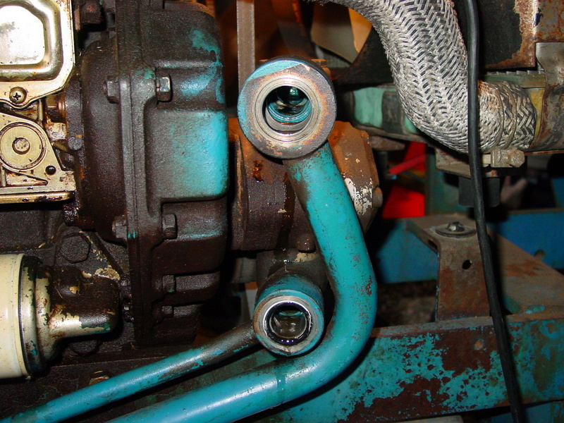

Here are some photos of the inside of the pump. The photo of the wear marks on the inside of the body are on the intake side. The output side is smooth. The scratches on the sides of the bushings and the gear wear marks are much worse than the wear marks on the old pump. The gear teeth are more worn as well.

I downloaded the pics and zoomed in. The side of both bushings that face the gears looked scuffed up in concentric motion. That could be caused with no oil film or derbies in the fluid. Most likely pump suffered inlet side restriction due to partially plugged screen or damaged screen allowing dirt to be sucked in the pump. My 30 year old tractor pump looked better when my lift stopped working. Even then the pump was pumping but not as strong. Having live hydraulic as soon as I could I took the tractor to the barn and never ran till I get the lift seal done. Then the pump would work but a bit slow was when I decided to look at the inside. No irreversible damage was done by then. Your non oem seal appears to be different. Non oem looks flat but mine was a bit round and fatter to fit tighter. On oem there was a nylon backer to add structural stability to the seal. I think overall, oem seems of a better design. If it were my money I would look for repair kit for oem rather than buying another non-oem. if the gear are scuffed up then I can't see even new seal would help. Gear pump are robust but they sure need clean oil and very tight tolerances to be able to make pressure. I don't know what else legacy can do by looking at the pump. Ddi yy send them the picture to get their professional opinion as pump is all they do? I suppose there is no harm getting a 1000 grit emery cloth and try to buff the groovs with a bit of the oil and put it back together and would give it a last go.
JC,
PS. when I zoomed in it looked to me one of the bushing seal had a bit of cut or damaged, is that so?

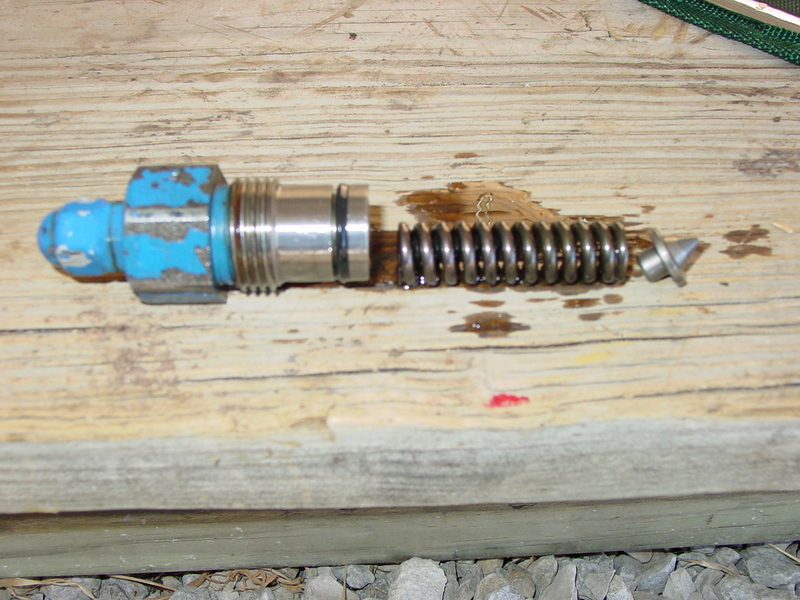

I didn't remove the regulator from the tractor, but took it all apart and found all the pieces just like in your photo.

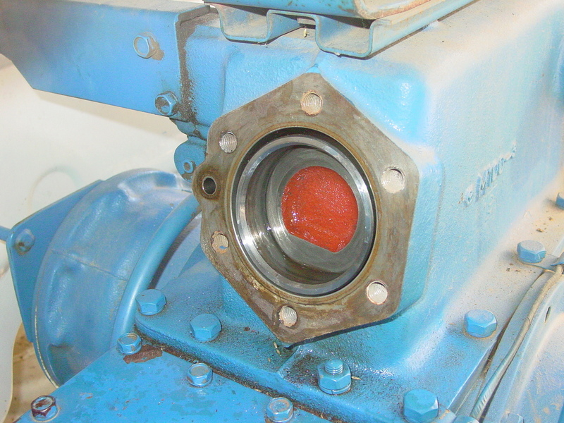

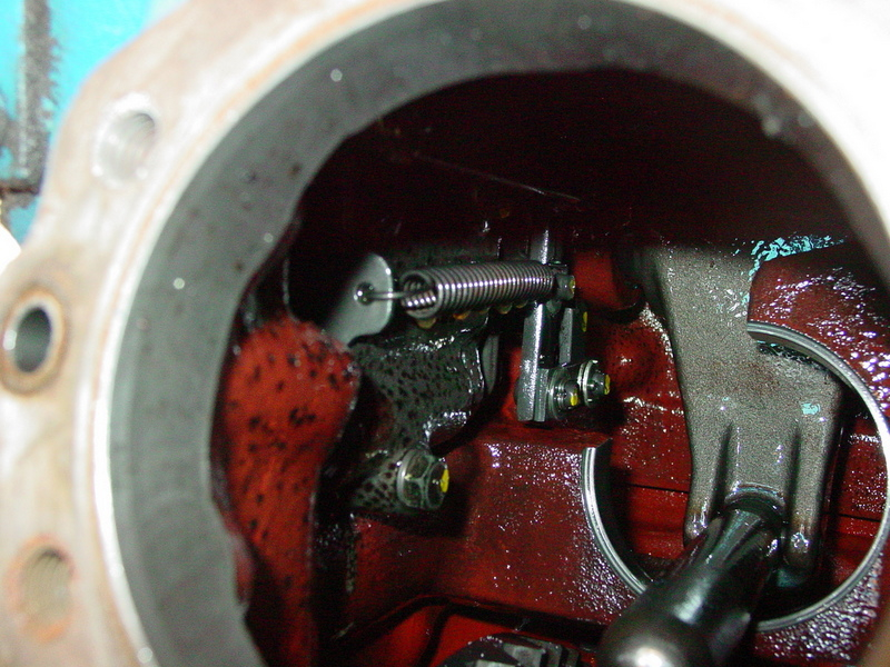

I guess I spoke too soon eh! as you know from my pics I do not have loader on my F-1700 so I am not intimately familiar with it's plumbing. Saying that a lot of fundamental is the same. few things don't add up well.

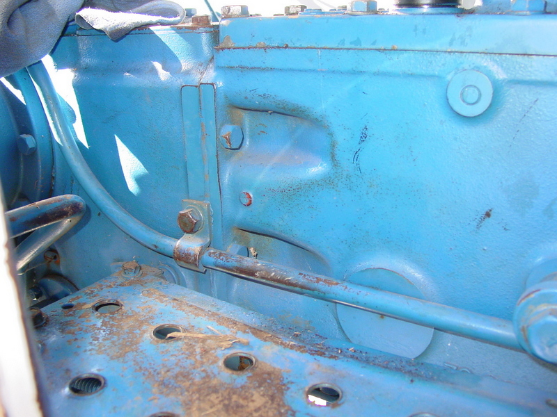

My first tractor was a brand new 1982 Ford 1700 4WD. One day it started this "jerking" motion when I raised the rear blade. I opened the raise/lower valve wide open. Raised/lowered the rear blade MANY times. For whatever reason - the jerking motion quit and never returned. I would guess there was air in the system or something got stuck or a bit of flotsam in the system got flushed out.
