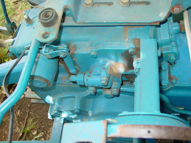

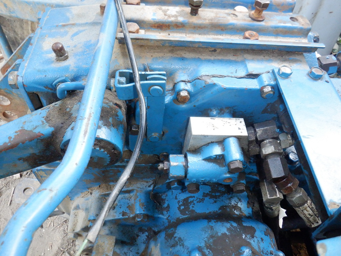

Ijust thought of something else. look at Post #39 and the second picture. That is the spool on the inside of diffy. The hole on the block is where hyd fluid is routed to the lift cylinder. if you remove the head and turn the tractor on, then there should be some fluid coming out of that hole but you will have an steady flow of fluid dumping off inside the diffy. Reason behind that is the spool is in it's neutral position for the given height and the rest of the flow , like in my case without loader constantly is dumped back to the tank. You have an open center hyd system and the fluid is constantly pumped without stop as long as the tractor is on. it is either used in my case only when I use the lift and 99.9% of time dumped back in to the tank to complete the circuit. That could be one other alternate method to test the pump for flow. Make sure the ram rod that pushes the piston up does not hit the inner housing, in other words don't manipulate the 3 point by raising and lowering, the purpose here is just to check the flow.
/ Ford 1700 3 pt lift problem #43
I tried the flow test before taking the pump apart. I get nothing out of the hole the feeds the cover for the 3-point piston/cylinder. Right after starting there is some flow inside, but I think it's coming out of the return lines from the steering and loader. That quits almost immediately, and there is no other oil flowing in there. I'm not sure where the oil would be coming out of that control valve. There is what looks like some splashing coming from below. It must be the pto shaft linkage down in the oil even thought the pto is not engaged.
/ Ford 1700 3 pt lift problem #44
I tried the flow test before taking the pump apart. so, did you take the pump apart?
I get nothing out of the hole the feeds the cover for the 3-point piston/cylinder. That's okay, but as yo raise the lever it will feed fluid and then it stops at neutral position. It is always splashing all return fluid from all hyd (loader steering and 3 point) back to spool valve and returned to diffy.

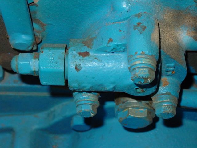

I'm thinking that hole in the cover should have an o-ring, but there is none. it does have an o-ring look at the pic below of cylinder head.
Right after starting there is some flow inside, but I think it's coming out of the return lines from the steering and loader. That's right.
That quits almost immediately, and there is no other oil flowing in there. if you mean flow from spool in the diffy then that is an indication the pump is not pumping. Let's be clear, you have the cylinder head removed, started the treacor and would not see any oil being splashed inside. is that correct?
I'm not sure where the oil would be coming out of that control valve. Not sure exactly where yoy are talking about. The control valve always should see full flow. it is either going to a device or return to diffy. flow is always constant.
There is what looks like some splashing coming from below.Explain where you mean by below.
It must be the pto shaft linkage down in the oil even thought the pto is not engaged. I can see any association. PTO gear and coupler are immersed in the sump and in a oil bath. that has nothing to do with pump flow. I am not clear on you what you mean.

I found the o-ring--underneath the tractor. Should I try to raise the three point control lever to see if oil comes out of the hole to the cover/cylinder head? The cylinder head is removed, tractor running, and the only movement of oil inside there seems to be splashing from below-which is where my drawings say the oil is dumped when in neutral position or when lowering the 3-point. But I can't tell if it's from the valve or from the pto turning and splashing. Would it be running out of the valve fast enough to look like splashing?

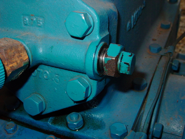

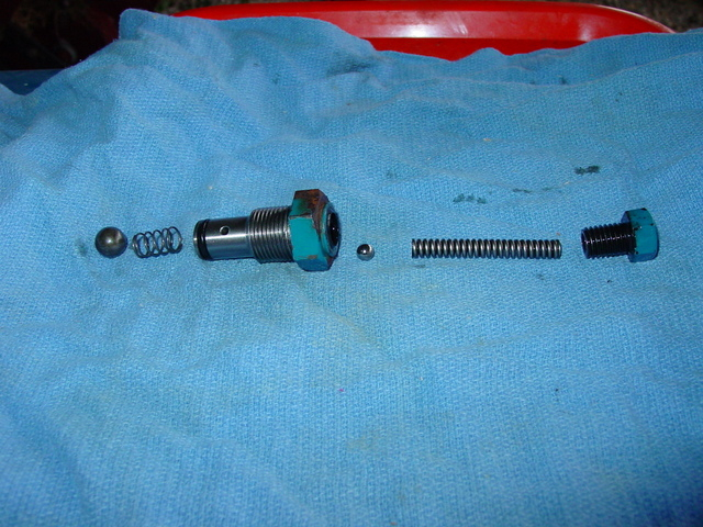

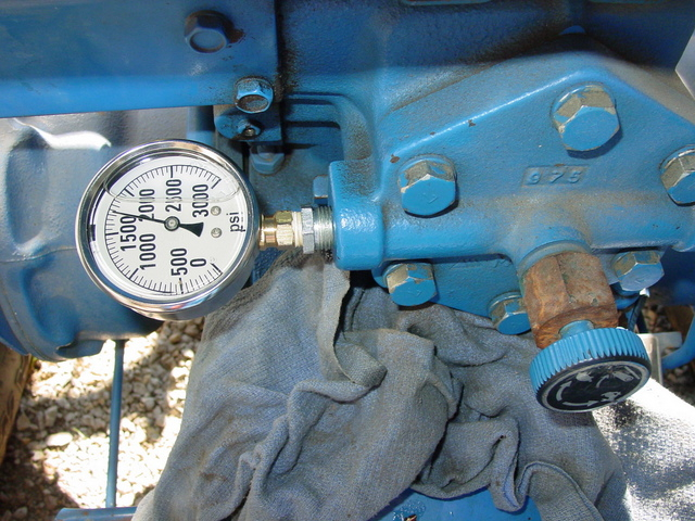

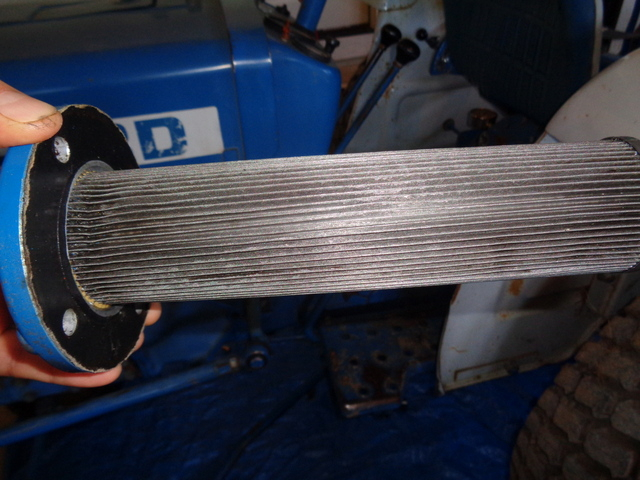

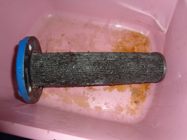

I removed the bolt from the rear banjo fitting of the discharge side and started the tractor. I got less than a quart in a minute, which is probably not enough to do any good. Since I have just cleaned the screen and changed the oil, I doubt that is the problem. If it was a suction side problem, wouldn't the pump would be howling?
But why can I see 1500 psi on the line that goes between the blocks?
/ Ford 1700 3 pt lift problem #53
No it is not enough, and again that flow against the spring in the relief might be even less. It seems, it's all pointing toward a bad pump. The pump would cavitate if the suction tube is plug or restricted. Running the pump like that would heat it up which is not good. That pump does have a by-pass internally that help to lubricate the journals. Like i said before that pump can be disassembled without destroying anything including the seals. You have done just about everything. If I were you, I would open it up and take a look inside. It might be the shaft seal is bad. O-rings will be okay, it does have two seals on the bushing with a nylon backer. May be you can try the seals on your old pump and then again you will need the shaft seal that is a double lipped with a spring in. That might be easier to source. if nothing else out of strong curiosity I would disassemble the pump.
/ Ford 1700 3 pt lift problem #54
I agree. I will remove the pump.
But why do I see 1500 psi on the line that goes to feed the block for the loader and steering? I don't have the right fittings to put the gauge on that link and still be able to try to operate the loader. But if I could, I would expect that the pressure would drop to nothing when I try to raise the loader.
/ Ford 1700 3 pt lift problem #55
Ok Sounds good. The pump should put out about 5 gpm @ 2100 psi, so yo are way below that.
It is Hard to say, but you can have trapped oil in cylinder and due to ambient temp or weight of tractor loader registering a high pressure but at no flow. That is always a possibility. Same way ,you can have a heavy load up on 3-point and you turn the tractor off and you will still register a high psi due to moment arm and the weight hanging on the back pushing the ram rod against the piston. Now , in that fix you can stand at equipment hanging from the back like brush hog and jump up and down you see the pressure goes up and down due to your weight. Everything is interconnected.

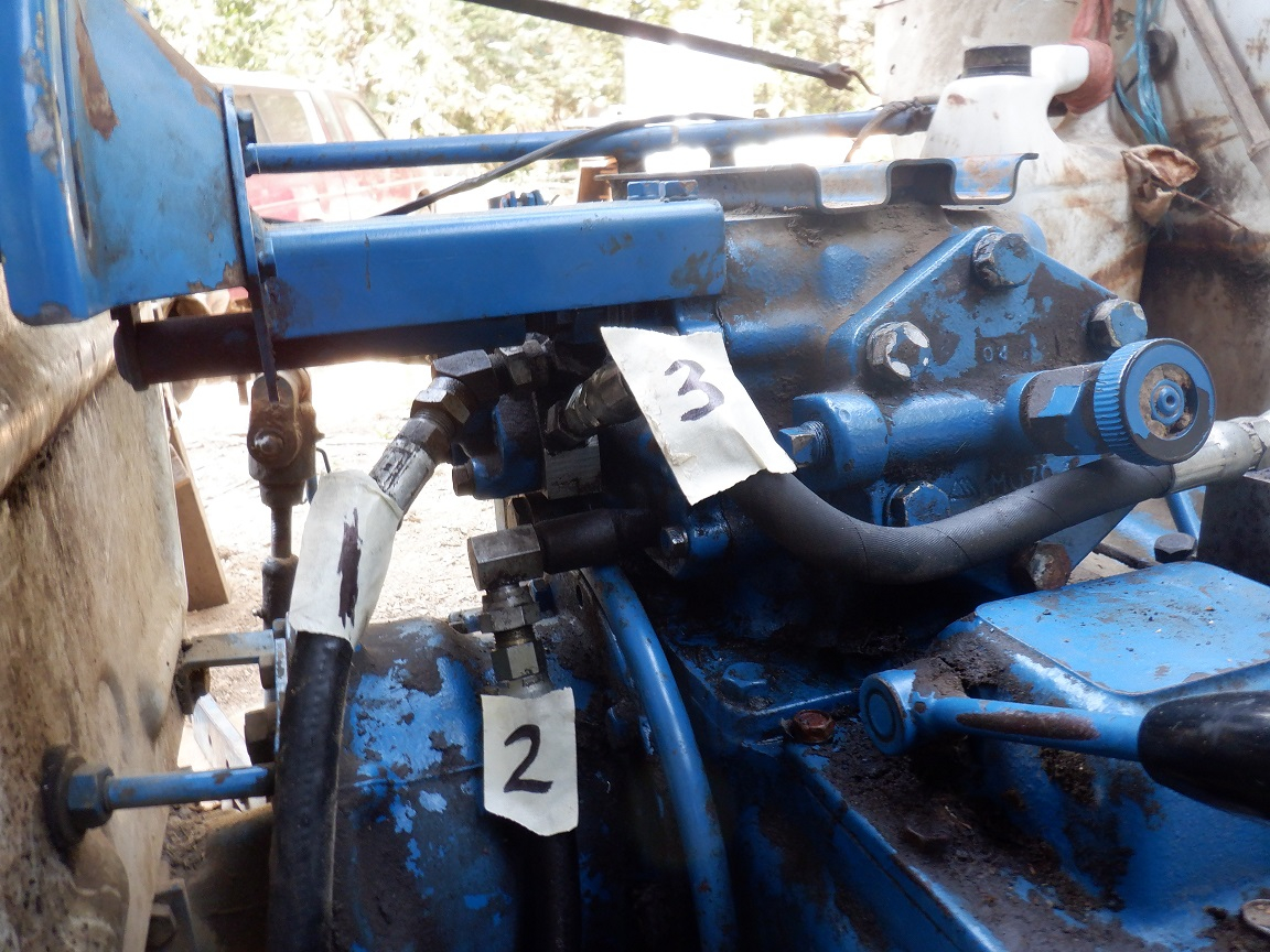

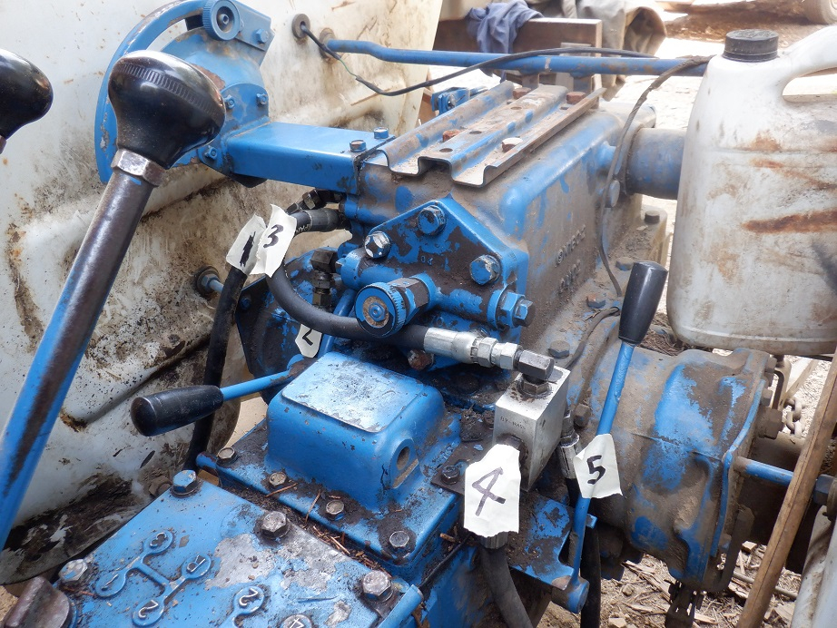

I pulled the pump. It was a harder job than I remember. There's not much clearance around the radiator hose and shroud. 2 bolts and 2 nuts. I had to take off the upper flange to get it out. It came out the other side. I'm not going to take it apart until I have some communication with Legacy Hydraulics where I got it--tomorrow hopefully.
I can say this. The pump I just removed turns by hand with a little bumpiness. The old pump turns smoother. Not sure what this means, but I'm inclined to believe there will be something obvious wrong inside the newer pump.
/ Ford 1700 3 pt lift problem #57
Ok.Make sure not to lose o-rings that go with the banjo fitting. Impeller type pump either end suction or inline both turn very easily by hand. Positive displacement gear type usually are harder to turn, when you try to turn it by hand it kind of feel like a stepping motor. reason is as the gear mesh together there is a bit of resistance. Gear type really need a very close tolerance almost touching the pump case and what make them tight is a film of oil and that's along with geometry of how they carry the oil between the gear and the case is where it can develop and strong flow against a spring in the relief to make pressure. It is very durable and simple design it is susceptible to quick damage if they run dry or have fealty oil in the system. On bumpiness, generally is not a good sign but again you are running the pump a bit dry but by hand turning you will never damage it. if you squirt a bit of oil on the intake side it should feel more smooth. My guess is the seal might have been damage and you have some foreign material along with some scratches on the gear or the case. I guess will know for sure when you do a postmortem on it.
