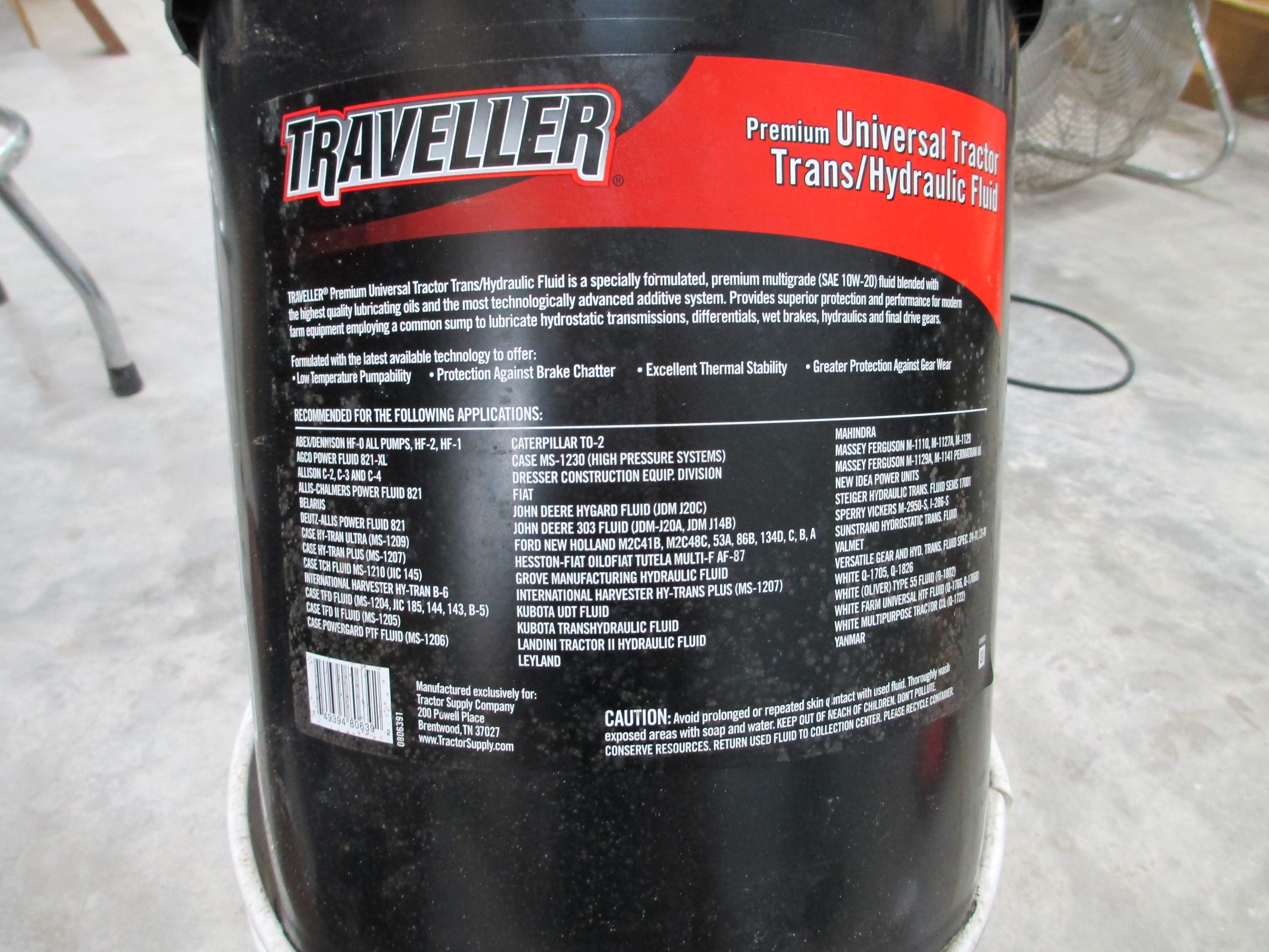

You still need to check to be 100% sure the hydro fluid you bought is compatible with ford 134.

I went out and removed plug. Oil came out, put plug back in while oil coming out. Tried it but no change.
How long should should you run motor to check for operation? I have been doing it for between 1-2 minutes.
Went back out to the shop and looked at the can. It says Ford 134D compatible.

the bucket does say Ford 134
