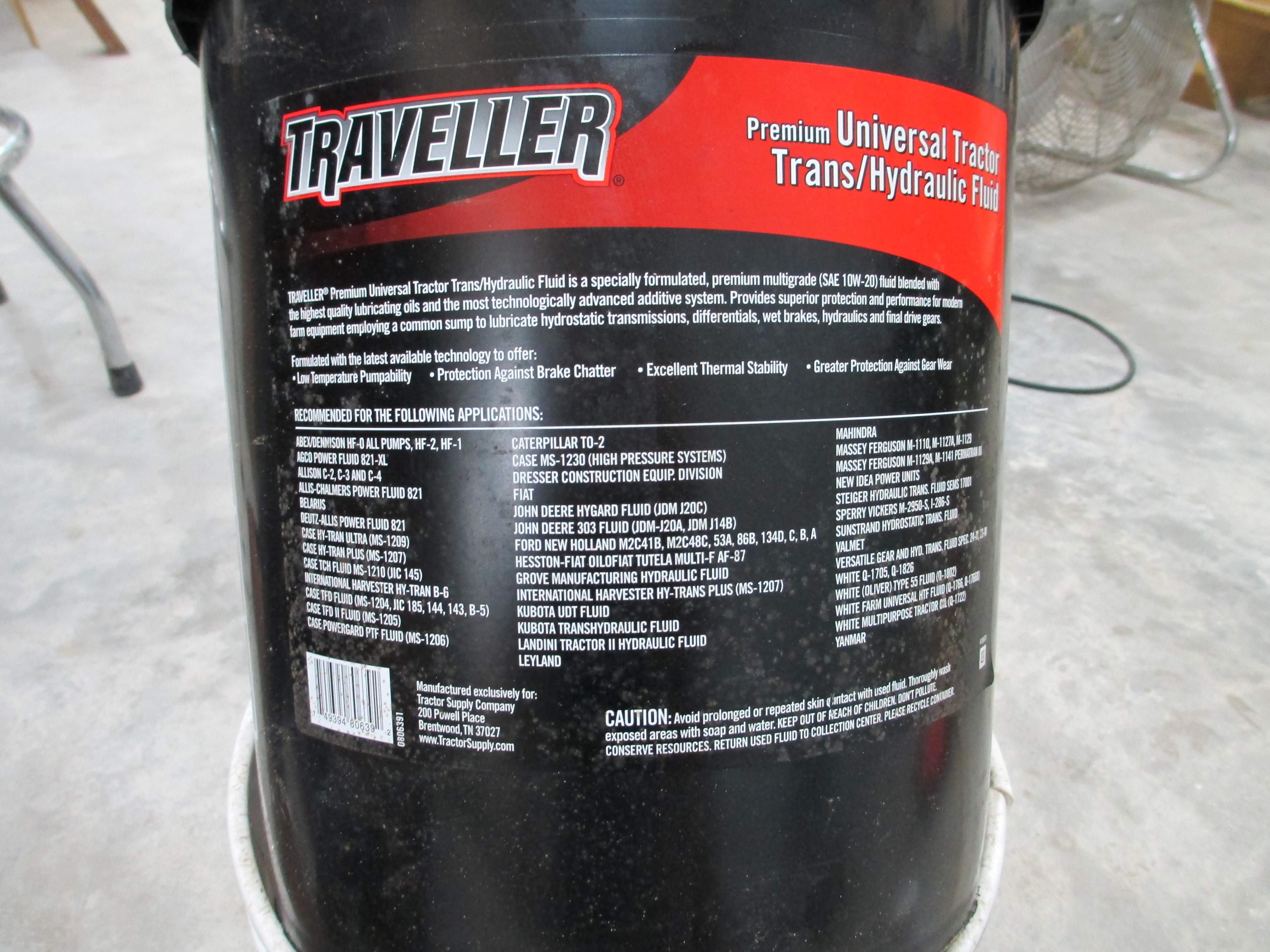

The one below is not recommended for transmission. Ford 134 is both for transmission and Hyd system. is this like yours only in 2 gallon jar?

No, this is the one I used and I did some looking around and from what I can tell it is Ford 134 compliant.
Where does it say Ford 134? I did not read it on the specs.

It doesn't say on there website but I searched for that oil and found other conversations indicating it was ford 134 compliant.

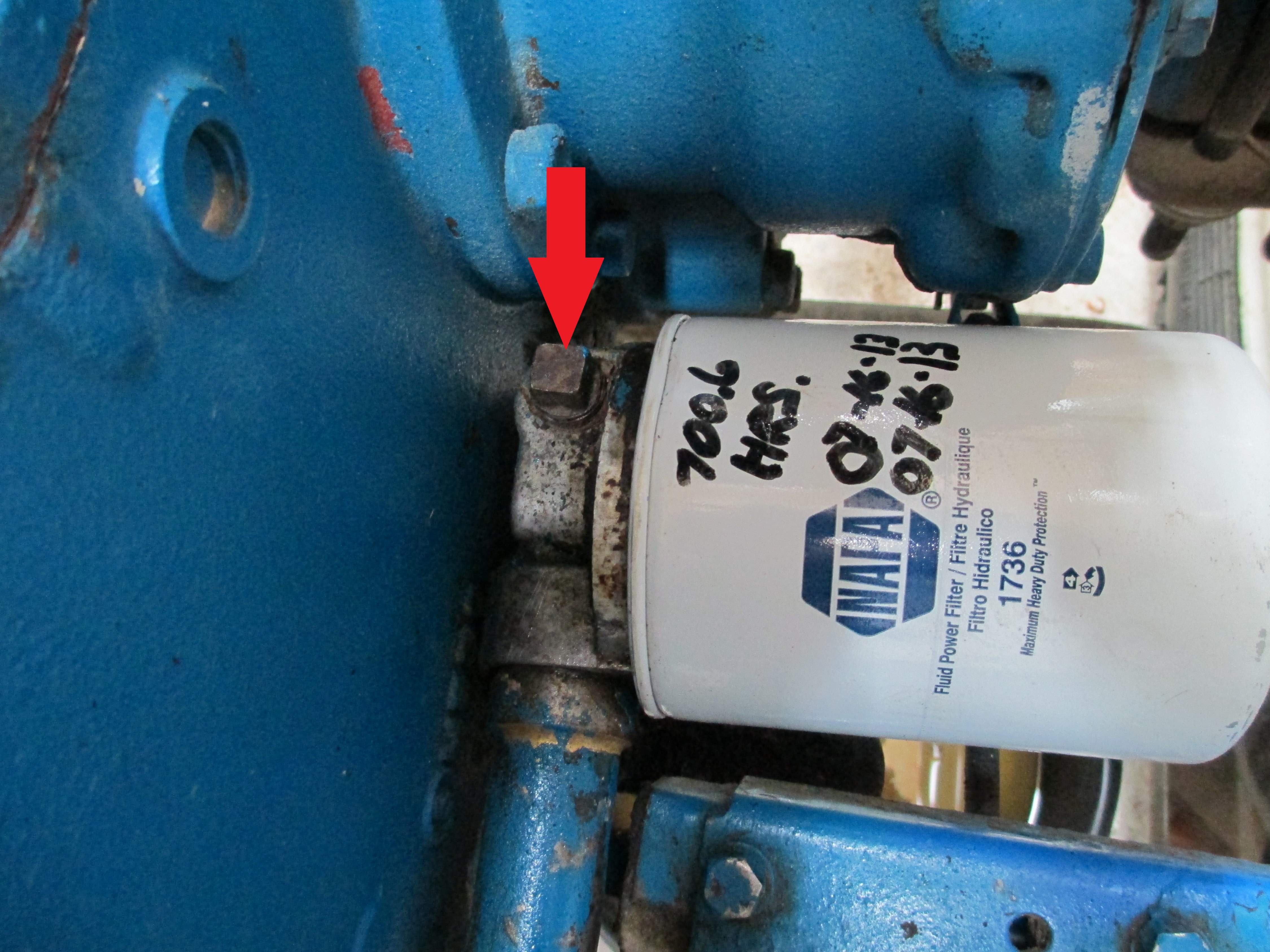

Heck I was thinking of putting the old filter back in. I know it worked and it was the only thing changed except the oil.
Before changing the oil, if I had the handle up, the box blade would be all the way up before the engine started. I don't really know if this indicates anything, but this why I thought the pump was in pretty good shape.
Here is a picture of the plug
I agree about air in the system, and thought about loosening the plug in picture to maybe bleed the air, but was unsure if it would help.
Mike
Here is a picture of the plug.
