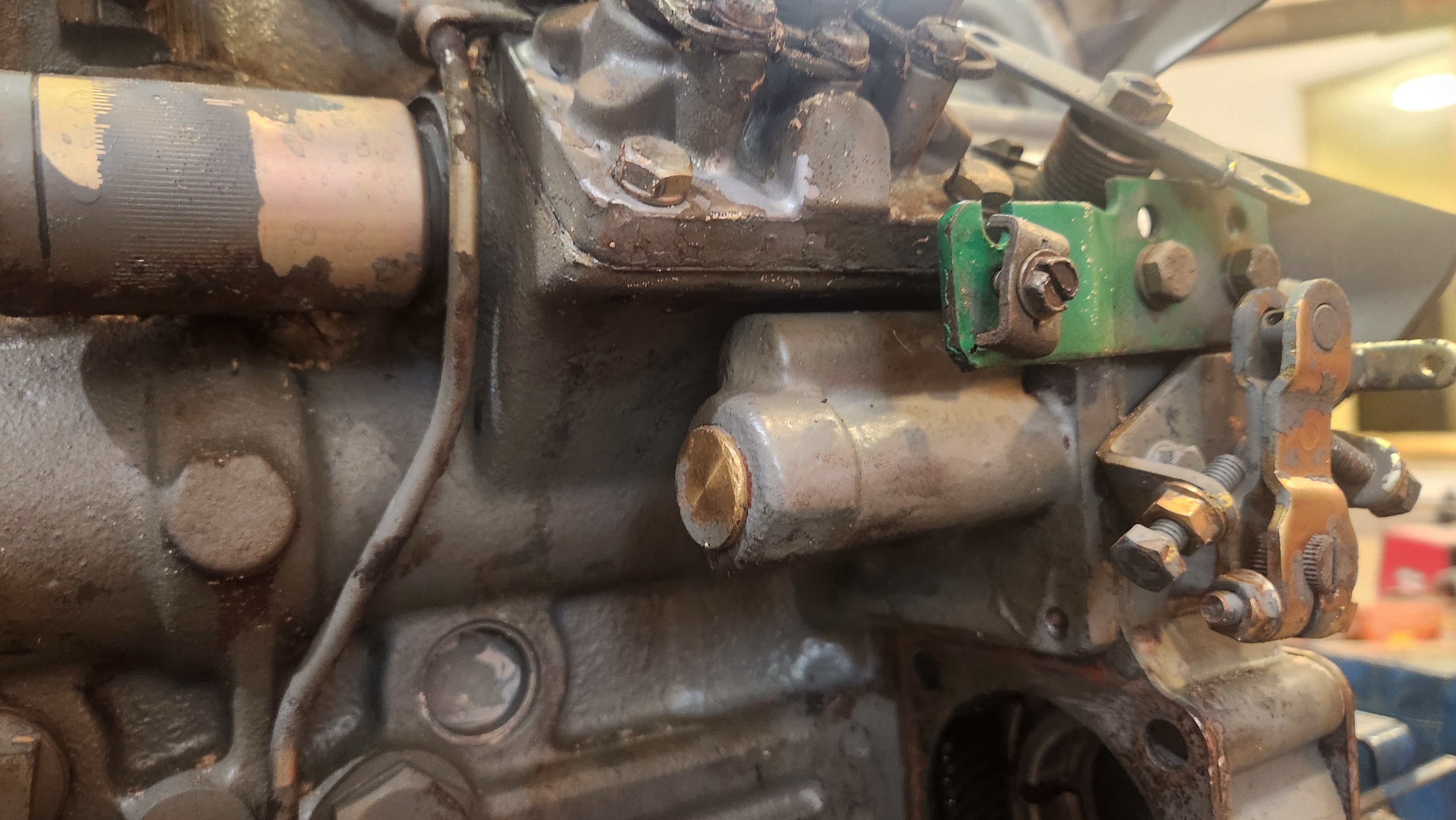

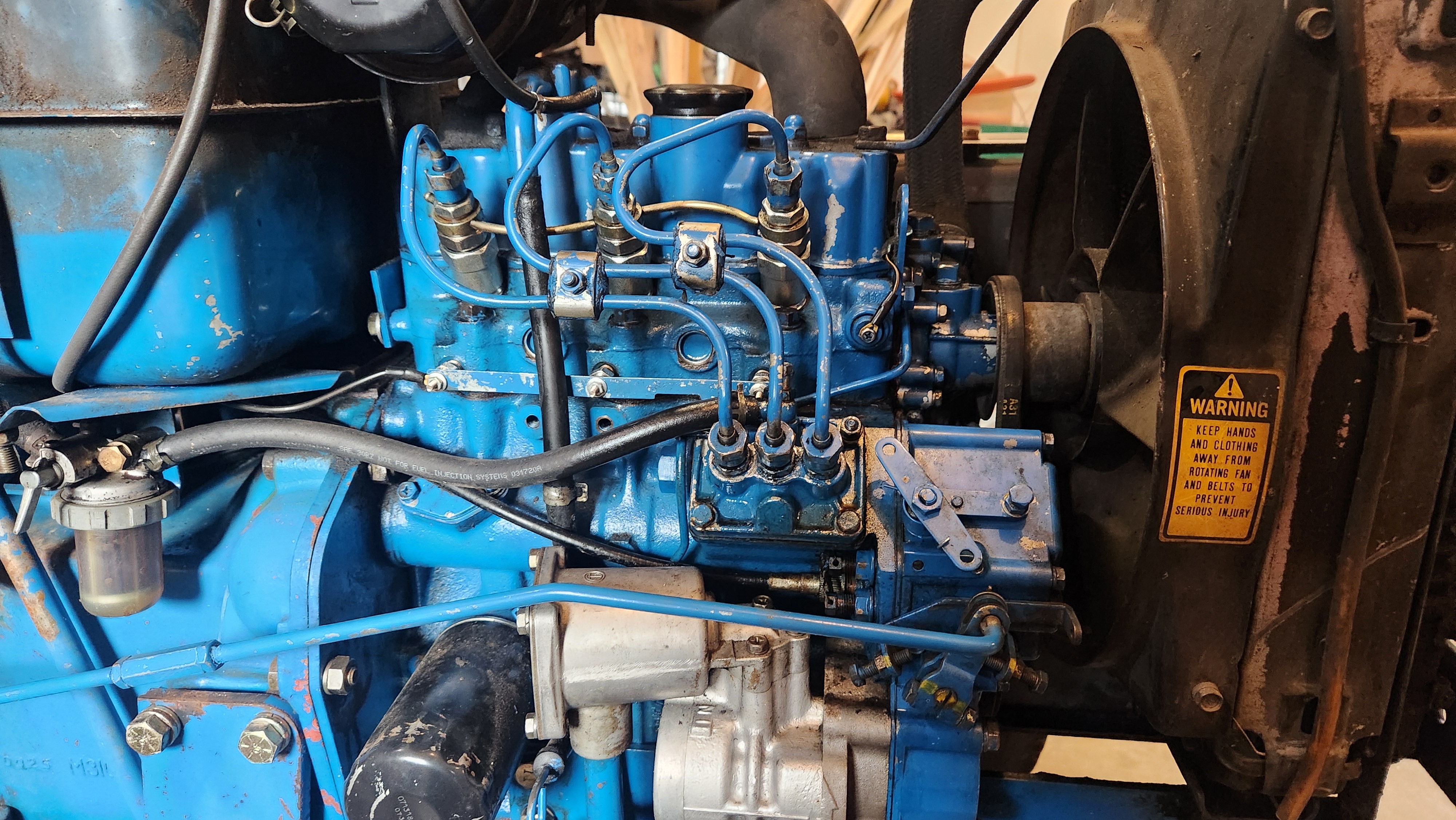

I am in the middle of replacing the engine on a Ford 1210. From the research I did, it looked like a Perkins 103-10 should bolt right in. Everything was going pretty good till I tried mounting the hydraulic pump. The new engine has something in the way. Is there a different hydraulic pump that would fit or an easy way to modify the existing one?

   / Ford 1210 engine swap
I would prefer to keep the original pump location. From what I can tell, the old engine had the fuel adjustment and speed limiter screws in this location with wires through the heads to keep them from being messed with. I am guessing that the thing on the new engine must be something to do with the fuel adjustment. I am hoping it is just a dry screw inside and I could just cut the end off the thing with the brass plug in it but wouldn't want to consider doing that without knowing what it really is.
   / Ford 1210 engine swap #5

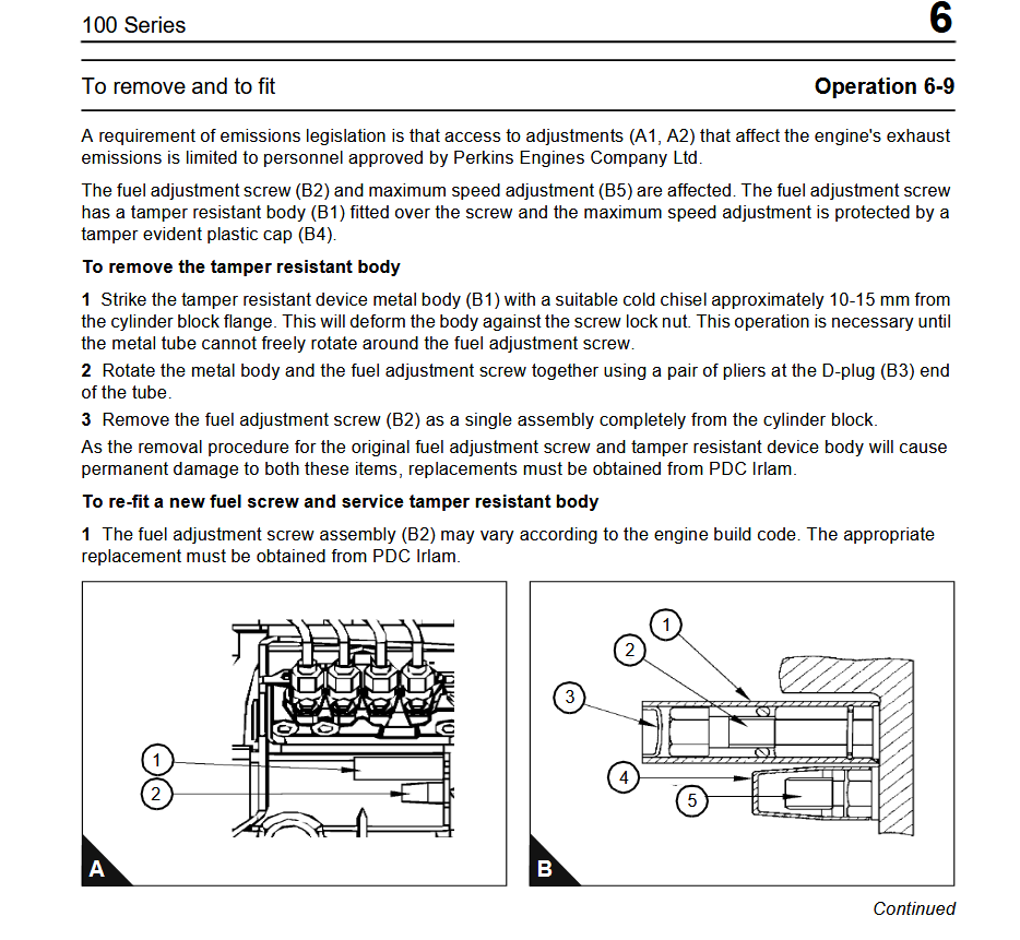

That part seems to be related to the fuel screw and max RPM screw, accordingly to the manual.
