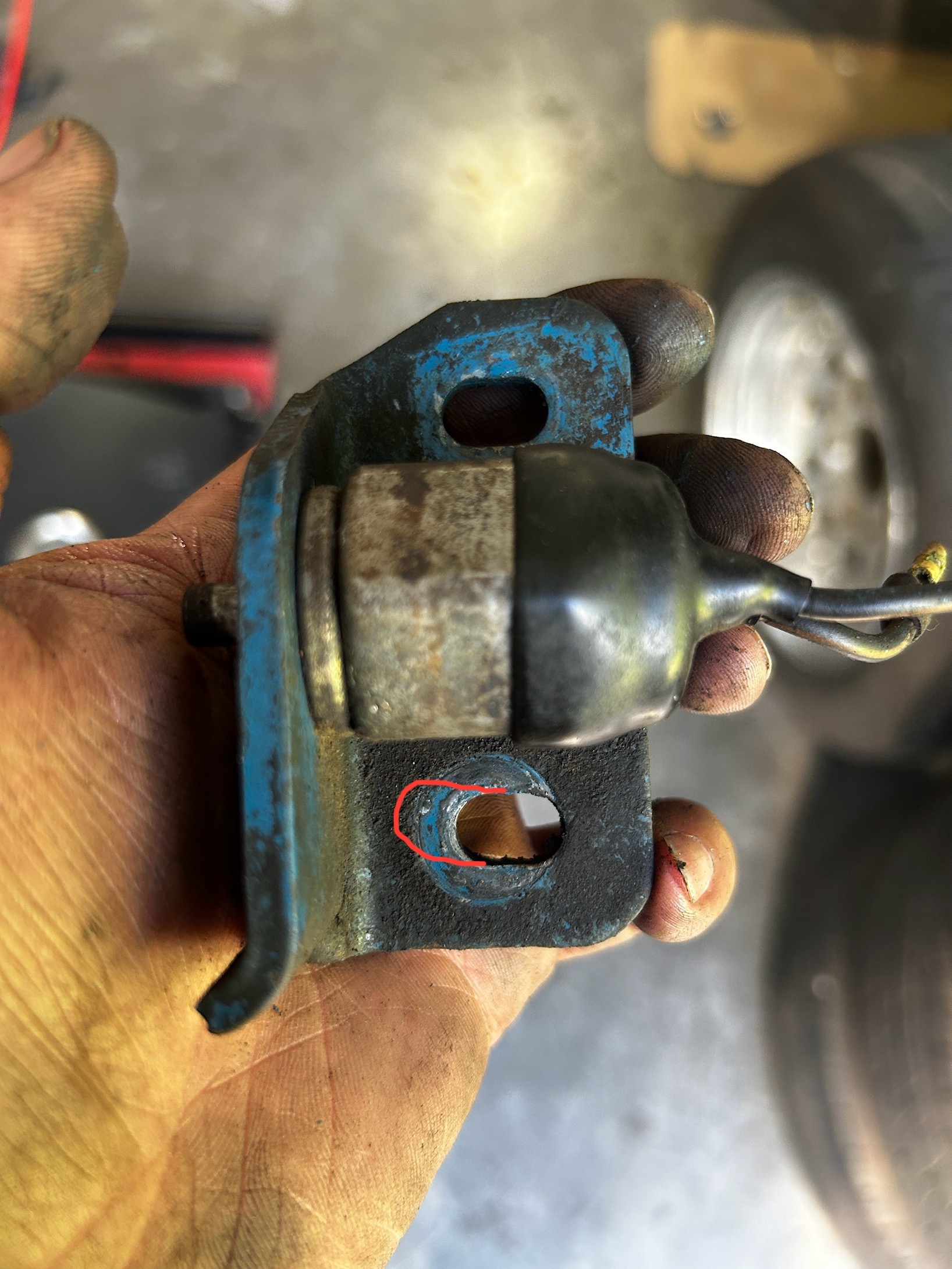

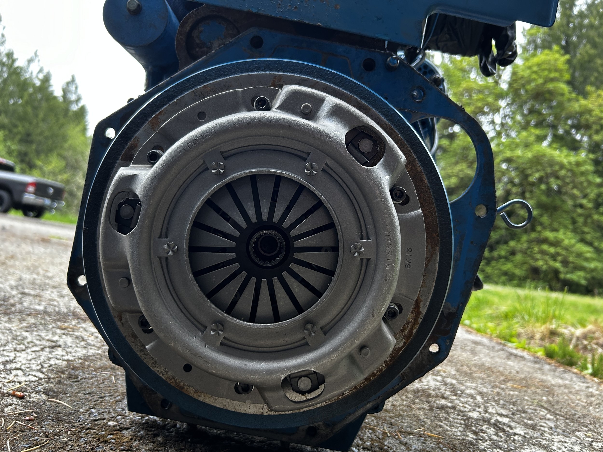

I just put in the Nissan pressure plate and it does work. Had to slightly notch out the mounting/adjustment hole on the clutch pedal stop to get more pedal throw. But it works great now. Also had to notch the pressure plate mount holes. They were slightly different.
