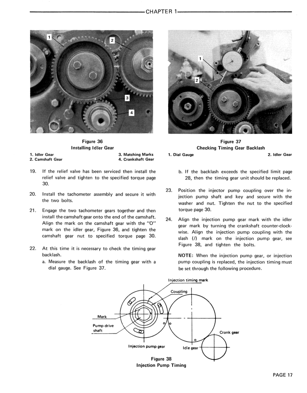

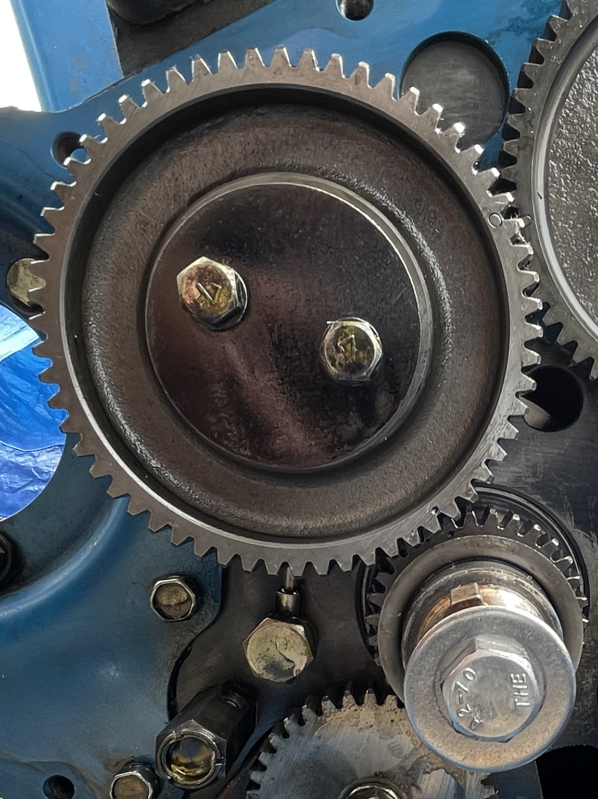

I hope someone can help explain;
I am installing an injector pump into a Ford 1000. (please see attached manual page 17 and 18). I rotated the crankshaft till the marks matched and are lined up between the crank shaft to the idler pulley and the other marks are lined up between the idler and the camshaft gear (see attached picture).

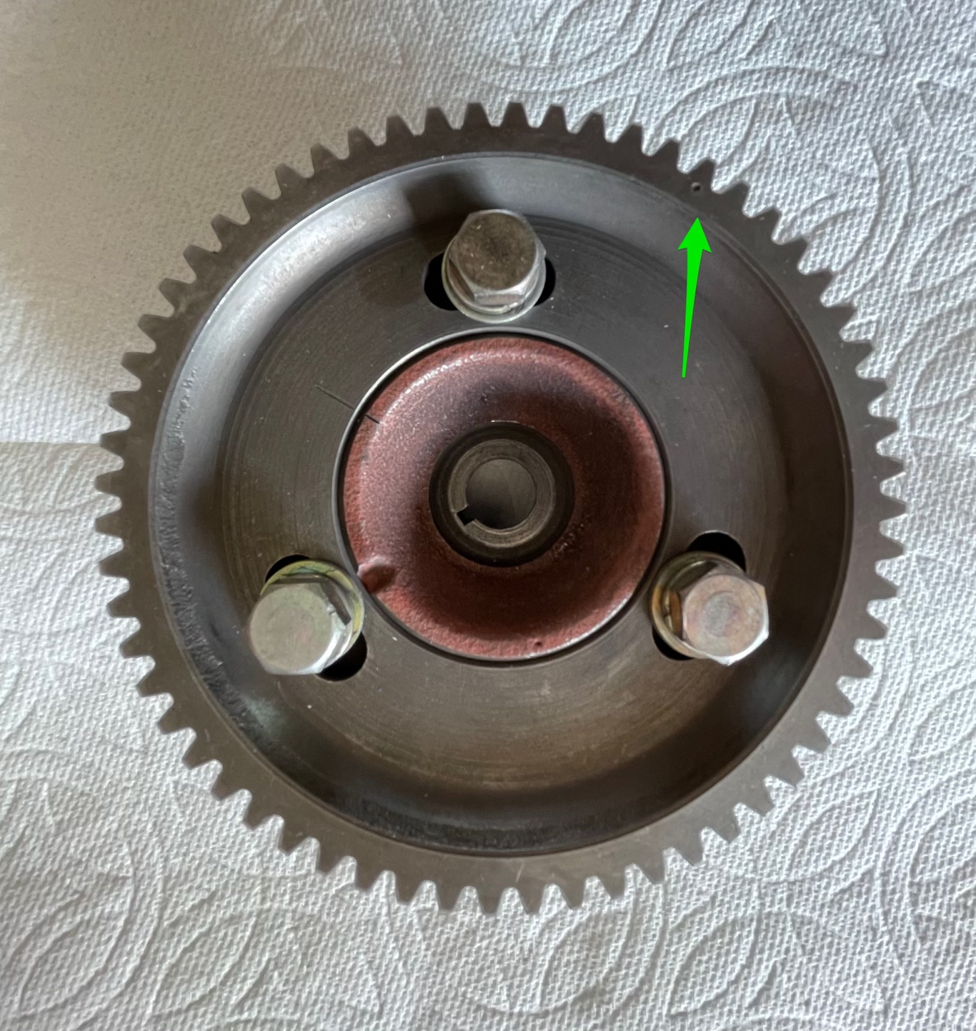

Seems now we just need to align the injector pump gear to the idler ? But there are no more marks on the idler, both are being used; one for the crank and one for the camshaft.

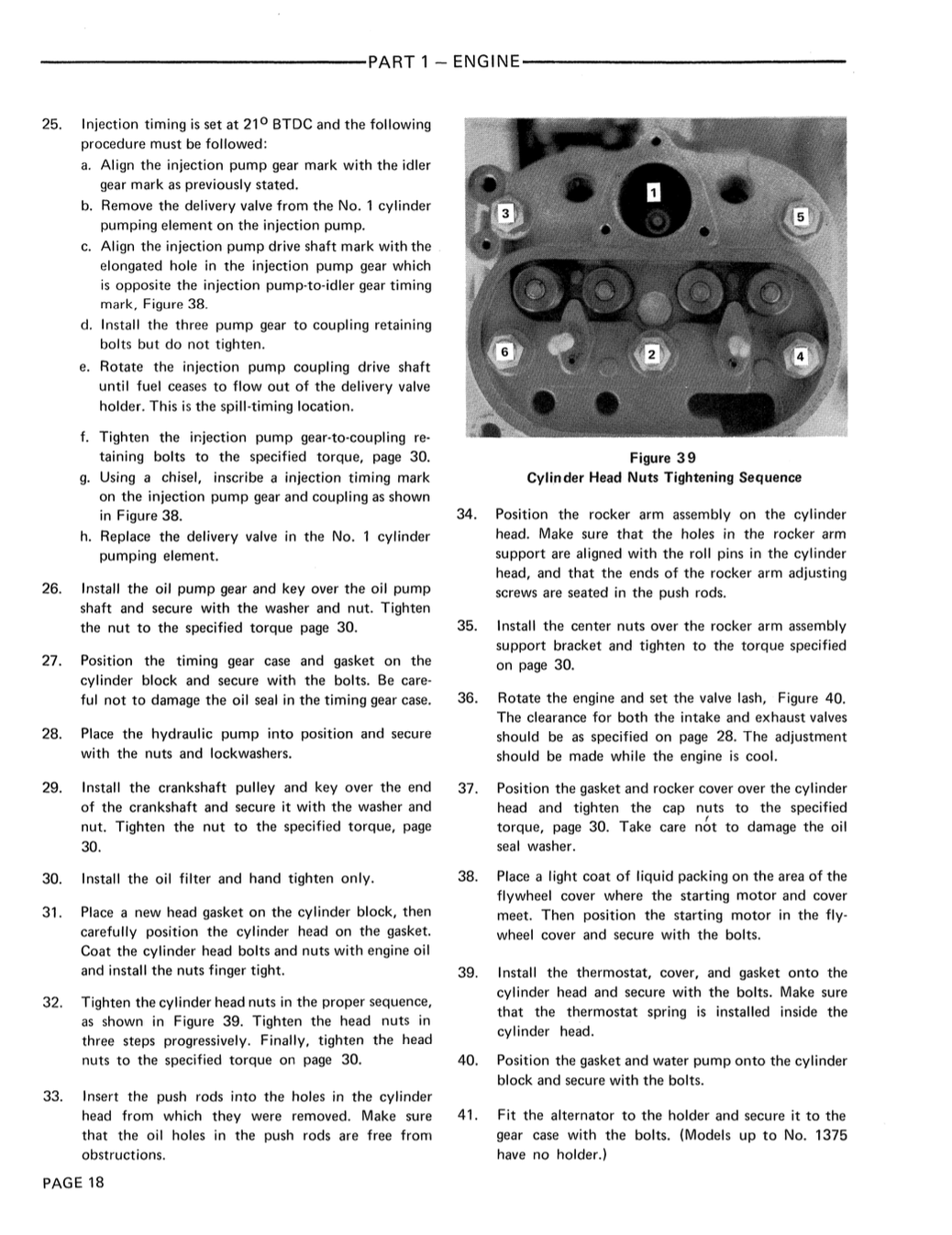

Perhaps if I rotate to the 21 BTDC as it appears to suggest on page 18:25 this will free up a mark on the idler ?
And I am not clear exactly what we are doing looking for the spill-timing location as in 25:e
Perhaps someone has done this, figured it out, and can help explain :)
Thanks you in advance (no pun intended)

I can't zoom in on your idler gear picture, but there looks to be a mark at about 11:00. The spill timing is when the plunger in #1 is at the highest point in the pump chamber, so that would be the 21 deg

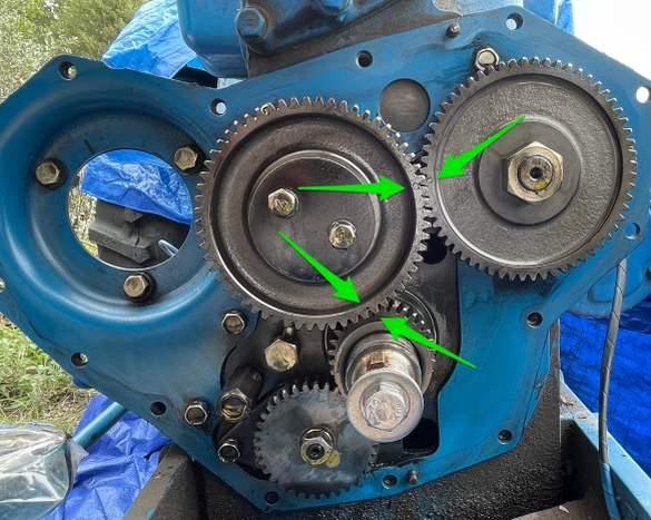

Thank you TractorTech for responding to this post. Attached is a zoomed in pict of the idler gear. I do not see another mark. But I think that is ok because what you are saying now makes sense. And I think it lines up with the manual.
If I am understanding things correctly, the goal here is for the injection of fuel ( The spill timing is when the plunger in #1 is at the highest point in the pump chamber) into the front cylinder (#1cylinder) when it reaches 21 degrees BTDC and when it is in the compression stroke (intake and exhaust valves closed), not the exhaust stroke (intake closed exhaust open)
The picture I posted with the cam, idler and crank gear marks all aligned I believe is not 21 degrees before top dead center. It is simply the marks necessary for crank and cam gear alignment. Tomorrow I will rotate things to the 21 degrees as described above. I am hoping it moves the idler gear to a new position, such that when lined up with the pump gear mark, the injection pump #1 chamber will be at its highest point as you discussed.

Before u get to carried away with this (a lot of work for nothing).
Spill timing IS NOT when the plunger reaches the highest point.
Without try to explain it.. look at the tappet in its bore.. your start of injection
(Spill Timing) is actually gonna be when your tappet is barely past flush on it’s up stroke.
U set your engine on 21* BTDC..and spill time the pump..
Cant u Google instructions to spill time an inline pump.??
The pumps control rack HAS TO BE HELD IN A CERTAIN POSITION FROM FREE..
If it’s left free, it’ll either be at starting fuel(21mm) or shut off fuel(0mm) and neither one will be correct..
It should be held 1/2 way in between..
Sorry to b the barer of bad news.. just when u thought u had a handle on it..

One step I think ur getting confused.. u DONT take the DV out... u take the CENTER of the valve out, along w the spring... and screw the holder down and tighten..
Move your control rack to the center of its travel..& hold it there thru-out the spill timing procedure..
What u should do is, do a “dry run” on the work bench..
Lock the pump in a vise, careful not to clamp it on a sealing surface..
Leave the side cover off so u can watch the tappet moving up & down..
Remove the CENTER OF THE DV AND SPRING.. & tighten the holder..
Move the rack/ segments to the center of their travel and hold them there.
Now find some way to put fuel into the pump..
U HAVE TO find the correct rotation of the pump..
Look on the name plate and you’ll see a “R” or an “L” in the PES series of numbers..
Thats the rotation of the pump, LOOKING FROM THE FRONT OF THE PUMP. (standing in front of the pump)
Now squeeze the container u have fuel in & at the same time rotate the drive shaft..
The fuel will flow and then shut off.. u want to find the position of the drive shaft where the fuel just rises to the top of the holder.. just keep blowing the fuel off the top of the dv holder.. seeing u don’t have a drip tube..
That’s where u want it to be..
Now just for kicks, look at the tappet.. is it where I said it would be.?? (Dam Close)

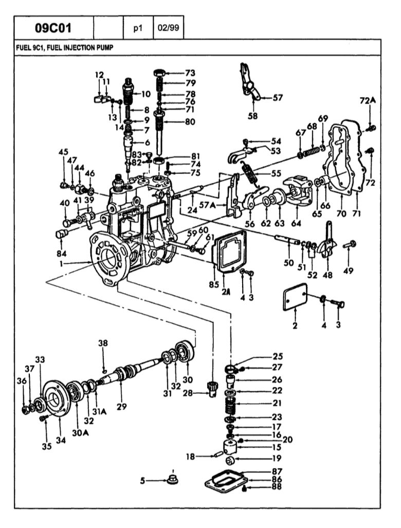

"WHERE did you find a pump ? " I contacted tractor salvage yards.
But like I said the bearings were shot and it looks like it had some water sitting in it ie no lubrication. The bearing was powder. I don't see anything in the manual or specs on how it is lubricated ... so your 5 oz engine oil is probably right.
The one I got is missing part # 80 and the associated pieces (see attached drawing). Not sure exactly what it does or how important it is? Does the one you have in the shop have these parts .... If so, maybe you would be willing to sell what you have :)

/ Ford 1000 injector pump timing #12
Rick.. #80 is very important.!!
That’s what sets the fuel and the torque settings..
I can take a measurement of the screw and u can use a solid bolt.. if u can find 1 that long.. with the correct threads..??

Did you get the timing marks lined up? See note 24 on instructions

The extension of the screw like u measured yours is
2-1/2”.. hope that helps.
