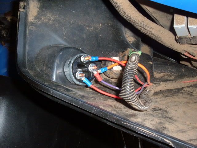

Thanks for info, but do both reds go together?
NO. Read further back through the thread and see what the switch wiring is.
