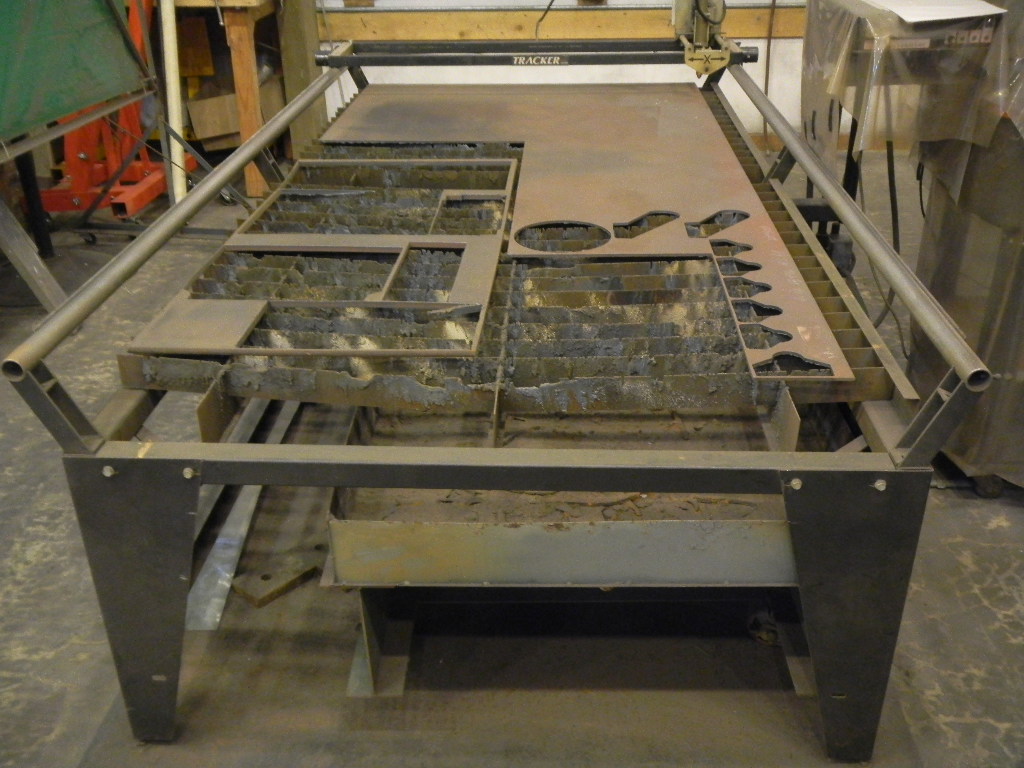

Remember that there are advantages either way.....with water tables or downdraft tables. Here are a few points to consider:
- Water table is very effective at eliminating smoke and fumes....is relatively inexpensive to build and maintain.
- Best fume control is with water in contact with the plate being cut....as water gets lower, fume control is diminished.
-Water contacting the plate affects cut quality with a rougher cut edge and higher chance of dross. To minimize dross and roughness, lower the water...at the expense of fume control.
- Water splashes on the plate and the machine...staining and rust are the result.
-Many shops in cold climates can be below freezing at non occupied times. Anti freeze cannot be used as it will react with the plasma and create potentially hazardous fumes, therefore the water in the table should be protected from freezing....stock tank heaters work well.
-Downdraft tables must be ducted through a welding filter, or blown outside if permissable.
-Cut quality is best with a downdraft table.
-The air flow for a 4 x 4 table is typically 3000cfm to 5000cfm to completely remove fumes
-No freeze problem, but when the blower is blowing outside....heat is also being removed from shop.
-No water staining, better edge smoothness, minimal dross formation.
I have one table with a downdraft and one with a water table. I prefer the downdraft for cut quality and stain rust issues.

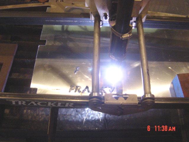

You Might want want to throw in what can happen cutting Aluminum on a Water table. ( Ka ooom ) :confused2:
/ For those with a Plasma cutter... #46
Really! I don't think I've ever heard of this. Please tell us more! I've cut a little aluminum, but not a whole lot. I can't remember if I cut over water or not, I think I did:confused2:. I looked through my pictures, this one is cutting over the tank, but looks like the tank is empty.

In my 35 years of experience with large industrial shops as well as small fab shops....there have only ever been one or two issues with cutting of aluminum over a water table. This myth has grown way out of proportion to the facts!
When you cut aluminum over water (water is commonly used to trap and control smoke and fumes from the plasma cutting process) the ejected molten material from the plate is blow down into the water where it cools and solidifies. This material mostly consists of aluminum oxide particles....these particles tend to absorb oxygen, and water (H20) is comprised of oxygen and hydrogen. When you remove oxygen from water....a small amount of hydrogen is left over.....which rises in the water bed (table) to the top....the disipates in the air. Even in large industrial applications that cut hundreds of tons of aluminum daily....this small amount of hydrogen is generally not a problem.
If the water table is of a design that has brackets or framing that allows some of the rising hydrogen bubbles to become trapped.....over time a rather large pocket of hydrogen could collect....and with a spark...certainly could produce an explosion. Another scenario is that you cut aluminum all morning in a busy shop, load a new 5 x 10 sheet that happes to be bowed up a bit in the center....then go to lunch. While at lunch the aluminum oxide particles from the morning's work are releasing hydrogen bubbles....which rise and become trapped under the plate......return from lunch and fire the torch..and you can have a hydrogen explosion (usually however it is more like the "pop" of a firecracker!)
Most industrial water table manufacturers build their tables so that rising bubbles cannot be trapped.....also build he tables with aerator pipes (pipes with many holes with compressed air) and allow air to rise in the water...diluting any hydrogen that could become trapped under the plate.
Small entry level cutting tables or hand cutting generally cannot cut enough aluminum to cause an explosion issue!
