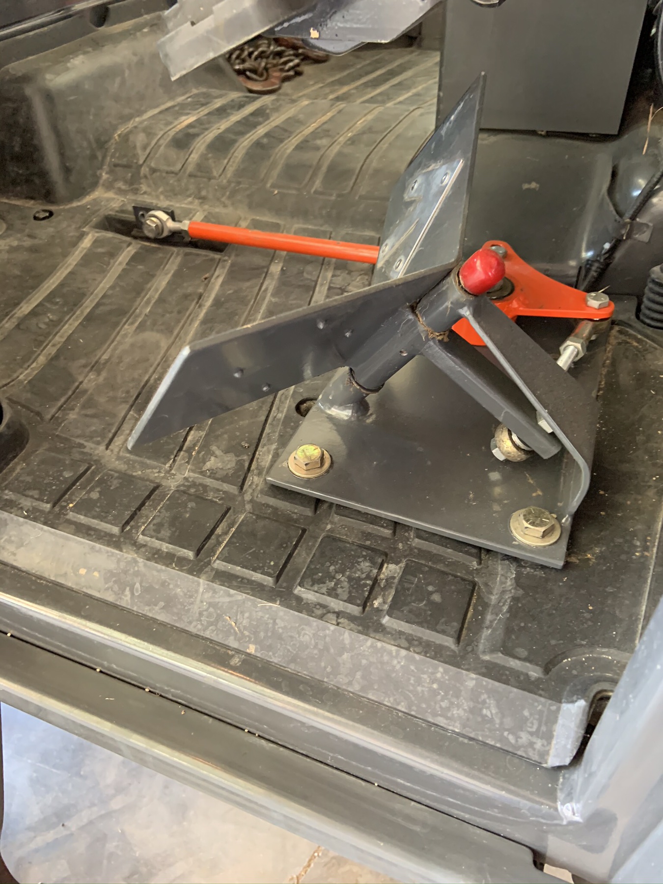

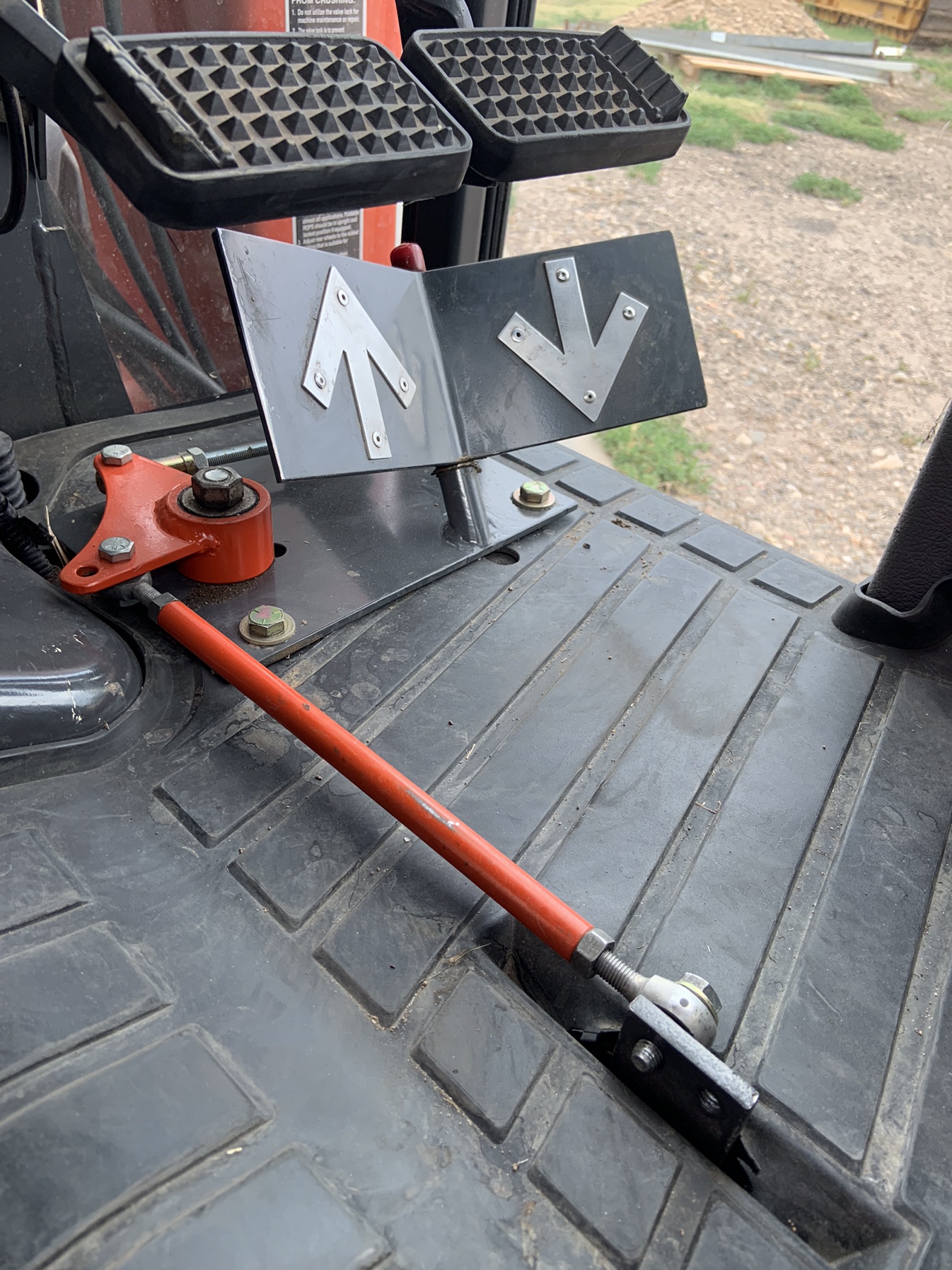

I love my Kubota L3430 tractor but hated the treadle pedal. I broke my right foot several years ago and even before it was hard to work the pedal for me.
I am one that has to mod everything and this is what I came up with done it a couple of years ago and it works flawless. Just touch the pedal with the tip of my boot, pivot heel on floor.View attachment 661921
Nice work, both the engineering and fabrication! Well done!

Thanks for all the kind words, I pride myself on doing nice work. But sometimes I take forever to get it done.
Here is a photo of the back side.View attachment 662187

The OP has good pictures of his conversion for anyone wanting the same. Clean, clever engineering and fabrication. SS or aluminum tread plate for the arrows would look nice.
I'm impressed with the mod but like some others I have not only gotten accustomed to the pedal on my L2501, I actually like it and wouldn't change it to a two pedal system if I could.
