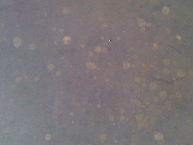

Around here you can only go for $4000 in small claims. I dont think I can hire anyone to fix this for that.
/ Foam insulation removal #23
But, wont it still look like bird poop spots everywhere even after sanding when I seal it?
Yes, but stained concrete looks marbled anyway. I don't think you'll notice, but I'm not that particular. Did the contractor ask if you would be staining the floor or did you tell him. We don't spend time covering floors that will have something over them much like sheetrockers don't protect from mud spills and painters don't protect from overspray. Having said that we do ask and write on the studs in the room if it will have stain or have flooring.
In CA I can hire day labor for $12.50/hr, in Grants Pass $10/hr will do.
I suspect Kansas is closer to $10. You can probably rent a floor sander, buy all the supplies necessary, and still have enough left over to pay for 200 to 300 hours of labor. That is a powerful lot of floor sanding.
But, I would give the guy who did it a chance to clean it up first.

Are both buildings needing to be cleaned? I would assume the contractor has already scraped the floor and removed debris leaving only the residue. If so a floor sander with a few 80 grit screens will clean it up. You will probably go through 10 screens and 2 or 3 pads. After it is sanded blow the dust out and wet mop it. Once it's dry use an airless sprayer to apply the seal. I did this axact same thing on my personal 30X50 building. My rational behind not covering the floors was because there was already so much trash and sheetrock dust and mud on the floor that it wouldn't matter. We always seem to cut corners on our own projects. After scraping the concrete it took 3 hours to have it ready for seal. Everyone who sees the floor loves it and wants to know what stain we used, which we didn't. I'm not saying it won't take work, but it isn't hard or expensive to remedy. If you want pics of the end product I can send them.

NO he hasnt done any scraping. He tried buffing it off but stopped instantly when he saw it was only burning it into the cement. The pic in post 15 is about 3' square, there's a lot of drops. When I get time, I might try sealing a spot we have scraped the best we can just to see if it will accept the sealer.

The overspray must be removed by scraping first. If you don't it will cause uneven sanding and you will go through hundreds of screnes. You can purchase floor scrapers from paint or construction supply stores.

Here is after a wide razor blade and a small blade. This stuff is quite the mess to scrape but I'll get it. Hopefully
