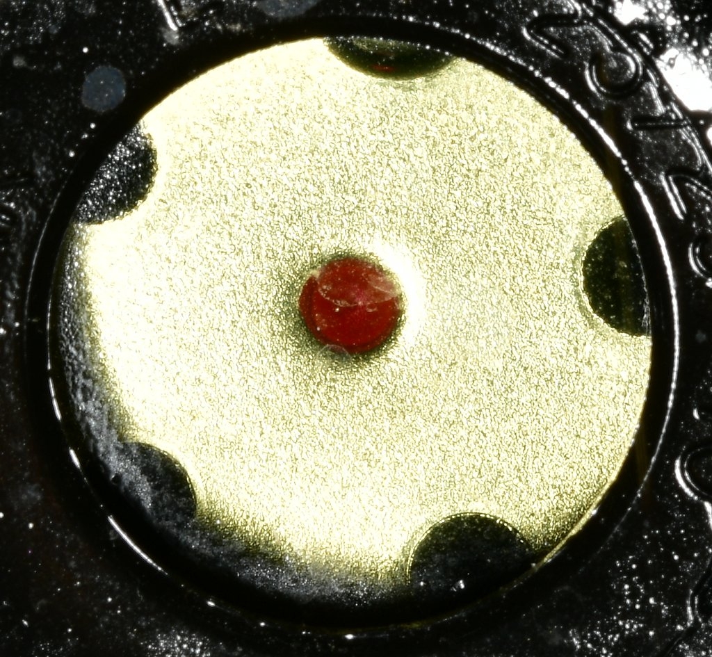

OK. So I searched through the pictures I took of the tractor when I first got it and parked it under the carport. That was 09-09-2023 or thereabouts. I was able to find a pic I took of the rear end and was able to zoom into the hydraulic fill sight glass reasonably enough. I just went outside a little bit ago and tried to duplicate the angle and framing of that sight glass as it is right now.
How much difference do you see in these two images?
So, which situation is most likely? (1) The hydraulic system was not filled enough to where there is an indication in the sight window, or (2) The hydraulic system was overfilled from the dealer to the extent that when the above mentioned attachments were added, it did not drop the fluid level down enough to show in the window. Or (3) any better idea that anyone has?

Is it possible to stick a clean wire down in the rear axle through the fill port (makeshift dipstick) to see where the level actually is?

I can’t tell by the pictures when I zoom in I can’t see them well enough. Auto parts store will have some inexpensive dye you could add to verify or the dipstick idea.

When I was supposedly topping off the hydraulic fluid, I was assuming that there wasn't all that much fluid used for the devices I put on the tractor. So I poured slowly into the funnel, watching the fill window closely the whole time. I had thought the level would just be barely at the bottom of the window, so I wanted to pour slowly enough just so I wouldn't overfill it. At no time did I see any sort of flid line in the window. I have machines that also have similar sight windows in them, so I am familiar with their use.
Thinking that maybe it was possible that the hydraulic could be more than a gallon short of being full, I ran out and bought another gallon. When I dumped the entire contents of the second gallon in, again watching the fill window closely, with no sign of a line of liquid in the window, THEN I started getting concerned.
It is not like I could have reasonably missed the fill line. Unless there is such a small difference between being almost full, and full, that such a threshold could be crossed with slow pouring the hydraulic fluid in at the blink of an eye.

You want a closeup? Well I can give you one from a pic taken on 09-30 using my big Nikon.

As it's been suggested, get some dye for the transmission oil, John Deere sells it too and not expensive either (shocking, right?). Transmission fluid is very very hard to see on a sight glass, so with some dye it should clear all the guess out of it.

You feel better about yourself now. The red indicator is fuzzy it looks like it has fluid in it but so is the rest of the picture to me. New hydro fluid is straw to almost clear so I can’t tell by a picture. Also welcome to my ignore list.
I'm going to say it's "#2 Overfull".
My last hydro fluid was so clear you couldn't see any tint in it at all. Looked like water. My current fluid (just changed) has a tint in it, looks like a very weak ice tea. Your pictures look like what my old fluid looked like in my sight glass. I think you're over full. Probably going to be fine, just stop putting more in.
When I changed my hydro fluid at 300 hrs of run time, it looked just as clean and clear as the day it went in. I would expect that yours will stay just as clean also.
At this point, I don't think you need to worry about "ever" adding more fluid during normal operations. Just measure what you put in next time you service it and change fluids. I doubt you will get all the fluid out on a fluid service change, but most of it. So when it says (example) "10 gallons", you may not get all 10 gallons of the new fluid in the trans before you see the mark in the sight glass.
TLDR; I think you'll be fine as long as you stop adding fluid.

I only have about 8 or 9 hours on the clock, so at the very least it will all get drained out at the 50 hour mark. Anything destructive that can come from driving the tractor being overfilled with hydraulic fluid? I have sent an email to my dealer, but haven't heard anything back yet.
I am surprised that if it is actually 2 gallons overfilled, that fluid wouldn't have started coming out of the fill hole.
As for the suggestion about dye, how much dye is needed to make a visual impact in a 9.3 gallon reservoir? Hmm, seems I have some UV leak detection fluid around here somewhere. Wonder if that would work?

This is the dye I use, it's very concentrated. Take one of them drip counters you get from a medicine bottle of eyedrops or similar and just give it a small doze of that. Then run your tractor for 15 minutes to circulate the fluid. If you have one of these fluid extractors like a large Mityvac just suck out the extra. John Deere Hydraulic Oil Dye - MT3668

OK, sounds like this is worth a shot. Got it on order. Thank you for your help.

In the meantime, any danger running the tractor if it might be over filled?
/ Fluids for T474HC? #36
You should be fine. I probably had AT least two gallons over for 6 months plus before I got a hold of the dye and corrected the level.

Some people even run it high on purpose because of slopes. No problem.

Well, that is good to hear about overfilling. What about the reverse? The fluid level being very low? Any signs, audible or otherwise I should take as a warning?
/ Fluids for T474HC? #39
If it was too low you would have noticed it when it sucked air into the system. The only other thing would be the oil would run a little hotter.
If you are concerned, just use a piece of wire or something clean and stick in down your fill port as Seven Gables suggested. If it is wet when you pull it out you are good. You may can even see the level through the fill port with a light at this point.

Talked to my dealer today. He asked about the FEL and whether I had the cylinders extended or retracted. Evidently the fluid level in the sight glass can vary based on how much hydraulic fluid is in the cylinders. I had all the cylinders retracted, so maybe that was reflected in the sight glass window as being "over filled". He said he didn't think being overfilled 2 gallons was a real big concern, if that is the case. I talked to the tech there as well, and he said he personally filled the hydraulic reservoir himself. Anyway, the owner said not to worry about it and there shouldn't be any problem. In any event, he would have my back since I made him aware of what happened.
