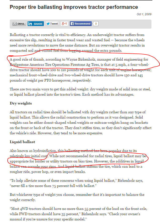

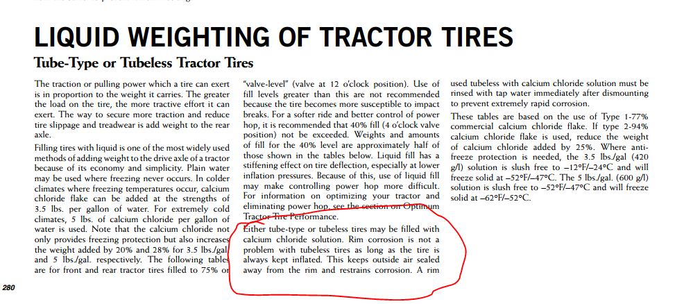

How many members of this forum do you think perform tillage operations and are concerned if their tire walls stiffen and they don't have exactly the correct traction when what they need is STABILITY?
This is what I found on one of Titan's sites. http://www.titanstore.com/pdf/TireInfo.pdf
If tire manufacturers are against liquid ballast being added as you state then why do all of the tire manufacturers publish a chart outlined liquid capacity of tires?

The question to B&D is a valid one, and while he didn't provide direct evidence, Jim did. It is right between the 2 circled portions on the Titan page under the paragraph for Dry Weights. It states clearly there, that traction is enhanced with proper deflection (caused in turn by inflation pressures). And for radial tires, it says they should always be dry. I found some similar verbiage on a link to a Nebraska Tractor test document.
However the goal must be stated in advance. If you are after stability, fluid is best. If you are after traction, get a radial and go with cast. At this point, I've forgotten what the OP was after. :D
