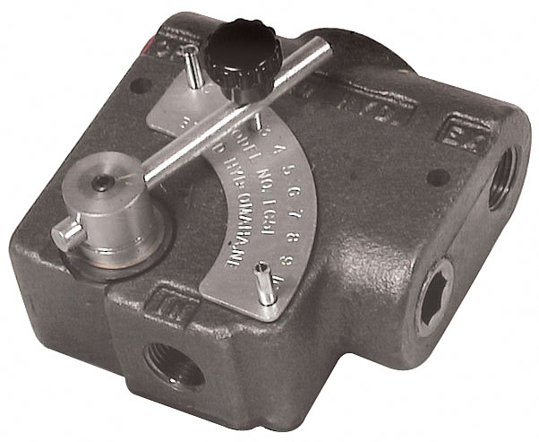

So I bought a wood chipper today. Its a Tytan kc125
Been modified to a hydraulic feed My question is the way he had it plumbed to his tractor was....... He didn't have remotes on the back so he used the curl function from the FEL The flow control has 3 hoses one to in feed one to reverse and 3rd hose for tank return. The pic shows the IN EX 9tank return and the CP output. I want to get rid of the 3rd hose. Let me go back a little . The 3rd hose was just placed in the rear of the tractor where the fluid is added for oil changes. If I cap the outlet (EX) will the flow find its way back to the tank?

You have the IN port, the CF= controlled flow port , EF= excess flow port.
I don't believe the excess flow can be blocked as that is the port that sends the excess fluid to tank.
It can be blocked in a restrictive situation , where the pump is pressure compensated pump or a closed center hyd system.
The flow control valve itself does not reverse, the curl circuit reverses..

blocking the ef port is not a good ideal. I assume your control valve for your curl function does have a built in relief. The excess flow has to have a way back to tank. Blocking the ef port will cause the fluid to run over the relief on your curl function valve, cause excess heat, and probably damage the valve over time. I can only guess the flow control was added to the system to control the speed of the chipper feeder. Not sure how well the setup worked. Unless the there is a seperate control valve mounted on the chipper to control the direction of the feeders, I suspect it controlled the flow and speed in one direction only. . If there is a separate control valve on the chipper, and the flow control is mounted before the valve on the pressure side, you can Tee your flow control EF port into the return to tank port of the chipper control valve to get the excess flow back to tank.

Aaron, the way you are suggesting is the only way he would be able to get his flow control to work in both directions. A flow control will only work in one direction and if it is placed after the valve, it would allow full flow in one direction and a controlled flow in the opposite direction. If he places the flow control before the control valve to control flow into the valve, it would effectively control flow going to the valve, then the motor in either direction. He would still have to tee the EF to the tank side of his control valve, ( or back into the fill port like it currently is) in order to get rid of excess oil. As for just plugging the EF port and the rest of the oil waiting its turn, aint going to work, at least not well, and most likely causing damage to other parts of the hydraulic system.
/ flow control #10
When the lever on that valve is at 1 or left, all the flow is going to EF, to tank or another circuit.
As you push the lever to 5 or 8 to the right, you send IN flow to the CF port and if you are full lever, EF gets nothing.

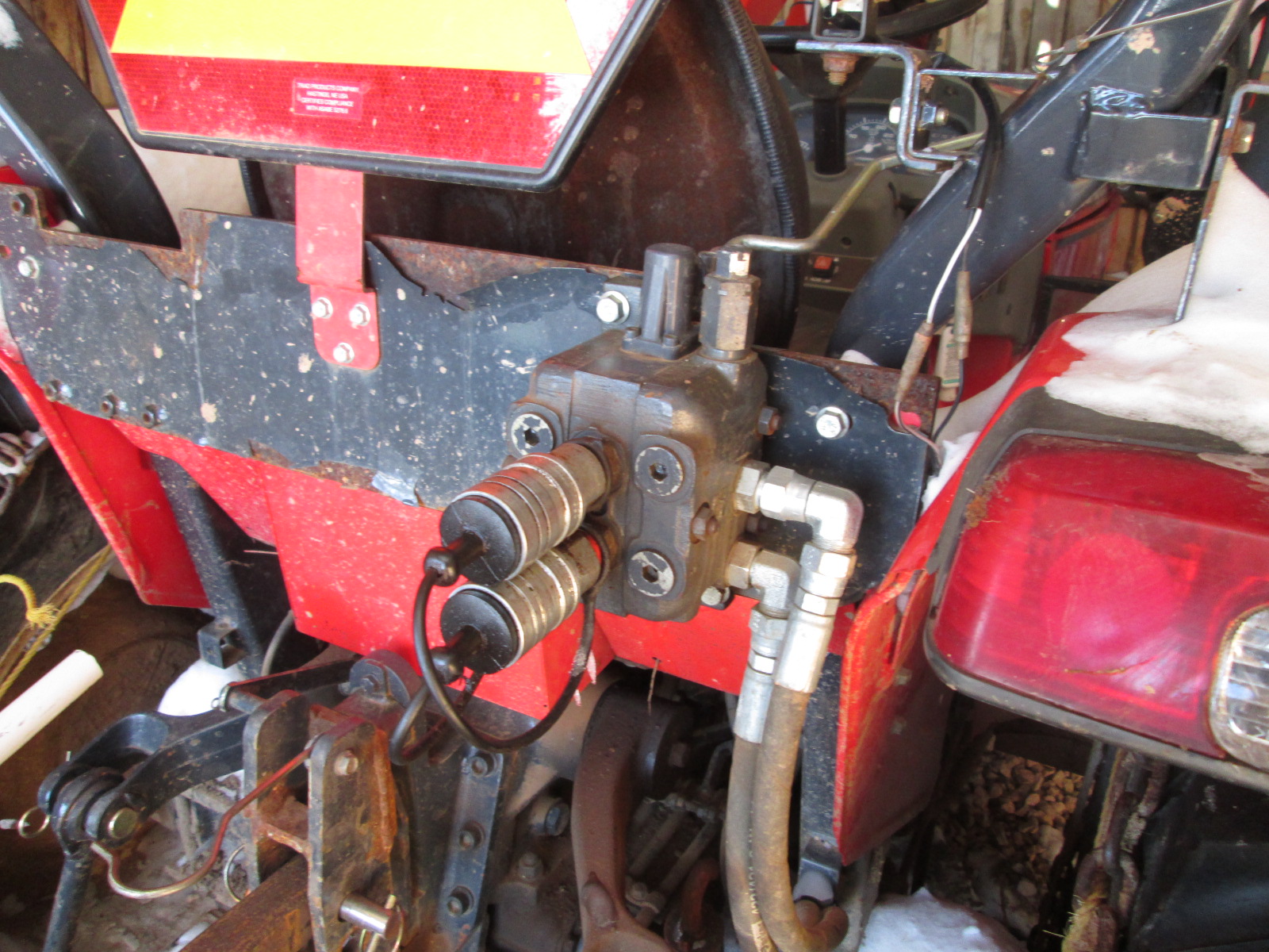

JJ your page 7 second pic is what I am trying to do.
Question with this set up see pic
when the back hoe is run off of it I assume the fluid flows back to the tank through the other hose. If this item has a relief vave will it not control the pressure in the system?

Yes, it should if set correctly.
The first valve upstream after the pump will usually set the pressure for the open center hyd system.
You can set that valve to a lower pressure if you want to.
Best to set all relief the same.

In the second illustration, he is using another hyd circuit, using the EF flow.
If the CF is at 0/off, all flow goes to excess flow. That circuit has a valve with relief for the cyl, and both the motor and valve tee into the tank line.
If you pushed the lever to full flow, the hyd motor would get all the flow and the cyl circuit none.
