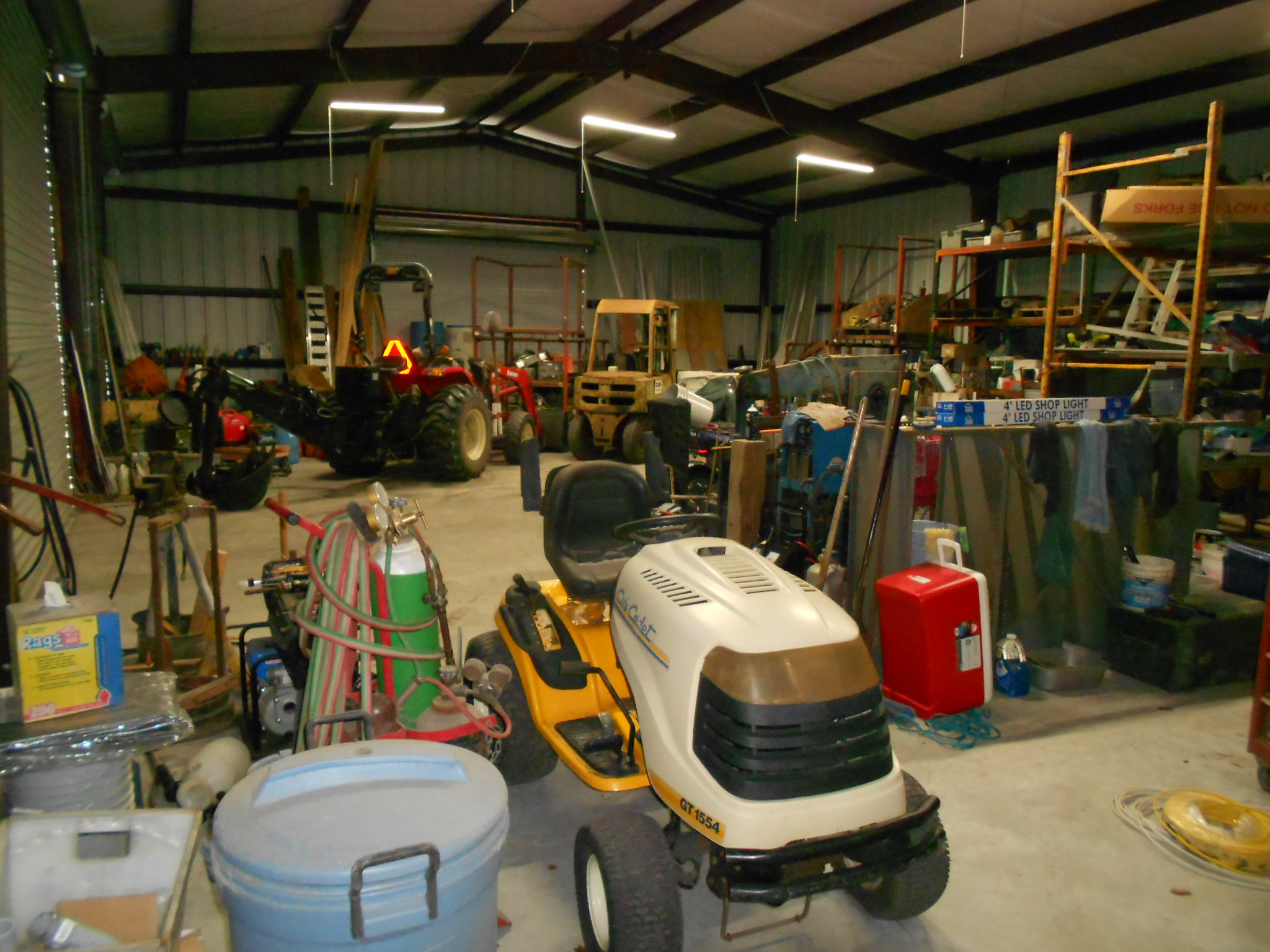

I shopped for over a year for lights to put in my 40' X 60' building and found 4' LED's at Rural King for $24.95, sometimes on sale for less.
With 6 lights it's like daylight in there and only 240 watts total!
