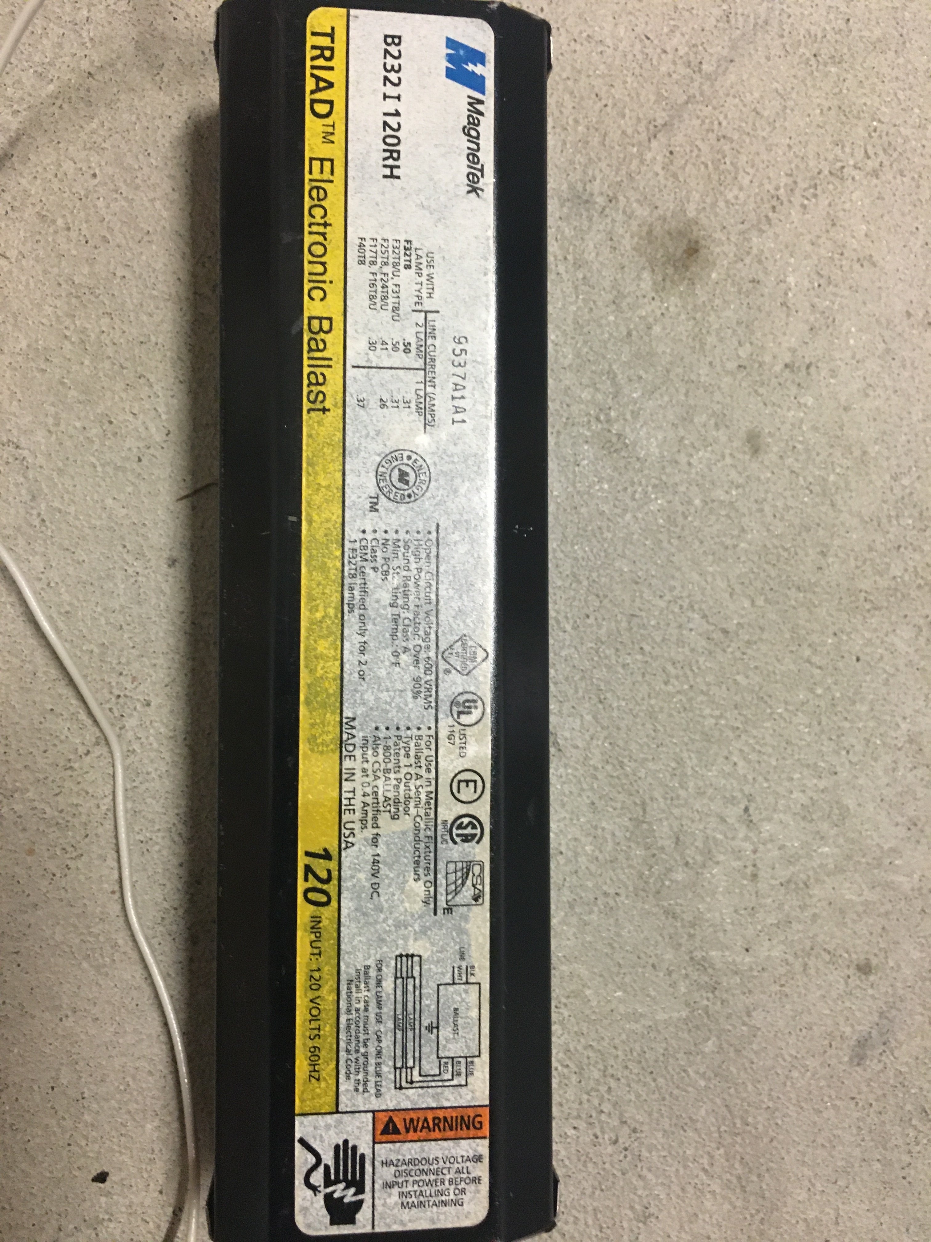

The LEDs marketed as direct replacement but I quickly learned they kill my older ballasts overnight.
Call to GE direct as we have a National GE lighting contract and learned GE has a list of several pages of compatible and non compatible ballasts which is constantly being updated…
The kicker is there appears to be a nationwide ballast shortage now…
The old standard T8 have been industry standard for 30 years… even got a lighting award in 1995 when I installed them new here…
So instead of a $2 lightbulb I am looking a $6 LED bulbs plus ballast replacement for each LED installed.
Get the led replacement lamps that dont use a ballast. Simple to install using existing lamp wiring an bypass ballast to direct one side to 120v the other side to neutral. Ive transformed thousands of fixtures like this over the years. Did 400 fixtures last year. I get it down to 10 minutes a fixture or so. I use the push in connectors to move wires and leave old ballast installed in fixture, just cut wires.
I never have to replace the tombstones. I order led lights to fit
One benifit, the lamps last a long time. I did a state of idaho building 5 years ago and replaced over 500 fixtures. Have not had a single lamp burn out . Was just there last week to repair a fixture that got hit by a forklift. The bulbs still worked afterwards.
