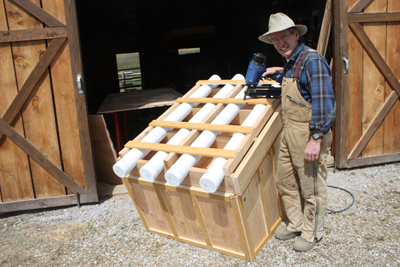

Anybody build one here? I am looking into it for my oldest daughter. Not to live in one :) but she likes ducks.
I was thinking 4" water pipes for floating grid and build on top of it, anybody has a better idea for a pontoon?

Get one or two of those Styrofoam blocks they sell for boat docks.

I like the idea of PVC pipe for the floats. Then you can use some brackets to attach the wood to them easily. Sounds like a simple and affordable project. I'm curious how high the boards should be above the water line. I'm thinking you want to keep it as dry as possible for nesting, but close enough to the water for the ducks to get onto it.

The 4" pipes I seen here:
Timber Butte Homestead サ Blog Archive サ Nancy
I could even use T pieces and elbows and make it a grid, problem with styrofoam is that it eventually soak and sink and commercial floaters are out of the budget.
/ Floating duck house #8
Fill the pipes with spray foam insulation. It will maintain floating objective if a leak should appear in the pipe. There are a number of small house boats - really small 10'x10' cabins - being built up here. They use either plastic 45 gallon drums or plastic culverts filled with spray foam insulation. The drums do not contain the foam but the bungs are oriented towards the top of the floating deck. What kind of ducks do you have?

I like your idea of using ells and tees to make a grid. If they were filled with foam, I think you would have the perfect solution.

If I make the 4" pipe grid and it leaks, it will sink without warning, separate pipes will make it unsinkable - just like Titanic :)

If you are going to use schedule 40 pvc and end caps, with purple primer and clear cement, I wouldn't worry about adding foam to the pipes. I also don't think I would go to the hassle of separate chambers. Just create a square out of four 90's and put some treated wood on top of it. Keep it Simple!!!
How often does schedule 40 fail when glued together properly under pressure? Rarely to never.
I've been thinking of the pros and cons of treated boards, like 5/4 decking with good sized spacing between them compared to a piece of treated plywood for the platform? If you have gaps, will that result in less debris on the platform?
Are you going to build a ramp that goes into the water so they can climb onto the platform?
Will you put nesting material on the platform or rely on them to bring it? Do ducks make nests or do they just flatten an area and use what's there?

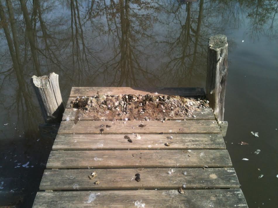

As of now, they sleep on the end of the pier - safety precaution I guess. There is already pile of guano in that spot - where I usually fish from :mad: Seems like they sleep on top of the poop, for heat maybe?

Well, here are our ducks and what they already built on the pier.
