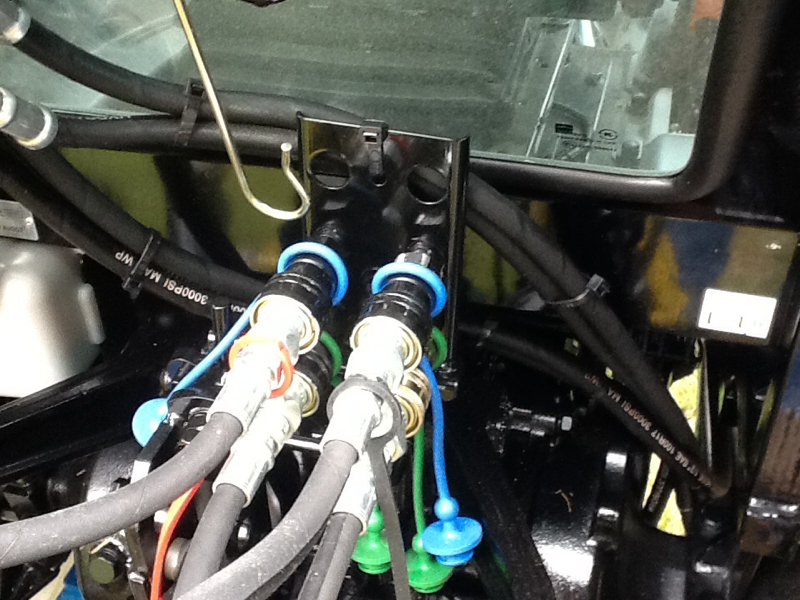

/ Flat or pioneer couplers #18
Didn't your tractor come with dust caps for the QD's? Keep the dust caps inserted when not using the QD's. If there is dust or dirt around QD's, when you want use them, use air gun around QD's before pulling the dust caps.
Sent from my iPad using TractorByNet
/ Flat or pioneer couplers #19
Yes but dirt still finds a way in somehow, especially on the loader. I try to plug the caps together when FEL is connected but they come apart and dirt gets all into the caps too.
Plus, mine is a 2011 so it's not as pretty as yours now.
