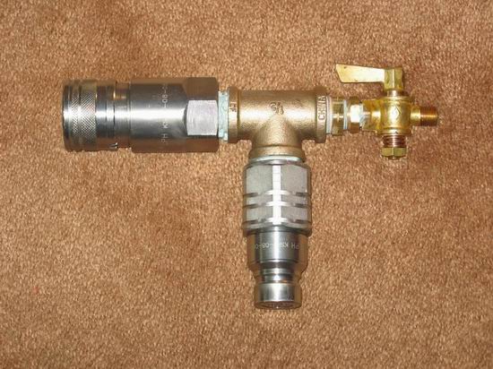

Yup been dealing with this on my backhoe. I made a valve with male and female connector on it. Open the valve and attach the implement to it...a bit of fluid spits out. Then attach to the tractor. In Europe they have a great tool for compressing these connectors together. The HOLP QUICKON. No way to buy or get one here in the States. I tried. These connectors were designed to save the world of a little drop of fluid..but, since they dont work, everyone cracks the connectors loose from the hoses or drips it out with the Waite tool and spills more then the ag connectors...so stupid

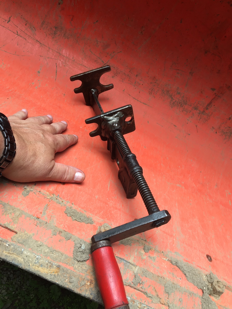

No I don’t own one. Found these on eBay today. The one I made that is similar with a screw clamp doesn’t take much force. If there is resistance felt I wiggle the tool/fittings to better align the couplers. Never have a problem or damage....yet.
One advantage of clamping VS a Waite pliers is there is no fluid loss. Disadvantage is must have room for the clamp. So far not a problem with my equipment.

When I raised this issue years ago here I got a lot of people saying "I've never had a problem, must be you". I created my own tool with a male fitting on one end of a pipe nipple, and a female on another with a T in the center open to the air to relive pressure, similar to other posts on this thread. That helps but still is not quite enough. I have used a quick grip clamp to help out also, but I never made any special ends to grab the fittings, so it is not great. And the REAL kicker: I even got "connect under pressure" fittings from Discount hydraulic fittings, and still have problems. They are a bit better than regular but i still end up fighting at least one of them on my grapple.

I made one too. It makes putting my 4:1 Bucket back on actually possible.
