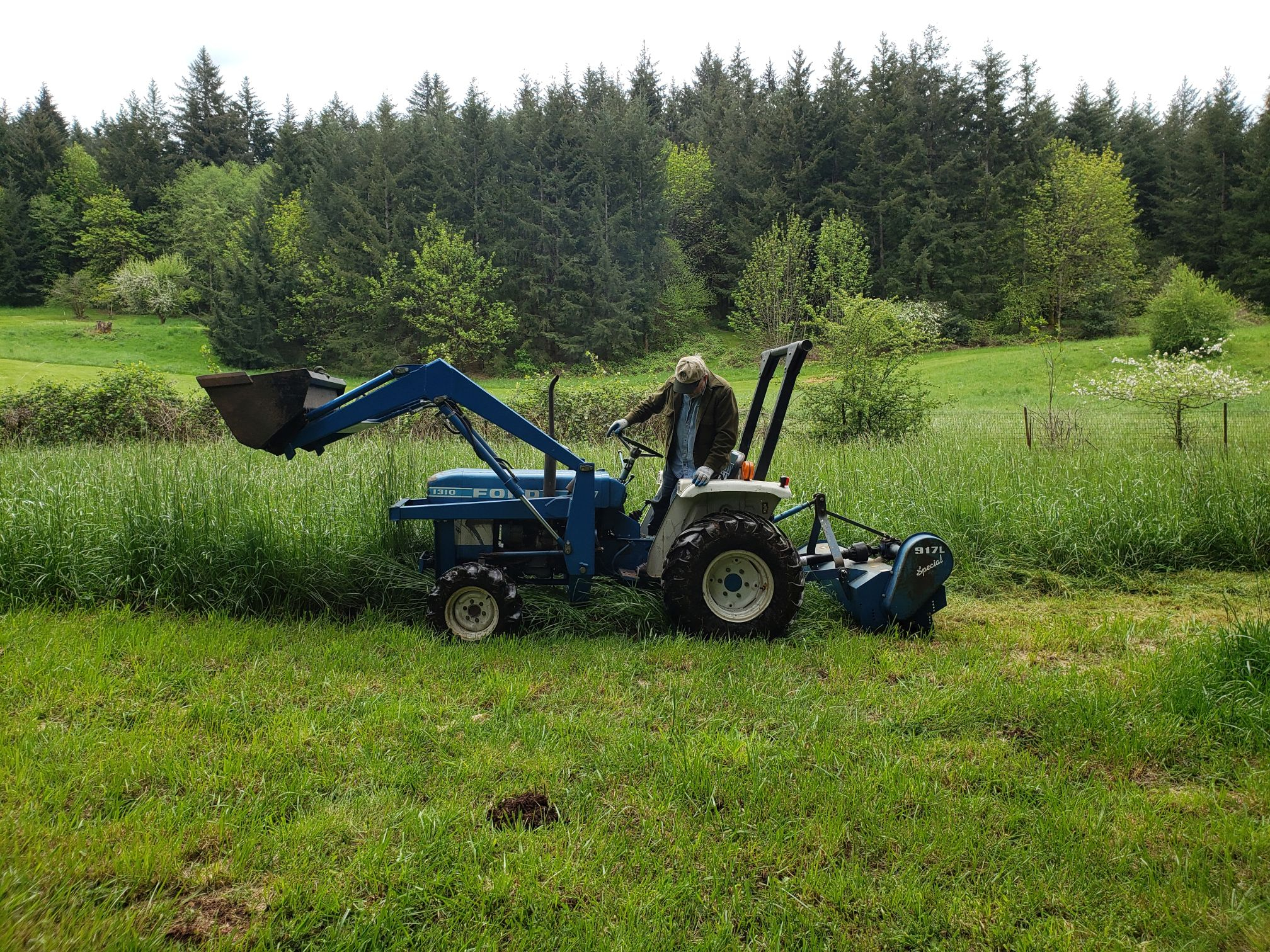

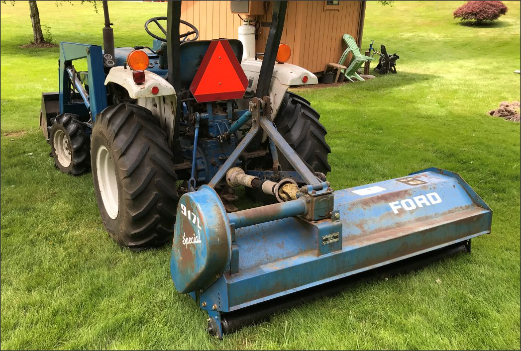

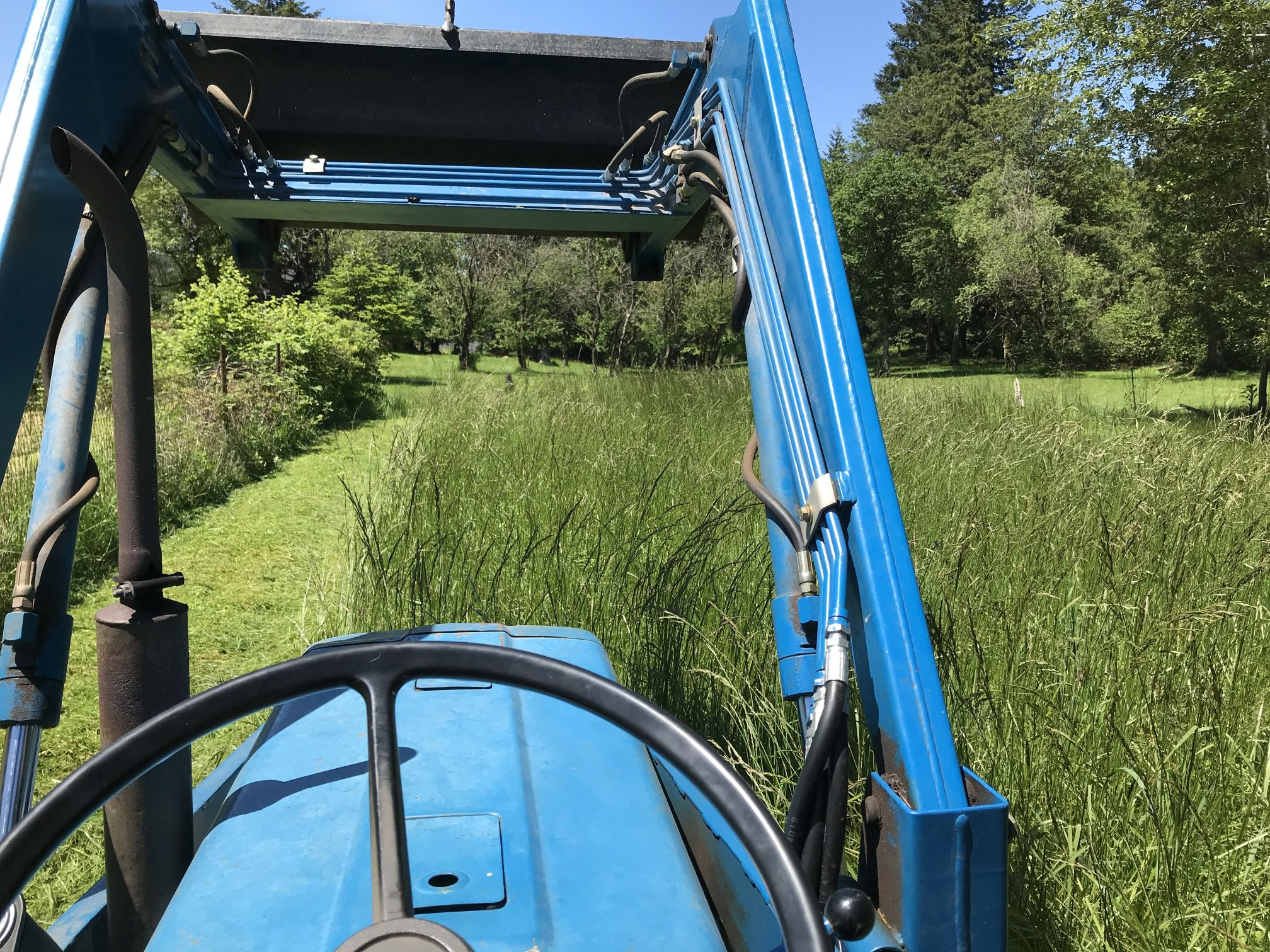

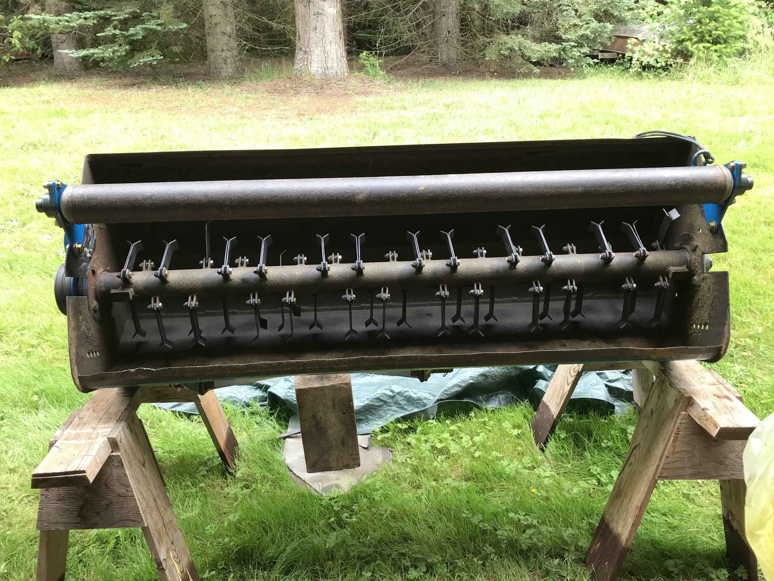

1986 Ford 1310 with 19 hp 1.0 L Diesel engine, manual transmission.
It's doing very well with a 5' Ford 917L (side slicer flails).
This mower is not designed for hammer flails, which would likely require more hp.
