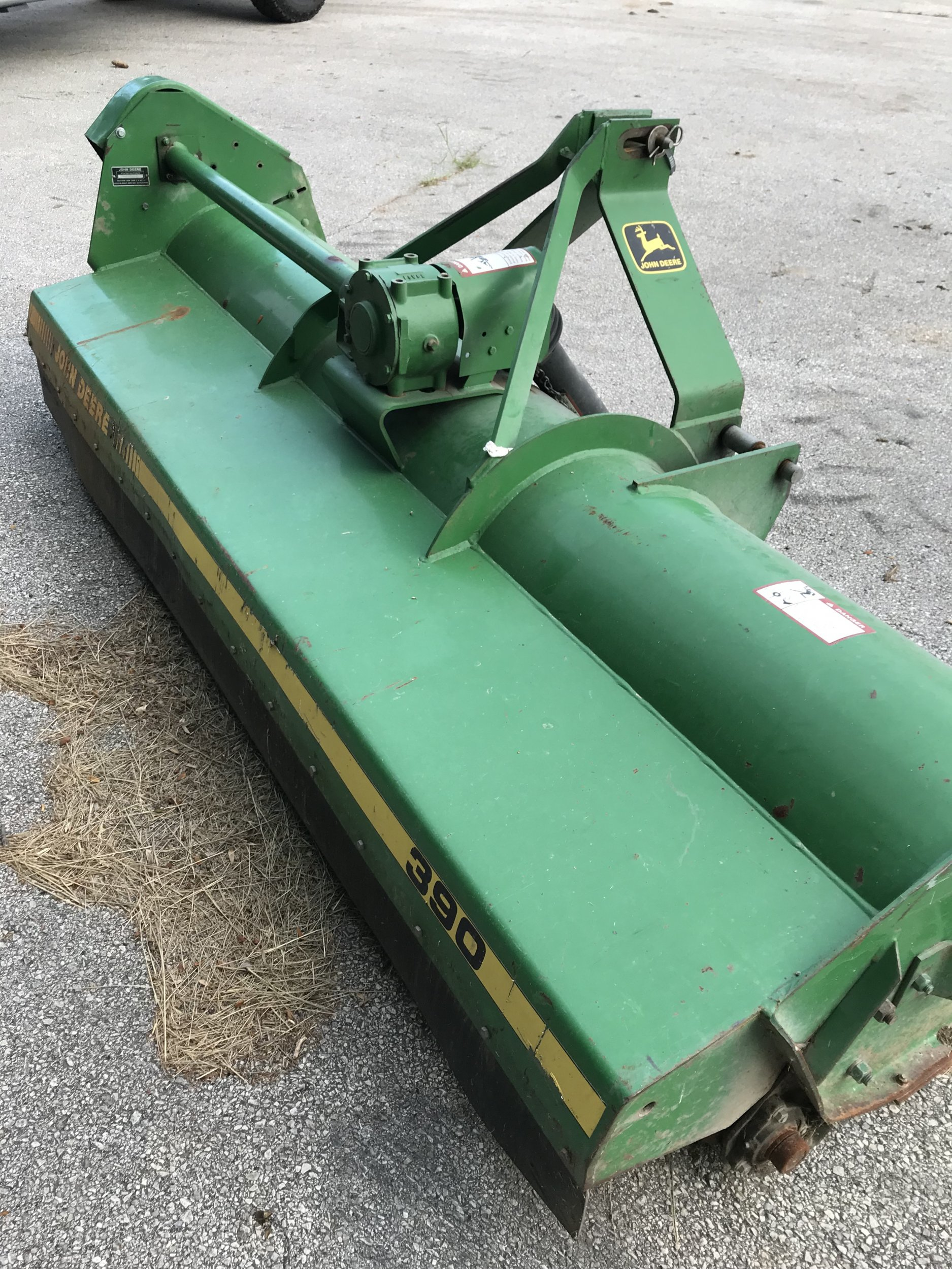

My large John Deere flail has the scoop or duck foot type blades and does a nice job mowing an open field. But make sure there is no debris and especially rock or the like.

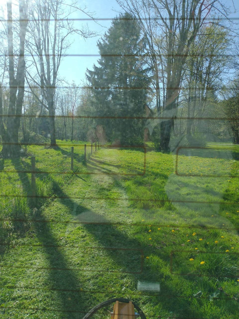

I've put my flail through enough in the first year to confidently say that I have no worries about breaking a hammer: despite all that I put it through I didn't break a single one (vendor gave me a few spares for free). Might have killed a few knives if I'd had them. I do not have really rocky land (mostly just smaller rocks- some areas have fill with larger rocks but these aren't an issue).
Hammers don't do too bad of a job on grass (this is in the homestead area, which I want to look a bit less wild; RCs and flail both produce good enough results for me; far less clumping with the flail, which I like):
Another benefit of the flail is that it's great for ballast (mine's 1,200#). Off-season I need to shuttle firewood crates to my deck.

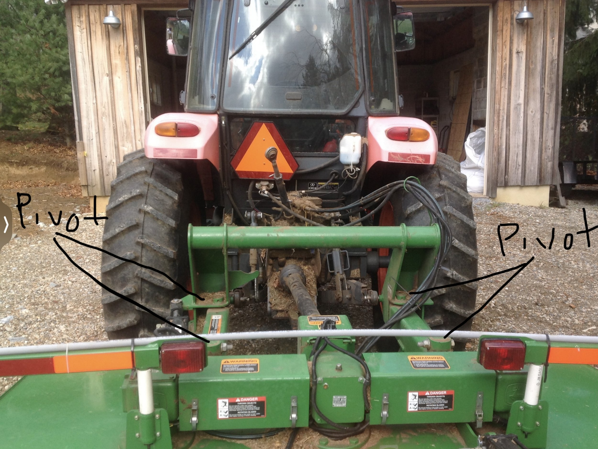

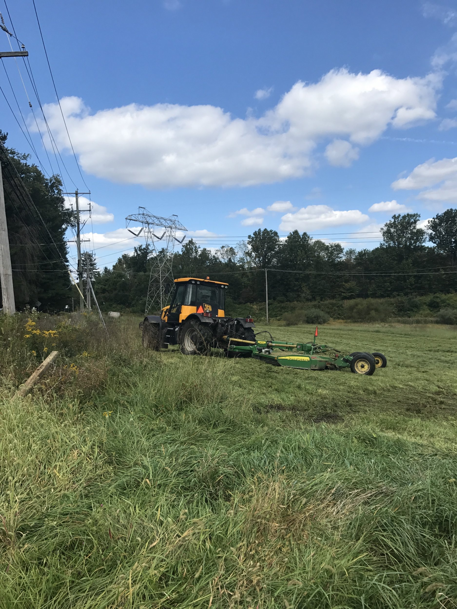

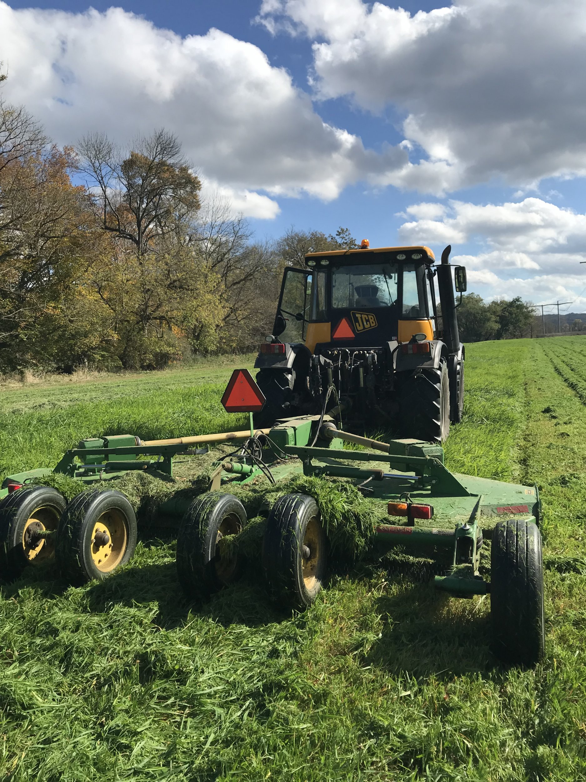

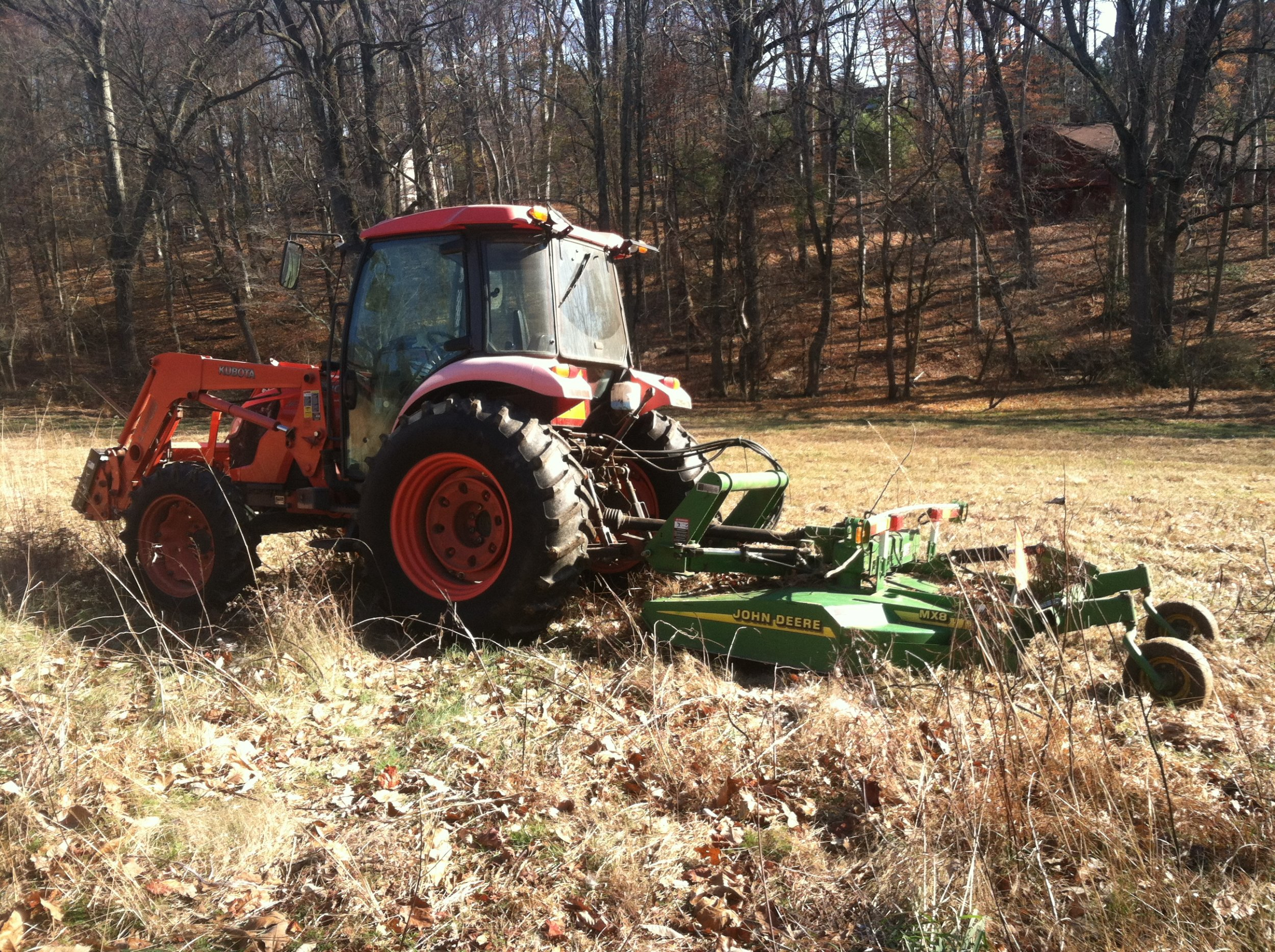

I used this on my cattle pastures under fences and it does an amazing job. It side shifts to the left or right 2 feet!
How is this adjustment done? Could you please provide a picture of it? thank you, and thanks for all the other photos you posted.
/ Flail Mowers #28
It has arms that hydraulically pivot 2’ to the left, back to center and then 2’ to the right. It is infinitely adjustable. It pulls exactly and cuts exactly like a fixed, 8 foot bush hog. Liked it a lot when I owned it, but became too small for my needs about 10 years ago.

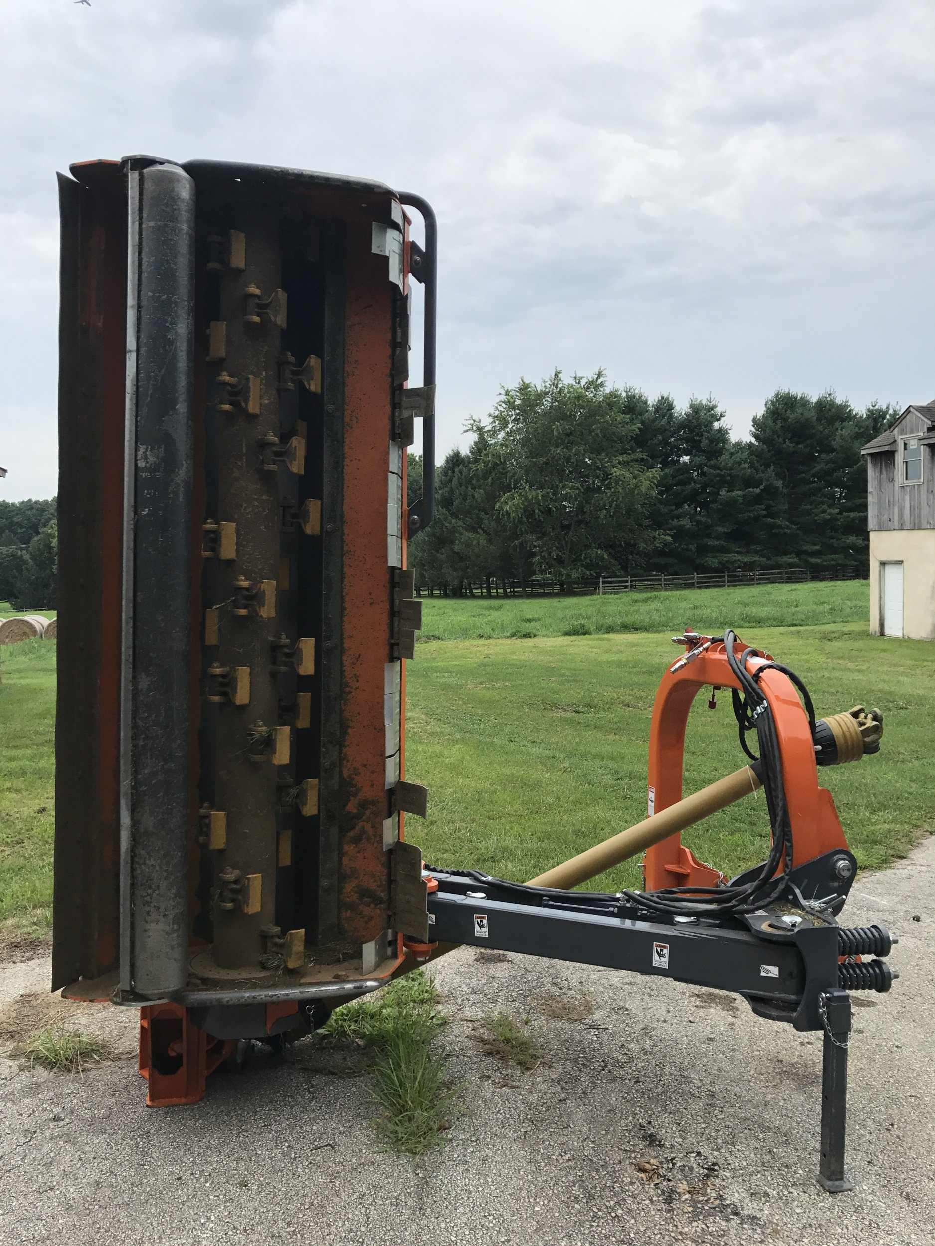

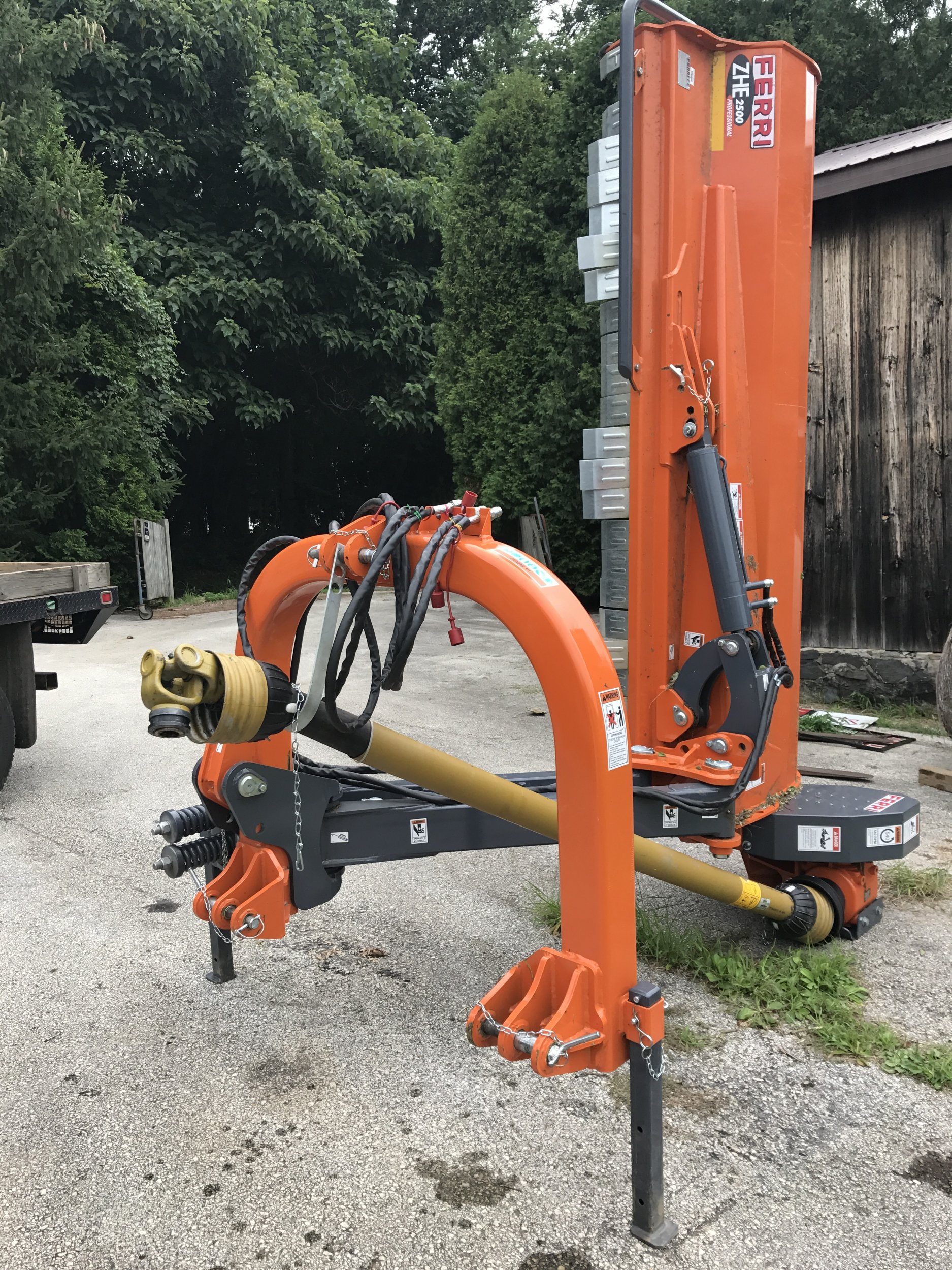

I have a 6' ditch bank flail. It is the only thing I have to cut my ditches with or some of the banks. I also use it to mow under some of my trees with low limbs.(my wife does not want cut) I still have my 5' RC and use it most of the time. I find the flail mows slower. That may be to what I am cutting.

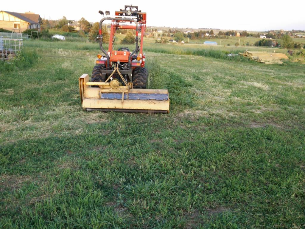

40hp L4060hstc, 1,500lbs 7.2' wide Peruzzo Brush Bull 2200 (green).
It's a bit big for my machine & I wish I had more HP. But it does the job fine, if a bit slowly in heavier grass or brush. The weight is as big of an issue as the width. If you lack HP you just do half width cuts or go slower.

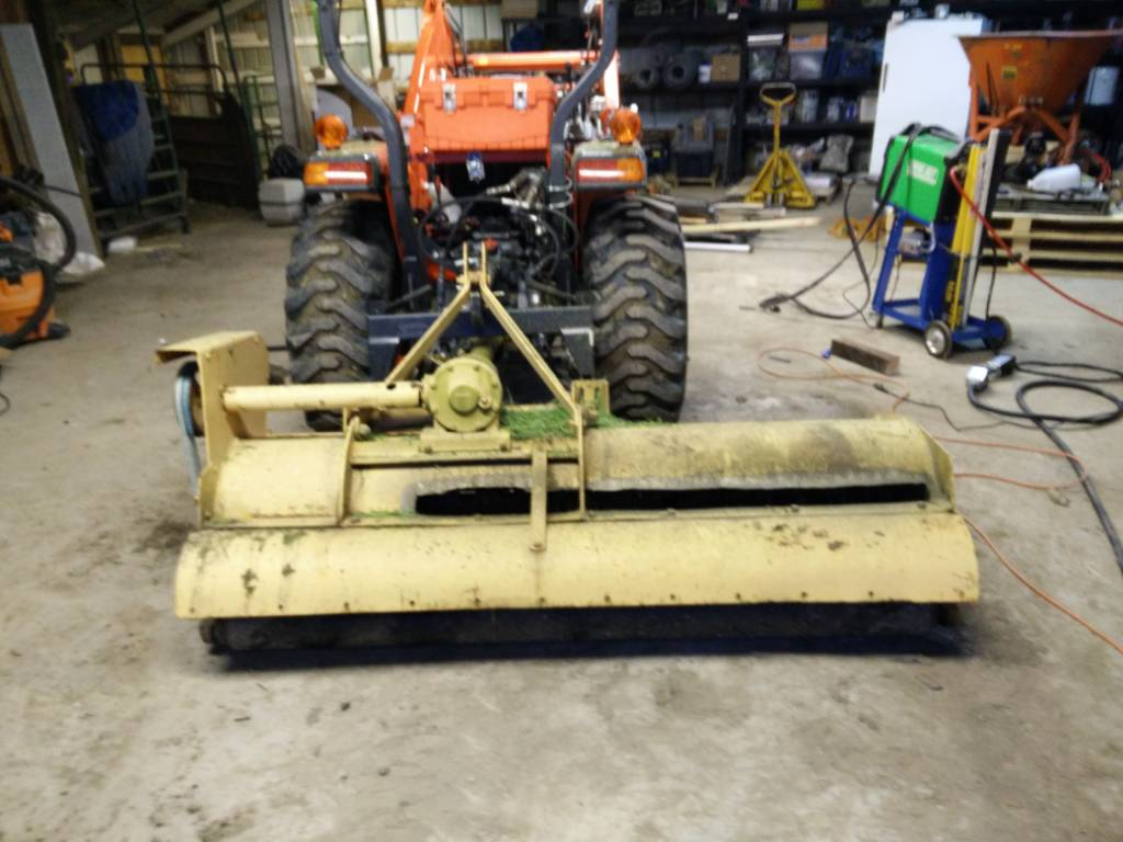

32hp on the old L3200 with a much lighter old Ford 917 (beat up yellow). Slow but got the job done as well. Better than a skinny flail & driving fast over rough ground to cover the same acres per hour.

What blades are you running on the 917?
/ Flail Mowers #32
Y side slicers. Mostly replacements from flailmaster. They cut well, but struggle with brush thicker than your fingers.
The old beat to hell (bought it for $100) 719 still works but has been parked for a few years. Replaced it with the much heavier & new Peruzzo a few years back.

Hey Fallon -- what's with the big hole cut across your yellow flail cutter? Is there a story that goes with it ?
I paid $100 for it... the back of the hood was dented pretty badly & it was missing some knives. Pretty sure they had been removed intentionally due to hitting the hood. I cut out the bad parts in back then welded a patch over the hole.
Hood is still cracked along the braces on one side & I never bothered repairing that. Roller height adjustment had been welded in place years before I got it.
Rotor bearings failed a year or 2 before I replaced the unit. Gearbox was leaky & I put pourable grease in it rather than replace the seals. Probably $500 into it total for 5 years of light commercial use. I upgraded to a MUCH more expensive & beefy Peruzzo a few years ago. The old beatup Ford flail was a great start but I've upgraded. Still keep it around as a backup.View attachment 742072
