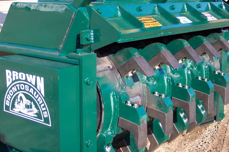

Is a Mulcher just a really big and beefy flail mower, or are there other differences?
More like a gang of stump grinders than a flail. They tend to have solid non pivoting cutting edges rather than pivoting knives or hammers like a flail mower.
   / Flail mower versus mulcher? #9

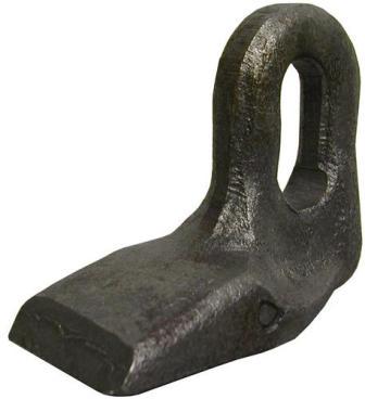

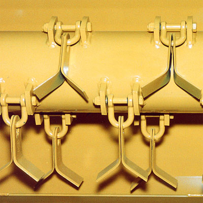

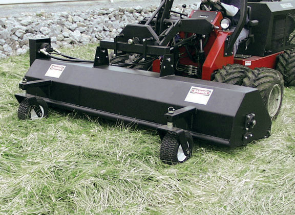

What is the difference between a flail mower and a mulcher?
First picture is a flail mower. Second picture is the blades on a flail. Third picture is the cutting/mulching head on a mulcher. Last picture is a heavy duty flail axe. It will chew up to 2 in, trees, but leaves a lot of debri left over.
A flail mower can also have a thick chunk of sharpened steel to rotate around ,and flail the he** out whatever.
