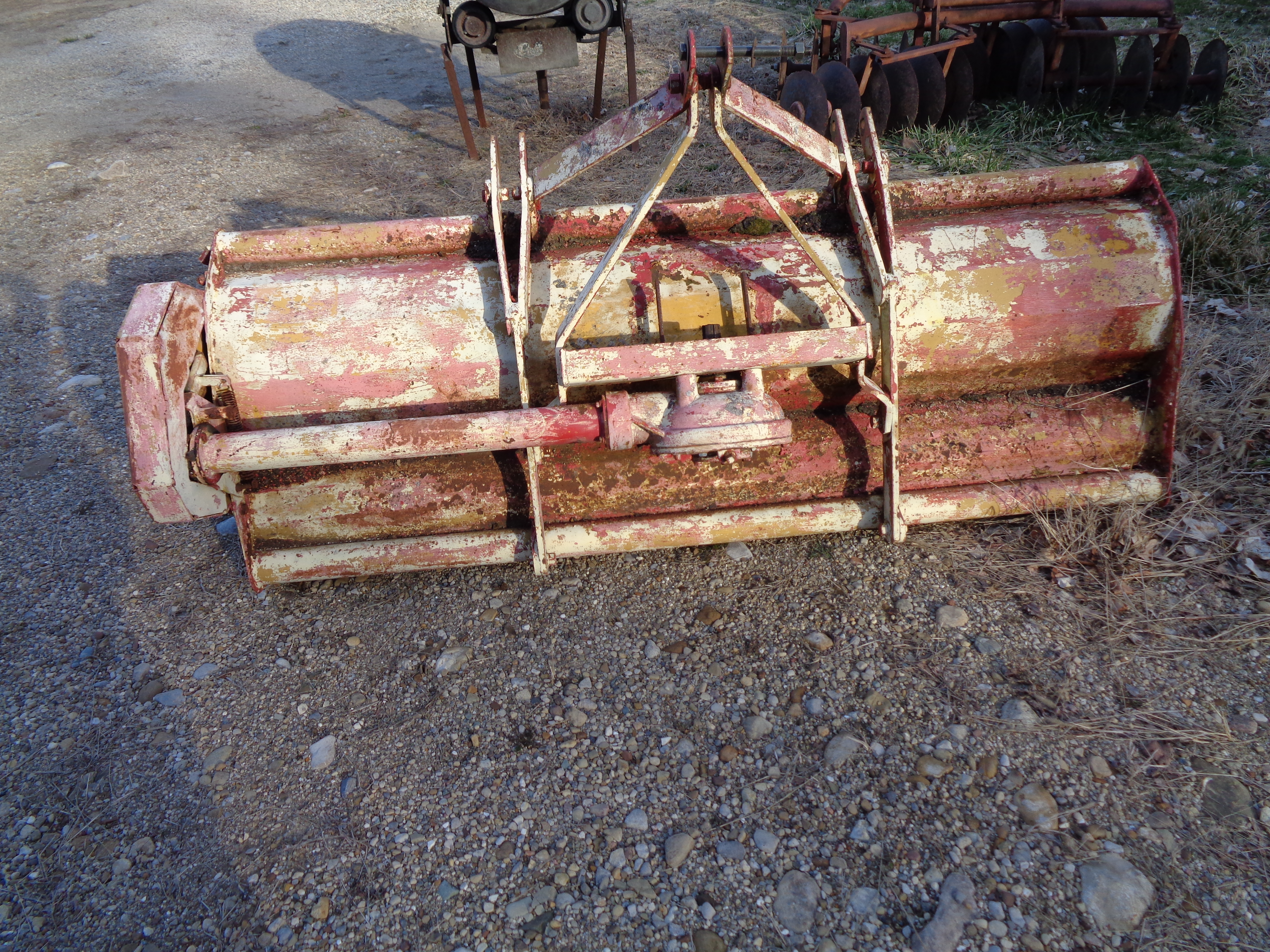

I run a 6' Mott with my little IH 240 Utility. In tall grass, I have to go in first gear, but when clipping the Chickory, and Iron weeds, etc in the pasture, I mow in 2nd with no problem. I'm getting to the age, where most times, second gear is about all my ole' back can take anymore. I love the fact that it doesn't "throw" things, like my rotary cutter, and with the forward rotation, picks up, and cuts the grass/weeds the tractor tires mash down.
I bought mine this Spring off a buddy for $300, who buys & resells used equipment. I did have to buy a new PTO shaft, as the original was not with it. I'm thinking I got a new one through Agri-Supply for $139.00. It's not real pretty from apparently setting outside most of it's life, but mows great..!!

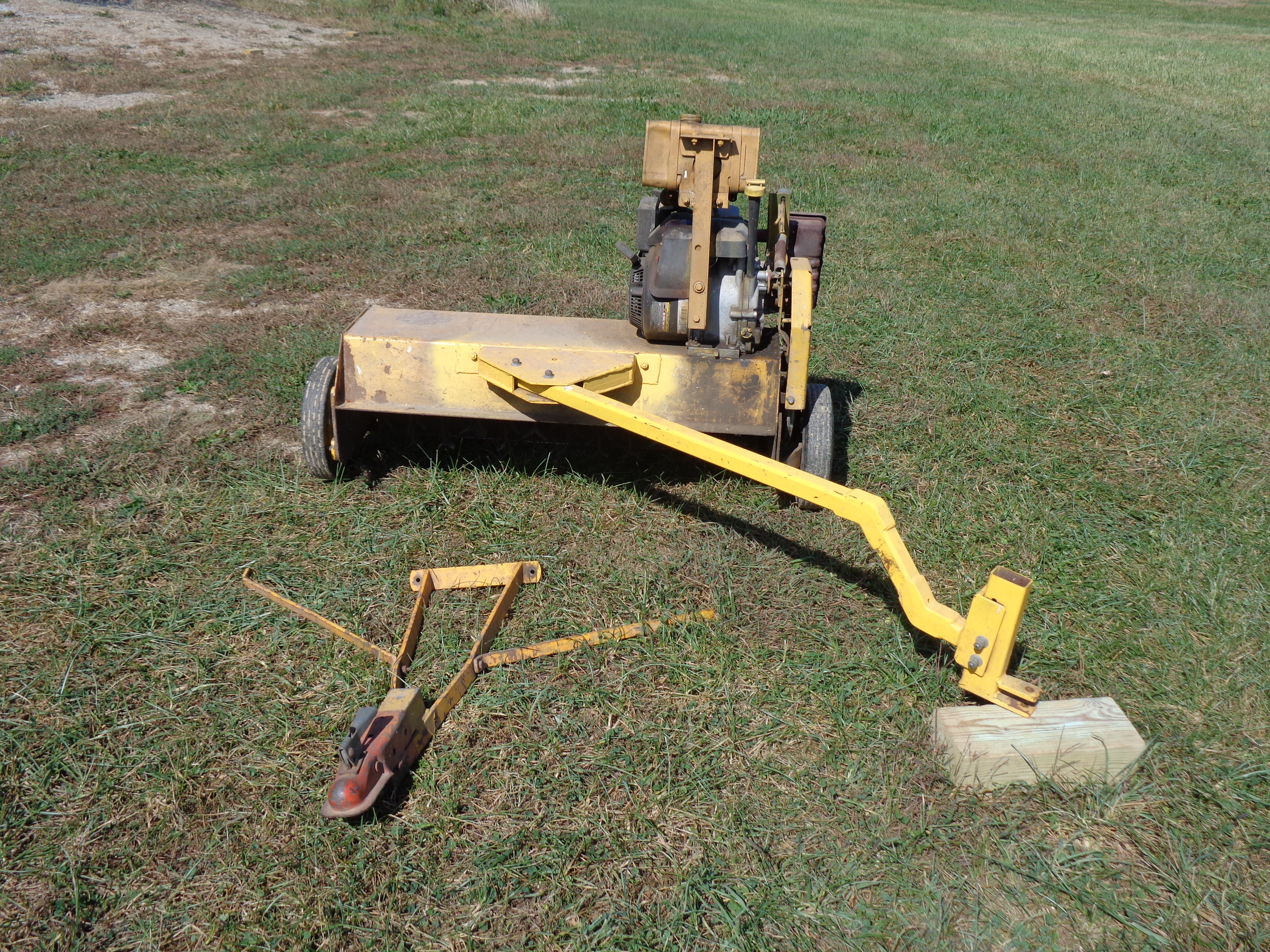

Last week, I posted my little Mott T38 pull type hammer knife mower on FaceBook Marketplace. I bought it 2 years ago, and used it to mow around the hayfield, next to the fence to barber things up for winter, and also clipped one of the small horse pastures, of Chickory, and other stemmy weeds the horses won't eat. It did a great job, and the main reason I went with the 3 pt. model. I built the offset tongue, so as to not run over tall weeds & grass, and briars. I built it using the original attaching points, and also kept the original tongue, if someday if I decided to sell it, the new owner could use what they want. It started, ran, and cut great, but with the 3 pt. model, really didn't have that much use for it, plus freed up some storage space.
I had 8 responses to the ad, within 4 hours. First guy that came to look, loaded it up, and took it home. He said it is intended to mow walking trails he built on his property, and was exactly what he was looking for.
